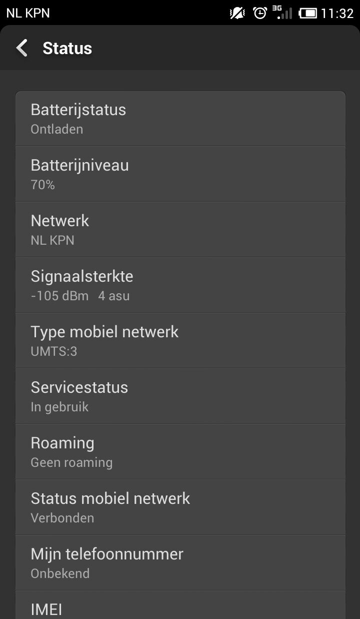

Can we test the gsm signal?
Verstuurd van mijn MI 2 met Tapatalk
This is my phone...
I tried again now.
For a minute the reception was full, like in my xperia T, but I couldn't call or get called.The Network Type says" UNKNOWN:0"
Then after a minute again: " Emergency calls only"
No reception.

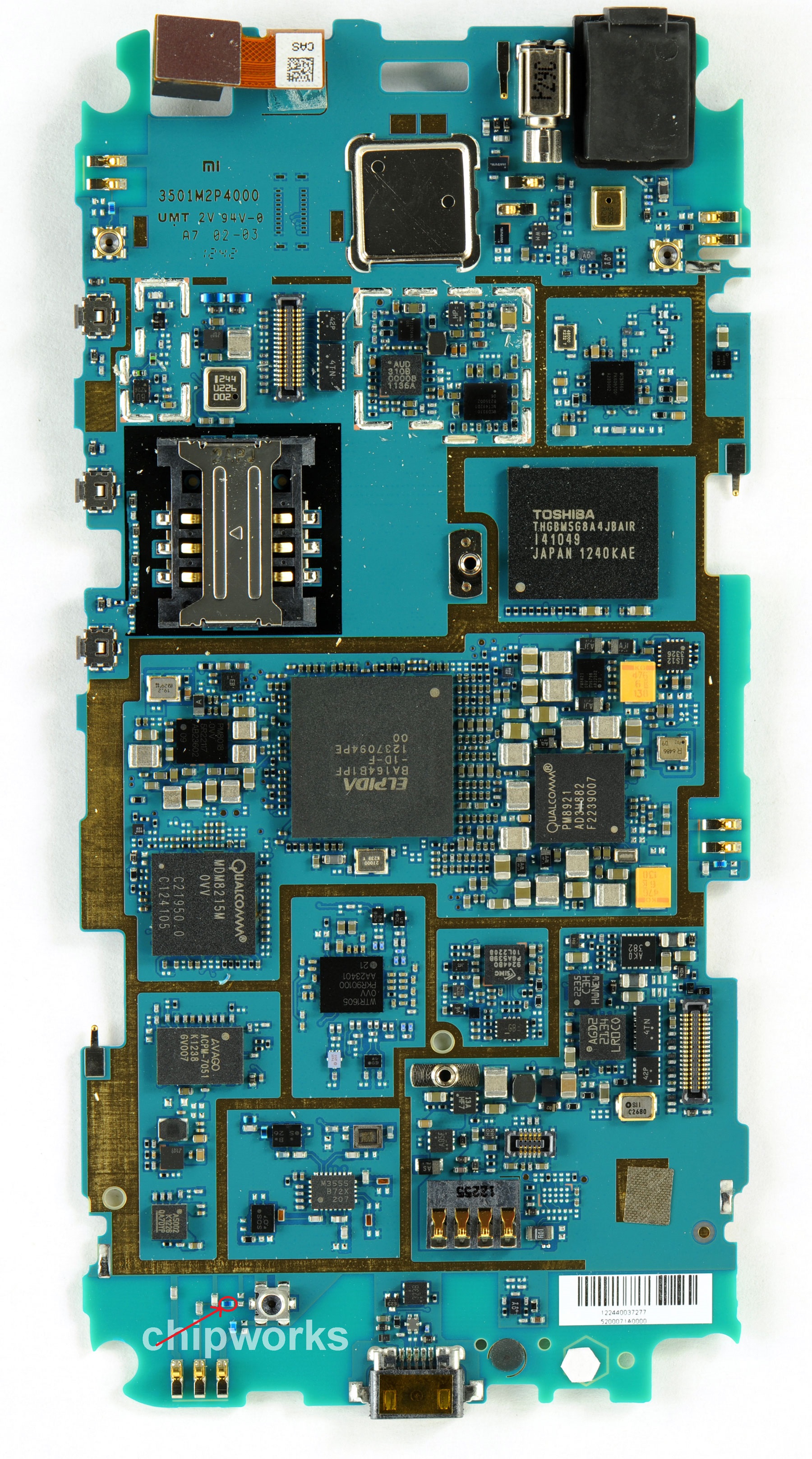

Thanks everyone, I send it to reparation (in my country) and actually a resistor is missing and that the cause of the cellular reception lost..
The problem is that it's difficult to find exactly the same resistor and if it's not the same it will not work or it will work but the phone will be buggy :(.
I hopefully waiting the phone will be repair, otherwise I will be forced to send it to china to Xiaomi.
Finally, he didn't succeed to repair even if he put a new resistor.
Because it's not the same, it doesn't work :(
You can see in the picture, (from the internet I found) I upload, at the bottom the resistor he changed.
Maybe this will be helpful for someone in the future...
Here the pic:
