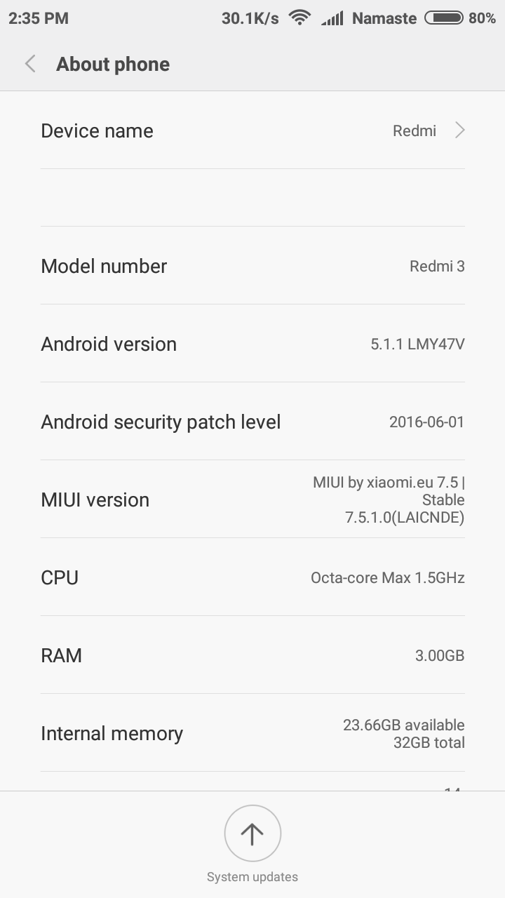

-i recently got redmi 3 pro silver cover.
-figure out some problem/bug, that its touch lags while charging.( it had miui 7 v7.2.1). touch becomes very laggy while charging. i have to try number of times to unlock my lock pattern. While scroling, randomly apps open. keypad needs to be pressed really hard to type.
-at first i thoght its because of charger and used samsung, and lg charger but the problem was same.
-i thought its because of rom, so flashed china stable rom( v7.5.1) and still the problem was same.
-i reported to the xiaomi care and service centre here in my country.
-they inspected the phone and replaced my phone with another golden colour. But the problem is still the same.
-i unlocked my bootloader and installed custom recovery. i installed european version(from xiaomi.eu) rom v7.5.1 and still the problem is same.
-i tried cleaning my cache/delvik cache in recovery to see if that could help, but nothing,

yes i did. i cleaned cache/delvik cache and no changes with it. I even posted about it on forum.xda. They are saying that its a setting that is made intentionally on cpu to reduce overheating of device, known as cpu throtttling. i couldnt post the link now. see my post on forum.xda
