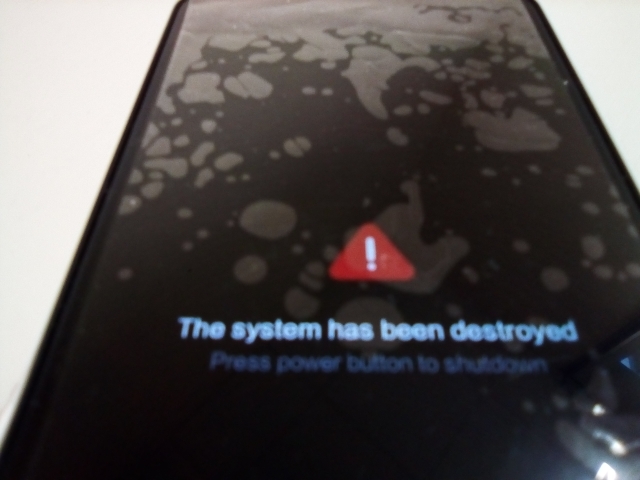

I was going to install the Android 10 in my Redmi k20 pro, but when I was flashing it with MiFlash I selected "clean all and lock".
Now I have "The system has been destroyed error".

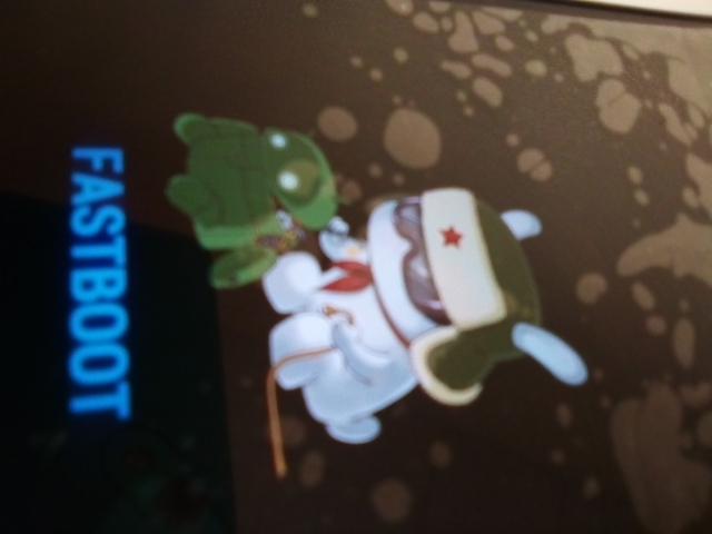

So I was going to unlock the device with MiUnlock ( after breaking py phone ) but it tells me "your mi id is not associated with a phone number", and I can not do it because I can not turn on the phone "Error: the system has been destroyed"
If I try to unlock it with fastboot I get "Token Verify failed"
I can't also install TWRP recovery, case the bootloader is locked.
I tried to flash it with the offcial ROM ( China, EU ), but the problem persists.
How should I procced ? Thanks

Is bricked, search on xda to see the method to unbrick.
Its costs and you have to open your phone.
Sorry
Try this. Remove your sim from your phone and insert it to another one (to associate with your mi account), use your pc (or rent if you don't have) , open account.xiaomi.com, edit and enter your number there (fill-up everything there). Now unlock your bootloader. After unlocking your boot loader, download miui fastboot rom, install it using miflashtool. If it works, good for you..
