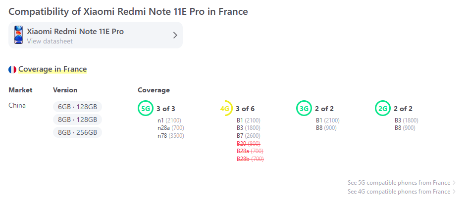

My parents just bought 2 new Redmi Note 11e Pro 5G from a French online retailer. I have set one phone up but it will not recognise the local 4G network nor will it connect to it. Our cellular provider is SFR. It will also not download a large update of 3.2GB update number 13.0.7.0.SKCMIXM Stable. No matter whether I connect to our WiFi or via my personal hotspot, it keeps pausing and failing.
Does anyone have a suggestion or fix for this issue as I am very frustrated with it. My own devices under a different brand have no issues connecting to the network. Thank you in advance
If you have a Redmi Note 11E Pro, you bought a Chinese model without B20 LTE band support.
