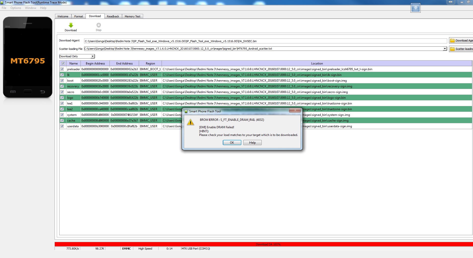

As you can see from the attached, the error I keep getting is the 4032. I've tried flashing different ROM's, using different versions of SP flash tool (tried 1516, 1532 and 1548) but the error I keep getting is the same. From the screenshot I am trying 'Download Only', but I've also tried 'Firmware Upgrade' and 'Format All + Download'.
I've tried on 2 different computers - both running Win7. I've installed the drivers many times (from various different zip/exe files), by following the uninstall through USBDeview and reinstalling (also tried adding legacy hardware on Device Manager). My PC recognises the phone as a MTK USB Port (and not as Preloader USB VCOM or DA USB as I've seen in other situations - could this be the issue?)
Once plugged to USB, if I don't do anything it automatically connects and disconnects, non-stop (keep hearing the connect/disconnect sound on Windows).
Let me know if you have any ideas for this!

Thank you so much for your feedback, I have tried both methods you guys posted but unfortunately they didnt work
So once again I keep having problems with trying to flash the phone as I keep getting ENABLE DRAM FAILED. Yesterday I was looking closely at my Device Manager in Windows 7 and only once in a while would I get under the Com Drivers DA USB VCOM Port showing up (Only in Device Manager)
So then I started looking at SPFlash Tools and I used Version 1516, 1520 and 1532
But as you can see in the picture below
http://imgur.com/KaDIqVp
In the bottom right corner I only having showing up MTK USB Port no matter what I do, and even when under device manager in windows DA USB VCOM Port would show, i would still get the same error.
I have read and seen that for the flashing to work in the bottom right it has to say DA USB VCOM Port

as i write before the problem is the different rom installed. You'll never be successful if you don't find the right version 7.00.11.00 in fastboot version
