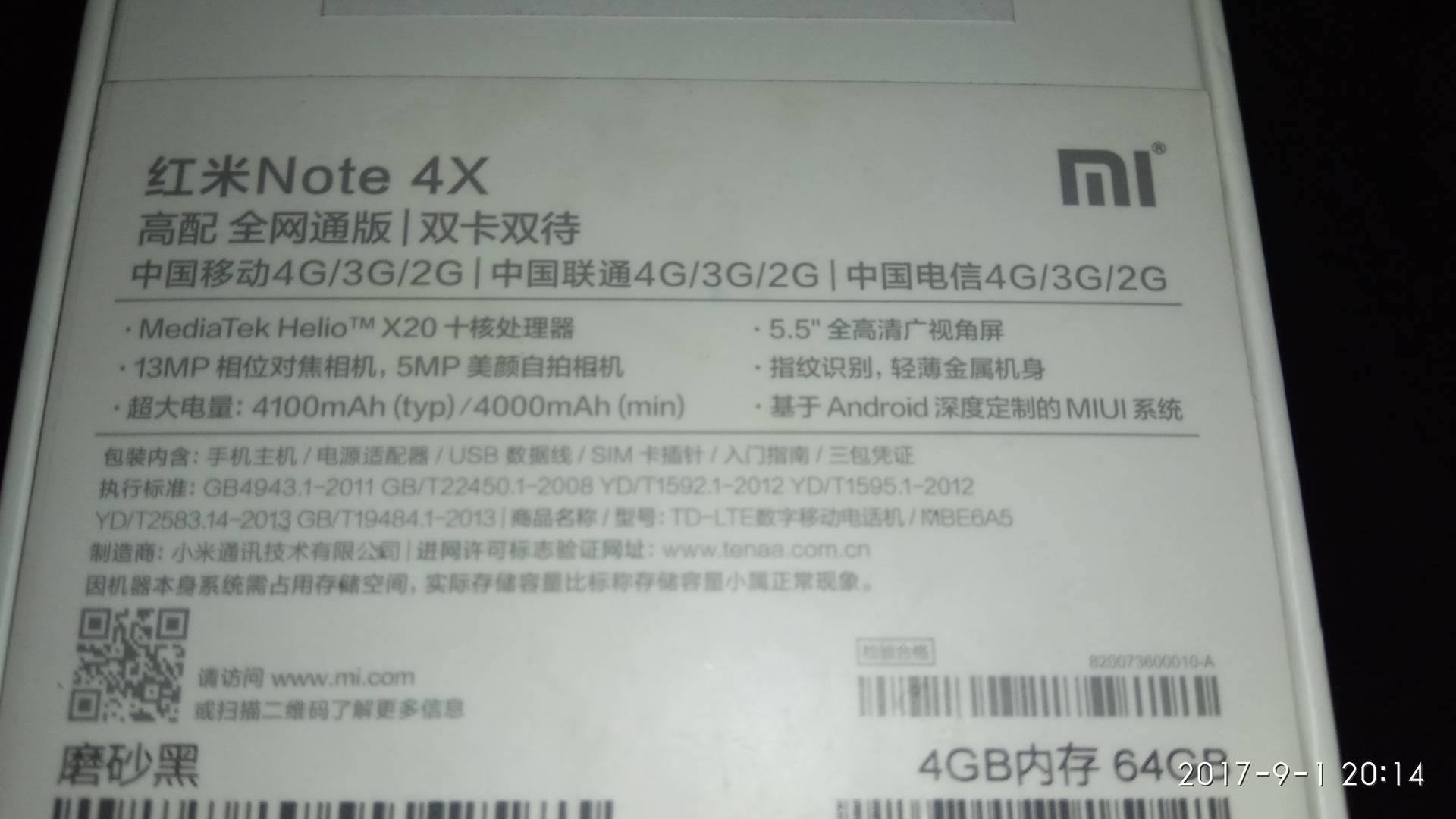

It is not a scam by resellers. In my opinion it is Xiaomi's fault for poor naming method.
There is Redmi Note 4X with MTK cpu and it's 4GB ram 64GB rom version. MBFCNDL <- in stable rom marking those BF letters is for MTK (Nikel) and if it's CF its the Snapdragon (Mido) version.
But I'm saying that I can't find any instance where Xiaomi themselves refer to MTK as 4x - only resellers are doing it. Where is Xiaomi doing it?
If you mean in the ROM's, this is resellers customizing them. Official MIUI has only two versions - one for nikel marked as Note 4 and one for mido marked as Note 4x.

Official link to the rom:
http://bigota.d.miui.com/V8.2.2.0.MBFCNDL/miui_HMNote4_V8.2.2.0.MBFCNDL_ea8c6a2518_6.0.zip
There you have it.
You can find it in rom downloads and device Redmi Note 4X -> rom is Redmi Note 4X China (4GB+64GB)
Afcourse there is Redmi Note 4x MTK Helio X20 4GB RAM and 64GB storage and you CANT install MIDO on it (PROFIT).
I downloaded my first rom from here and i choose wrong MIDO rom because of that XIAOMI misleading device names but
had luck that i got ERROR 7 with TWRP incompatible device. Then i downloaded HMNote4 nikel and it worked directly.

Guys, chill out. Download AIDA64 from playstore and check out, if you have mtk or sd chipset with 4gb ram. But ALL MTK are NIKEL and SD are MIDO. It's codename for used chipset. So if you have MTK, mido rom won't work.

Wow, I guess Xiaomi really did drop the ball on this one. I stand corrected.
Confusing as heck!
