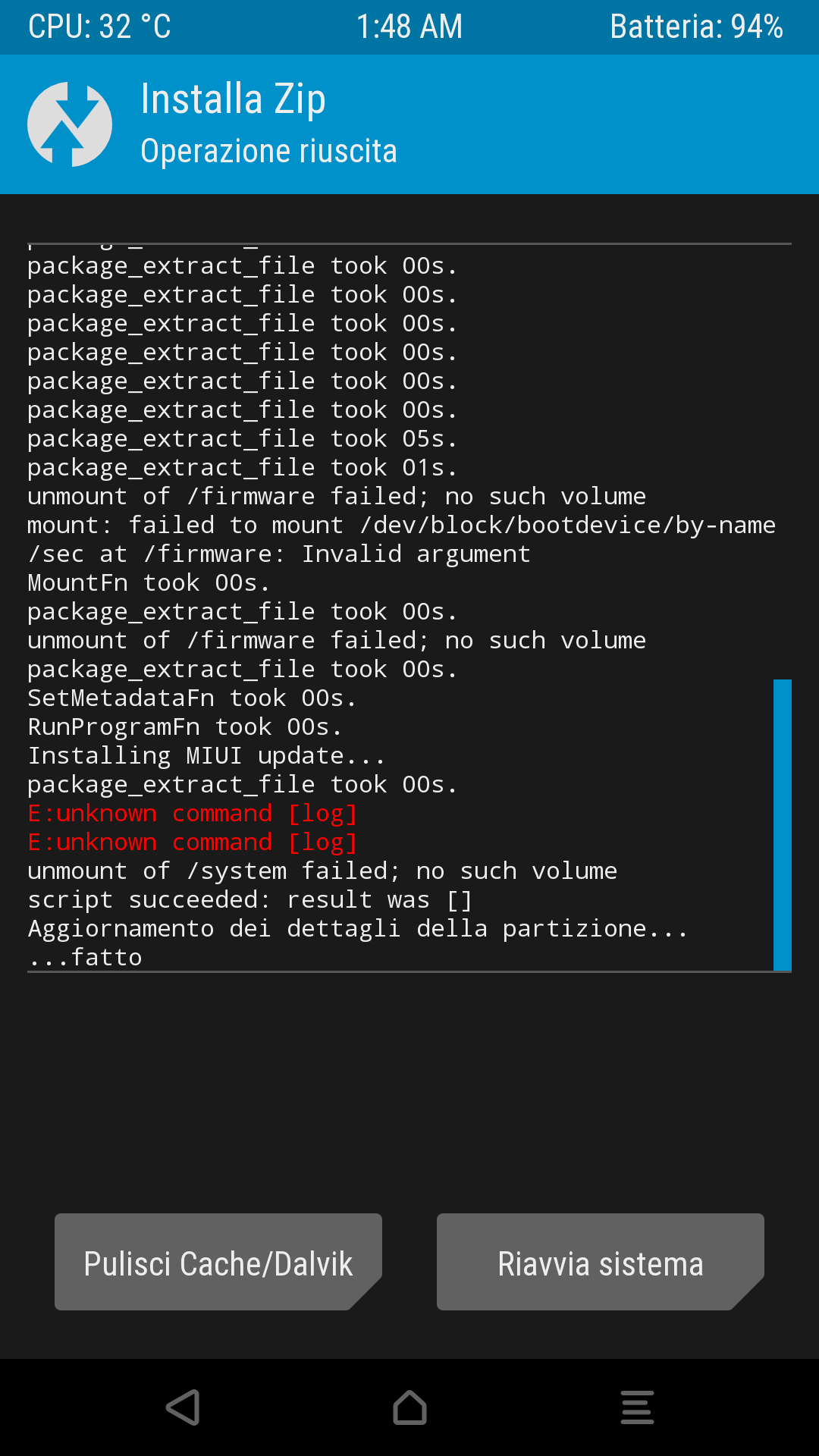

Good morning, I wanted to have, if possible, clarifications and advice on the installation of Roms Xiaomi and on redmi note 4 global version.
As soon as I received the device, I unlocked it (all OK) and performed the installation of the TWRP, according to procedures (all OK).
At the time of the installation of the Xiaomi ROM, however, it gives me messages that make me perplexed and I have never had with the previous device (redmi note 2).
Specifically, messages of the type:
"Unmount of / firmware failed; no such volume "
"Mount: failed to mount / dev / block / bootdevice / by-name / sec at /firmware: Invalid argument"
In addition to an indication in red: "E: unknown command [log]"
Additionally, it takes much less time than the other device and, when rebooting, no longer appears on screen the white bar that indicates the system updating, but it reboots almost immediately, almost as it has been switched on normally.
In sum, it seems like the installation is only partially done.
So I wanted to ask if this could be due:
- to some my procedural mistake;
- to some my twrp setting error;
- if there is a remedy;
hereby the screenshot of messages
Thanks so much
Rodolfo

I also get the same error when using the TWRP, even the latest version 3.2.1.
Thus, the modem is not updated.
So, I need always to extract it from the ROM file and then flash it manually, separately.
Can it be fixed, please?
