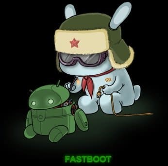

To avoid writing a uselessly giant post, I'll skip all the basic procedure, directly going on how to solve this problem. After all, we are trying to flash a new recovery with fastboot, so it's supposed you are able to install adb, your phone's drivers and such. If those steps are not clear, just tell me and I'll edit this post including them (sadly tested on a Windows system, but the commands to put in the terminal should be the same on Linux).
With USB debugging turned on and your phone connected to your pc, give this command in the command prompt (cmd.exe):
Code:adb reboot bootloader
To enter fastboot. Alternatively, with your phone turned off, hold power and volume down button. You'll see MiBunny operating on the green Android bot and "Fastboot"written below. Then, hit
Code:fastboot devices
To check connection works. You should see an hexadecimanl string indicating your phone and "fastboot" written beside it. Then give this two commands: the first one will unlock the bootloader, allowing us o boot the recovery we install with the second one.
Code:fastboot oem unlock fastboot flash recovery %path and name of your recovery%
Voilà. Turn your phone off, hold power and volume up and your brand new recovery should boot.
