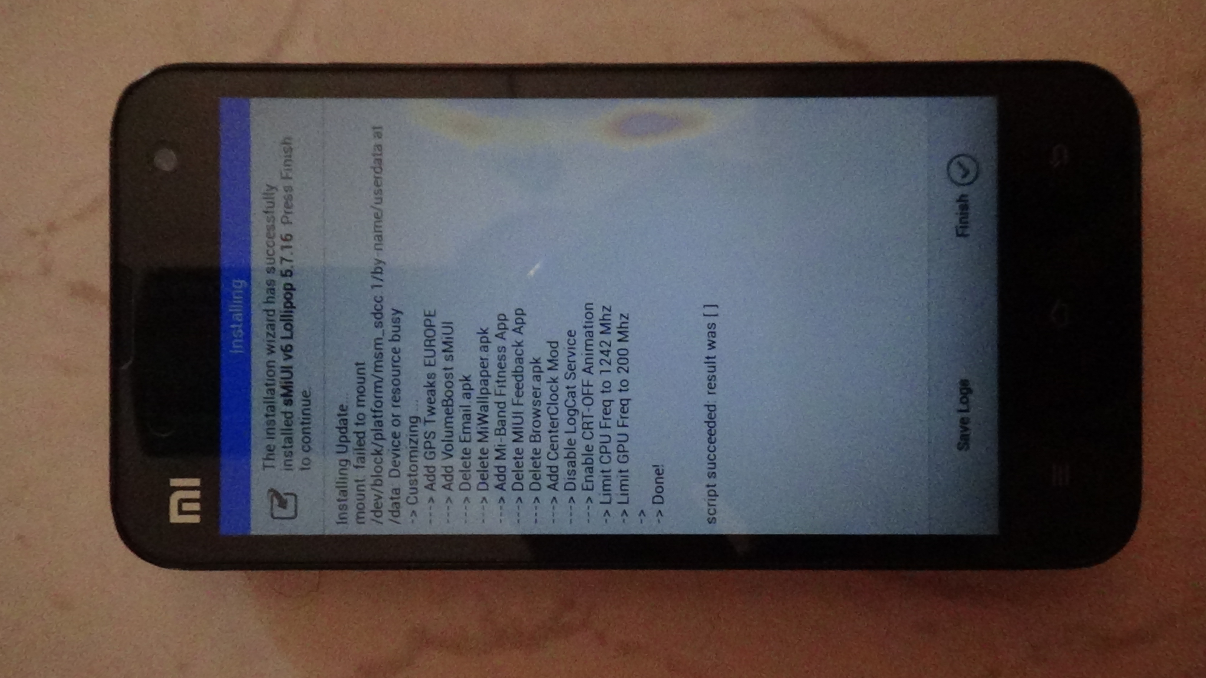

And there is the 1m dollar question. I flash with TWRP the AROMA version, and the phone stucked at the first 4 lines. Then i search for another camera to upload this, asking for help. When suddenly after 4-5 minutes ... voila... it starts again!! Hours before i tried to install with the same TWRP the FlymeOS and (i don't remember exactly) it says that E: failed to mount or sth like this.. (and there is the 1m dollar question) So i am asking this, if i wait and wait such as now (with this flash/update) will it works? Is this a problem that sth is busy and I have to wait? Or FlymeOS L was a different situation? I am asking too much but i hope your experience could help... Thanks in advance
In my Mi2s too happens the same thing.. "Device or resource busy", and after some minutes the installation starts.. But I noticed that if in Aroma I select "quad core no limits of clock", 2 of the 4 cores are in any case stopped and can't be activated and there is no limit of clock. Why the 2 cores are stopped if I select quadcore?
Is the phone in performance mode?
You need to switch to performance mode. I think seb made this clear. I read a note about this. As for my issue i will test it and i confirm this
