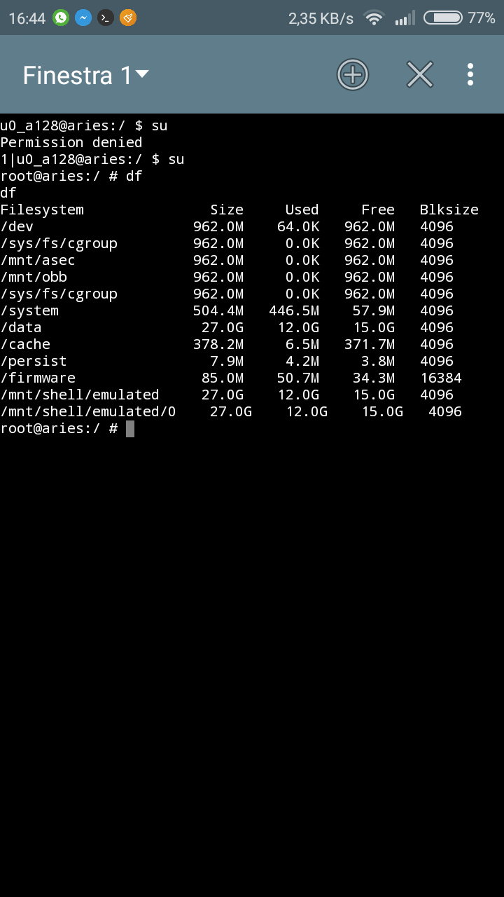

Just to be sure, everyone with dual boot have to full wipe?
Does this partition table shows already merged partitions or not? (I have installed fastboot ages ago with merged partitions and for these I have TWRP)

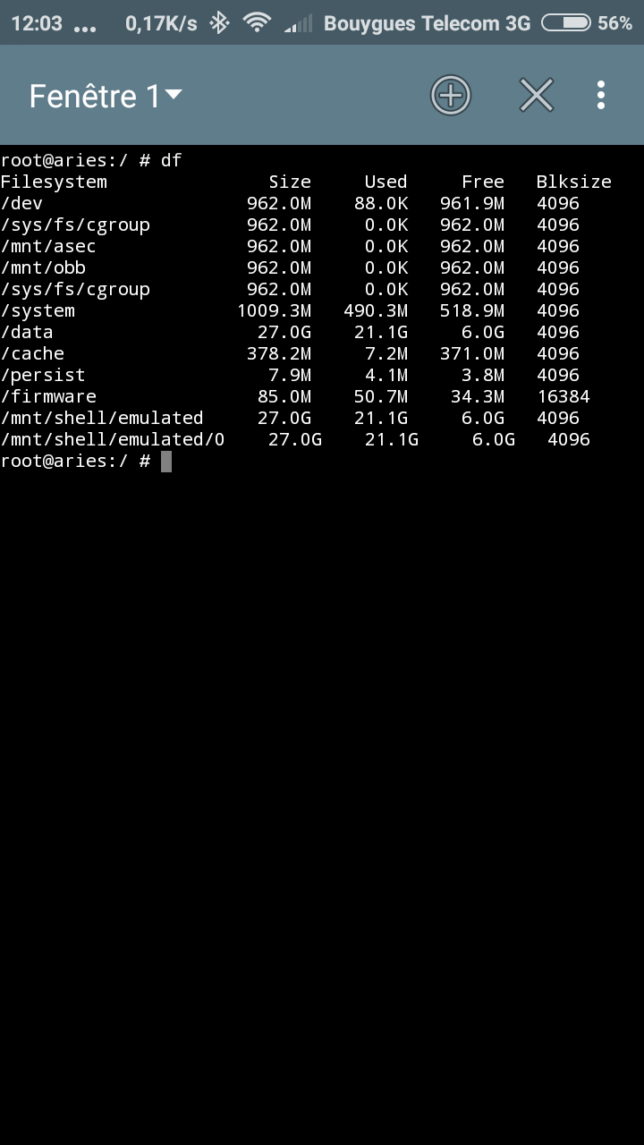

I have this partition table with merged system partitions

I have this partition table with merged system partitionsView attachment 10832

Thanks for fast answer. So I am somehow on old partition table.
Everyone who don't have your partitions have to flash fastboot rom version this or past and then sMIUI. Lots of work here :p make MIUI inbuilt backup or titanium?

Update using Updater app to merge partitions. Using MiRecovery it won't merge the partitions, tested by myself on mi2s. After flashing with Updater app you'll see the /system double it's capacity, it will be 1gb.

If system partition have approx 1GB then you can
