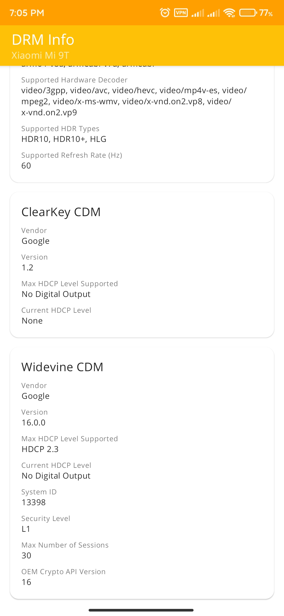

And the Widevine L3 problem? Is L1 gone forever ?
I'm still on L1..

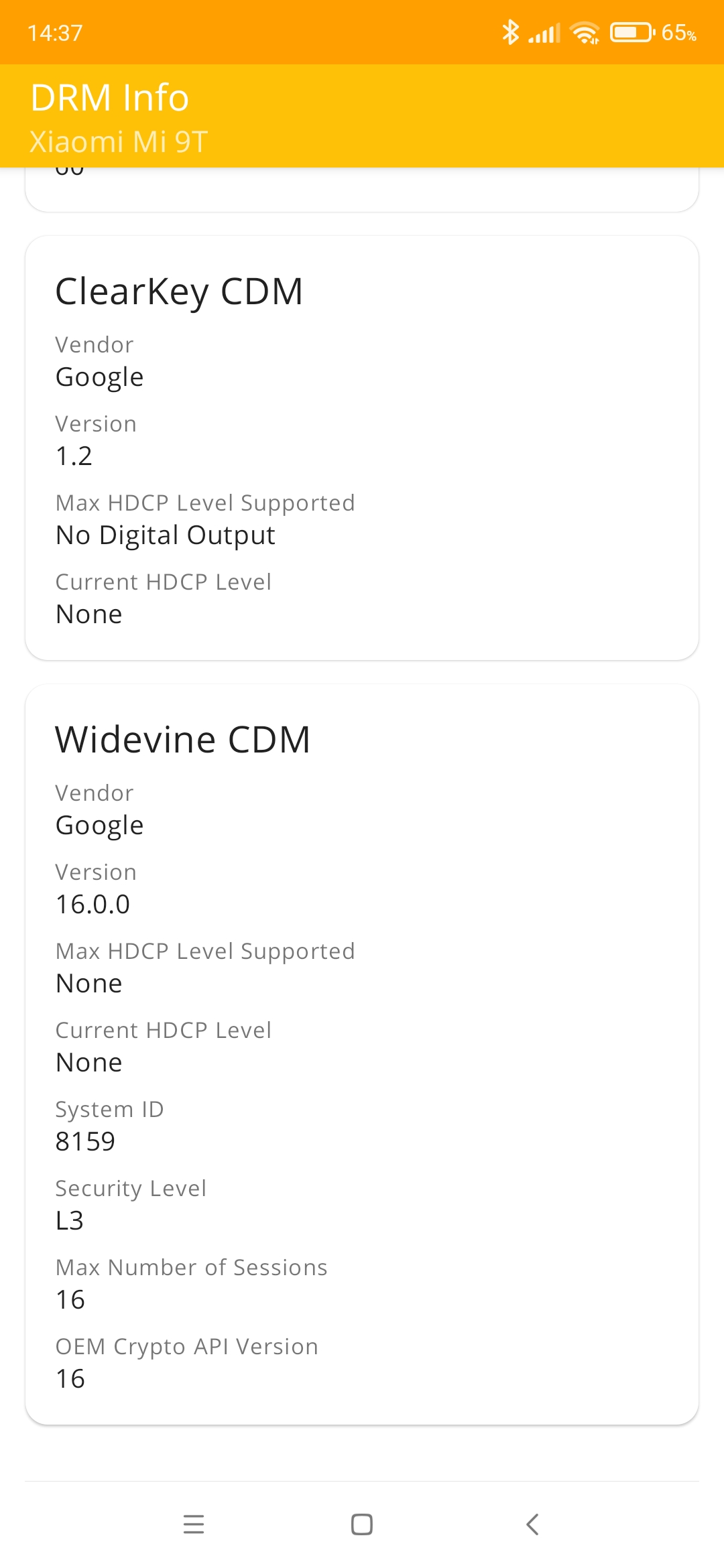

"persist" partition of your device was flashed/tampered = Widevine L1 certification is lost and no way to get it back...
I had just update from weekly to weekly and noticed the lost of L1 on 21.3.17/18. Going back to eu stable or eea changes nothing. Twrp made an persist backup but this backup could maybe tamperd. After flashing the backup, nothing changed. It's still L3.
I don't get it. Why destroys the 21.3.17/18 update the persist partition?
Is it possible to use a persist backup from another K20 or similar Xiaomi phone?
I noticed that Xiaomi has backups of some partitions and also of the persist partition called persistbak. Is it possible to restore the persistbak to the persist partition?
There is also an persist.img in the official rom like eea tar file. Is this usable to restore L1?
Is started up from scratch and installed first eea ROM and use full wipe and relock. After that is started the phone and boot it up and pass the first installation Wizard.
After everything is done I downloaded the DRM app and it still shows L3.
Then boot to Fastboot and unlocked with mi unlock tool.
Then boot to Fastboot and flashed the latest twrp.
At last I installed the Xiaomi EU ROM but the it's still on L3.
Even if you flash a "good" backup of your persist partition, it will not get Widevine L1 back...
You can do NOTHING... :(
Can you explain what the problem is? For what is the backup or the persistbak good for when it's not possible to restore L1?
The persist manage a lot more than L1.
My guess would be that the DRMs detect the fact that the partition have bien modified.
Reactions: Poney70
Okay. I know that this partition is also for sensors or provider signal. But everything is working. I don't know what happened to the persist partition during that update. My device isn't rooted. It's just unlocked for using Xiaomi.eu.
