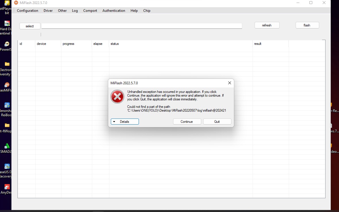

I'm about to run a global version on my mi 11 pro and this happened. I need advice.
D DANKWA Members 7 Jan 2024 8 3 10 Feb 2024 #1 I'm about to run a global version on my mi 11 pro and this happened. I need advice.
C CakeFakeFace Members 8 Mar 2023 18 15 10 Feb 2024 #2 DANKWA said: I'm about to run a global version on my mi 11 pro and this happened. I need advice. View attachment 51339 Click to expand... Happens often for everyone, what you need to do is go into your miflash folder, create a new folder and name it log. After that rerun the program and it shouldn't show the error
