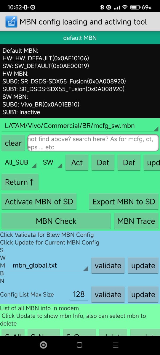

I did method 2, at first it worked for me, now when I try to do it the app freezes and it doesn't work for me

I only changed to mbn_global.txt and the SUB0 (Vivo) was auto detected. But I'm currently using the new 5G SIM Card from carrier on Poco F3.
Screenshot (annex).

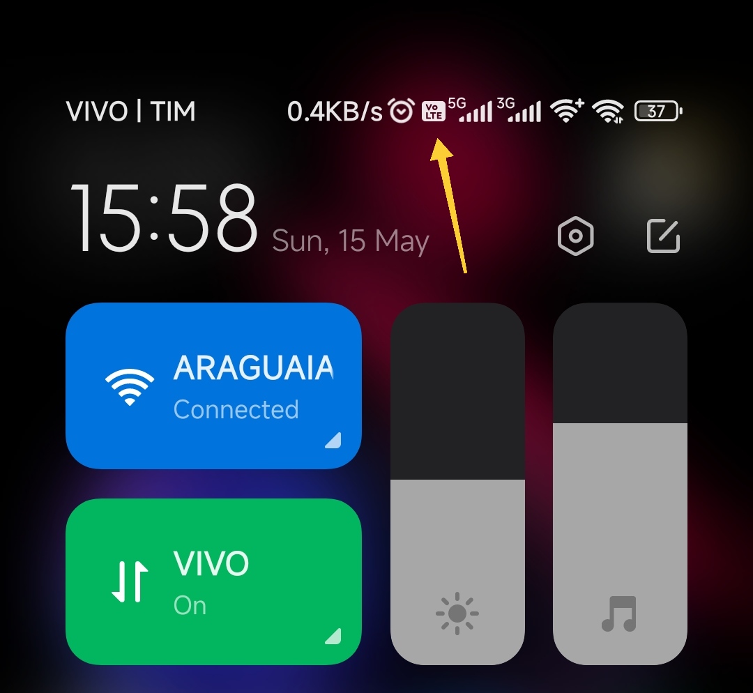

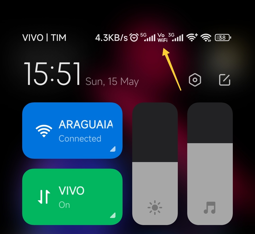

(*) Yes it's possible and Xiaomi is full compatible and reliable at Vivo 4G/5G network services. I personally activated VoLTE/VoWiFi on Redmi Note 6 Pro, Redmi Note 8T and Poco F3 with different Vivo lines.
NOTE: Poco F3 is Anatel Certified for Brazilian carries and 4G/5G services. (Annex)

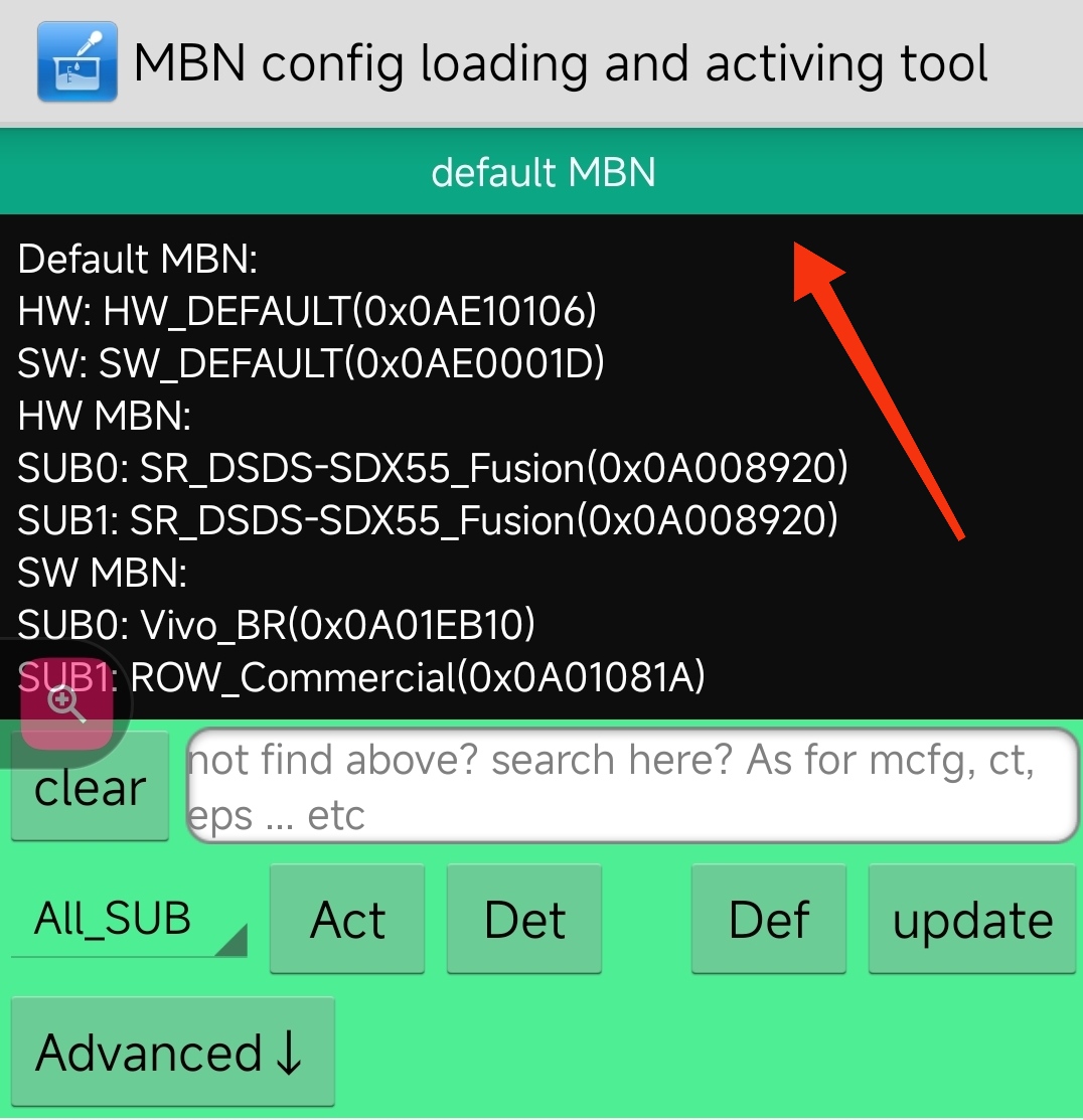

Hi, something strange is happening to me. After lots of complains, VOWIFI is working on my phone, but VOLTE is not. I complained again. Waiting... But, the "stranger thing" is that I need set mbn every day, just when I turn on my poco f3. After that, it works every day... I turn it off to sleep and it wake up with the alarm, but it doesn't work. Then a set mbn again (only global file), he detects default mbn (Vivo), restart, and it works.
Does your bar with "Default MBN" on top is Green or Red?
I tried all the ways: green (default) and red (forced by me). At least, I left it red. And believe: VoLTE is working, since today; just after a lot of Vivo answers that it was not possible, hahahahahha.
You need to roll back to GREEN default MBN.
The issue that you reported is related with that. When forced the auto detect doesn't work anymore and you'll have to troubleshoot it after every ROM update and maybe when shutdown as you mention.
Vivo-SP Carrier did some 5G rollout today and I saw a lot of VoLTE/WiFi been automatically enabled on Xiaomi.
The service was intermittent because it was deploying on the line, I believe. Once it has firmed up, green or red, apparently it doesn't matter, it's starting to work normally. But, anyway, it's green again...
