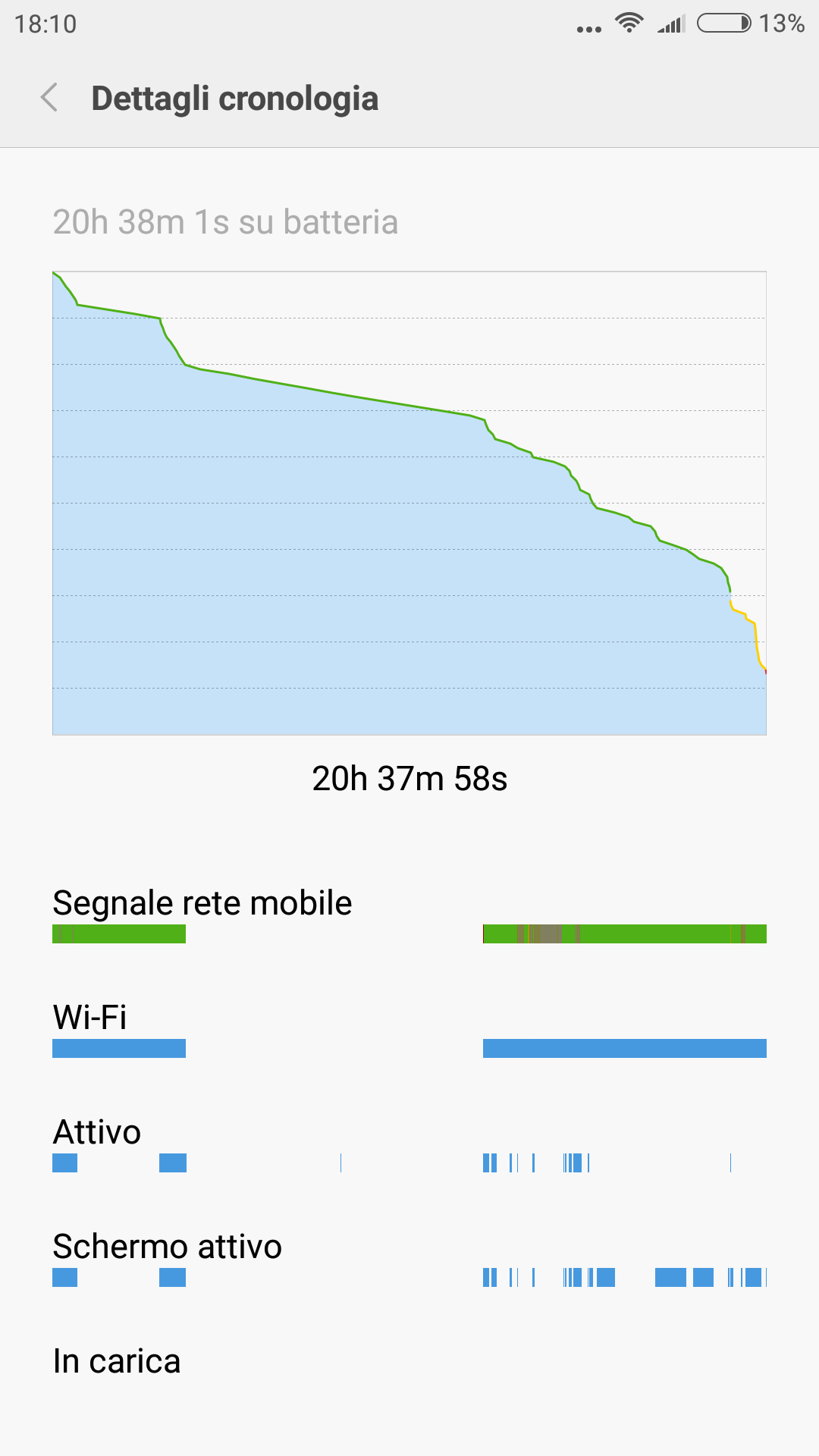

Hi guys, I installed it yesterday, I don:t use much my mobile. With the older rom my battery stay around 2 days.
Now less than 10 hours, how is it possible?
I don't know, there is my stats
22h since i charged and now i have 40% of battery.
Look mine, now is 9% and at night i set flight mode :-(

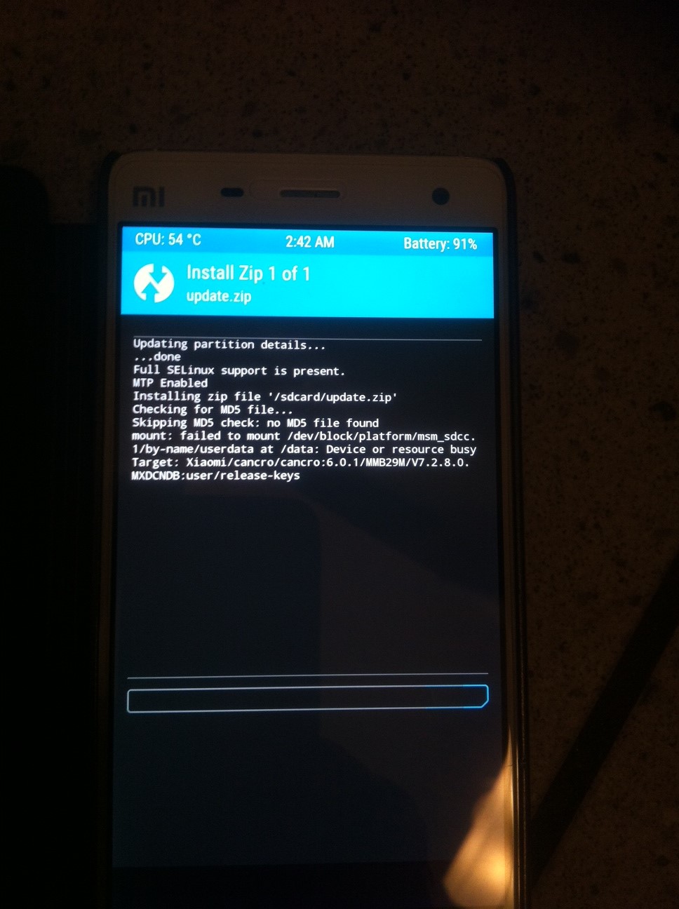

I'm flashing now, is it normal that message, failed to mount?
I had same message and have no problem
Yes, just let it complete, takes time.
