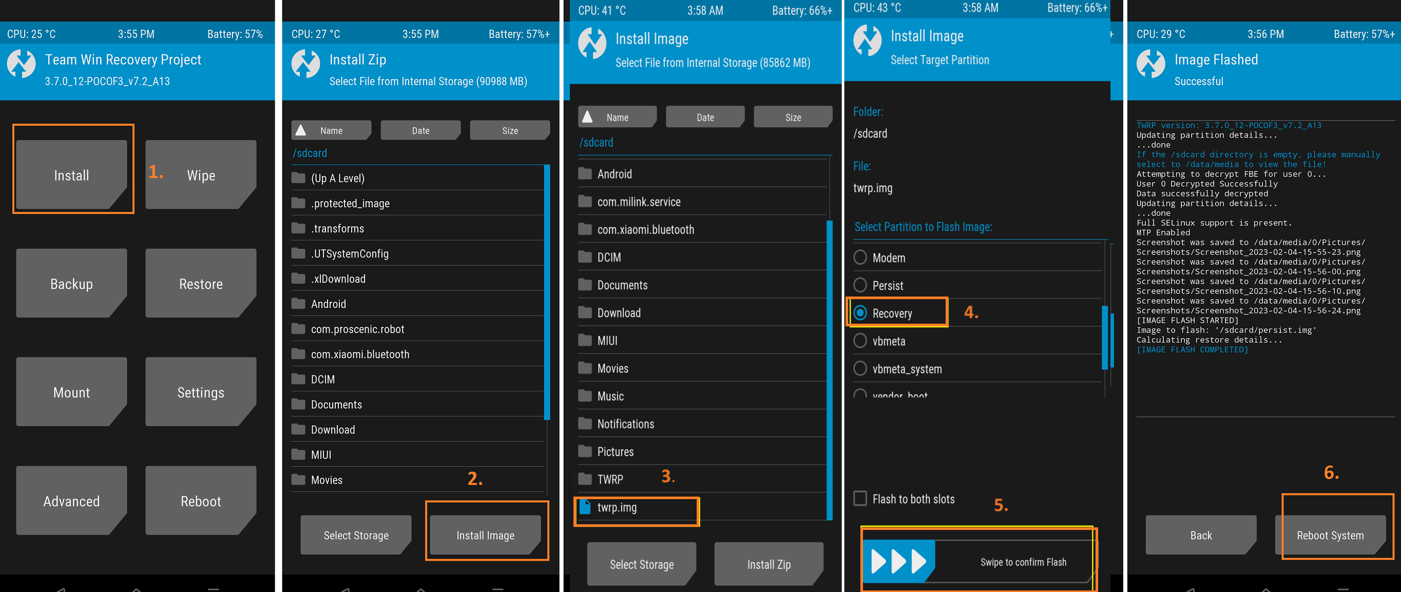

XM 12......You can update TWRP using TWRP. (probably you are making a mistake somewhere)
TWRP > install > install image > choose File > select partition RECOVERY > swipe to confirm Flash > reboot system or recovery
It is always necessary to distinguish whether you have a device with a dedicated partition for recovery or without a dedicated partition (XM 12 has a dedicated recovery partition).
- Reserved partition for recovery = TWRP is installed in the recovery partition
- Without a dedicated partition for recovery = TWRP is installed in the RamDisk

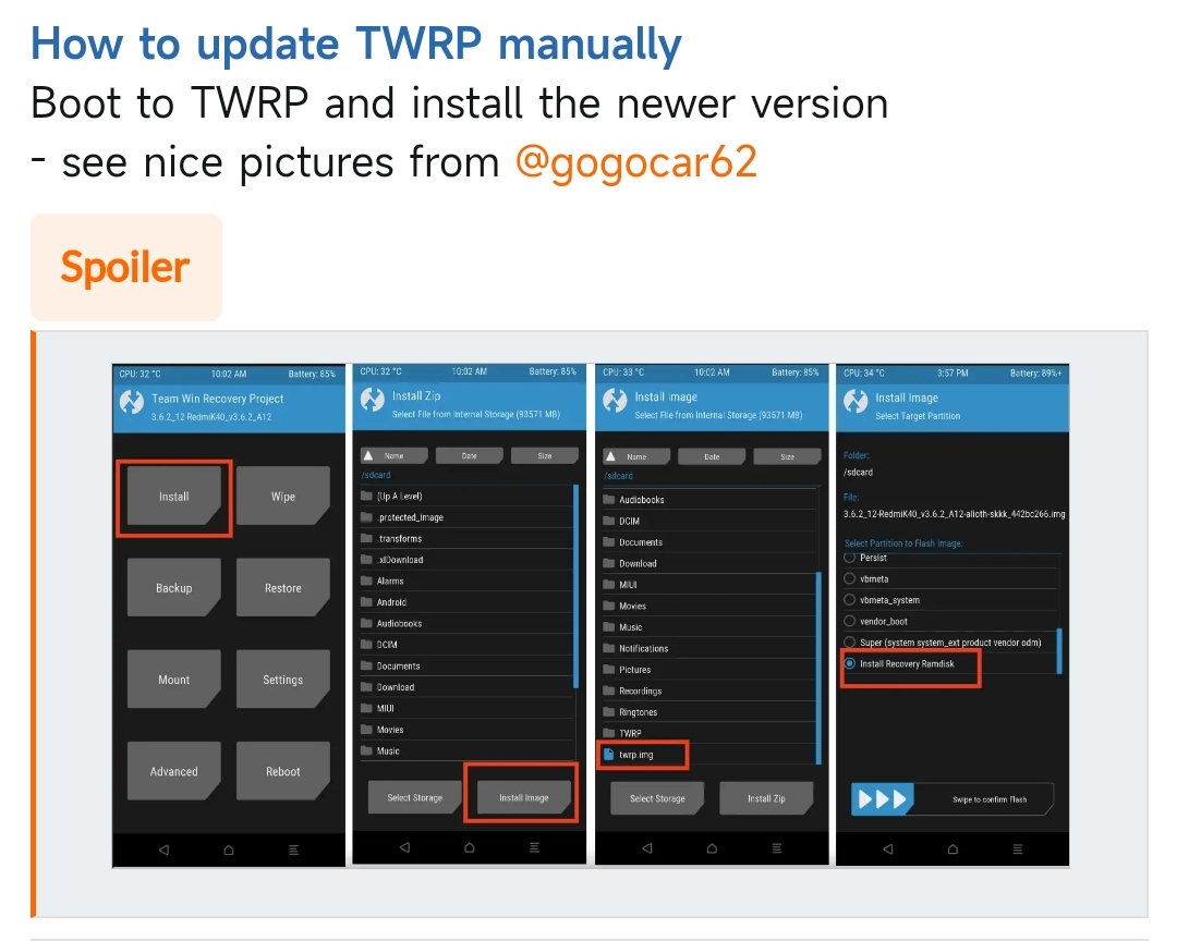

Well, I am writing because of what happened to me with my Xiaomi 12 Pro when I switched to Hyper-os, I lost the roms when I updated the twrp from twrp. It only worked well for me if I updated via fastboot. It happened to me 2 times and I had to reinstall the roms 2 times. it's not a lie. I write because of what happened to me. when I used twrp to install revovery ramdisk.
