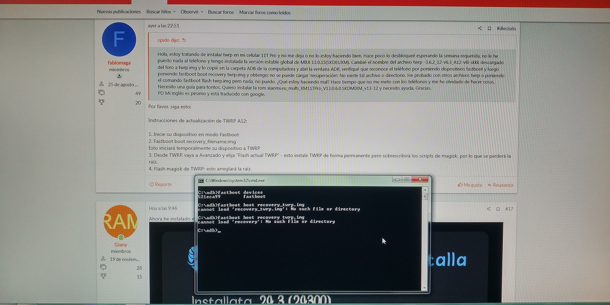

Hi, I'm trying to install twrp on my 11T Pro phone and it won't let me or I'm not doing it right. I recently unlocked it waiting for the required week, I haven't put anything on the phone and I have the MIUI global stable version 13.0.15(SKDEUXM) installed. I have renamed the file twrp -3.6.2_12-v6.3_A12-vili-skkk downloaded from the forum to twrp.img and copied into the ADB folder of the computer and opened the ADB window, I have verified that it recognizes the phone by putting fastboot devices and then putting fastboot boot recovery twrp.img and I get: cannot load 'recovery': No such file or directory. I have tried other twrp files or putting the command fastboot flash twrp.img but nothing, I can't. What am I doing wrong? It's been a while since I messed around with phones and I've forgotten to do things, I need a guide for dummies. I want to install xiaomi.eu_multi_XM11TPro_V13.0.6.0.SKDMIXM_v13-12 rom and I need help. Thanks.

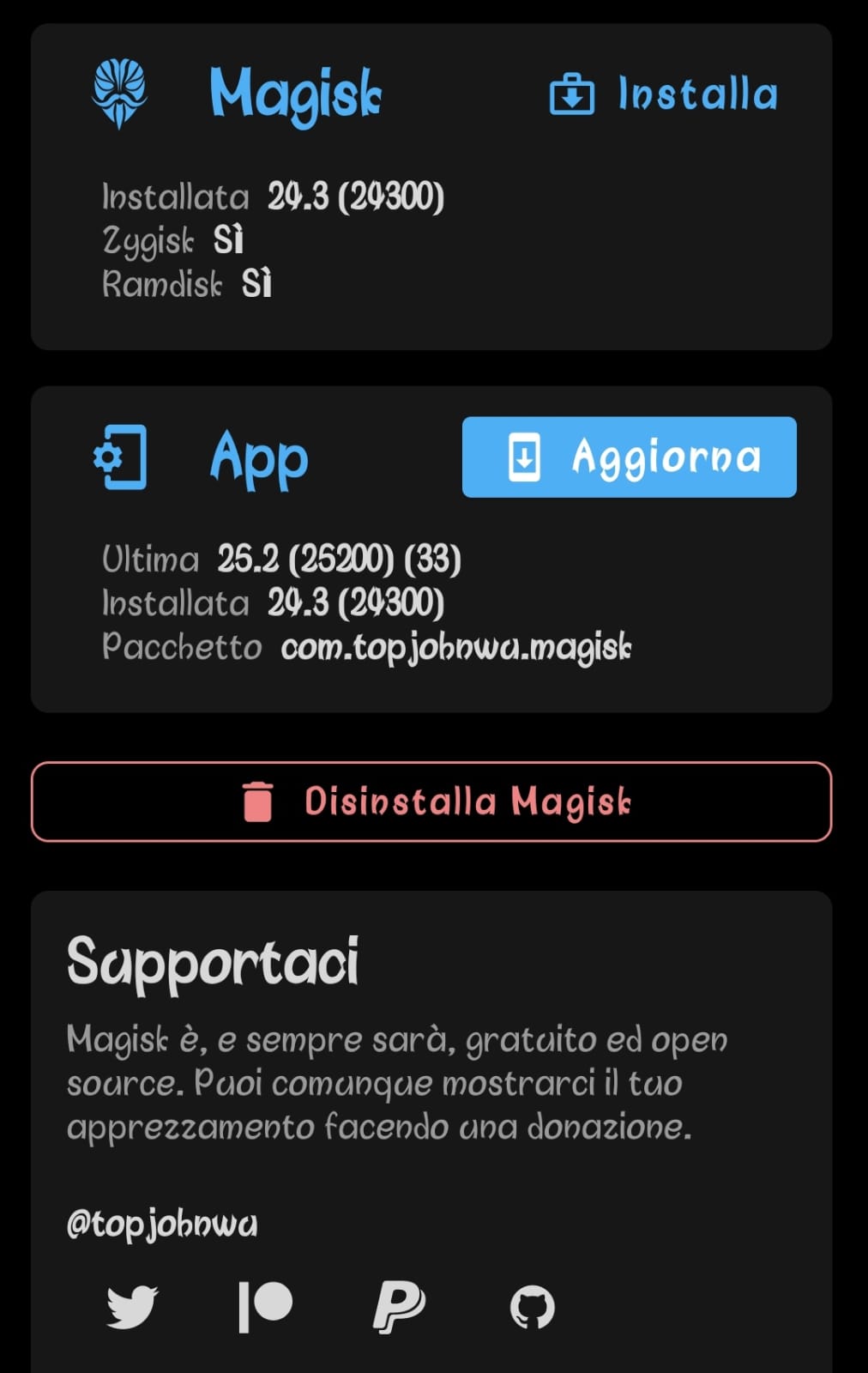

I have now installed this version of magisk on the phone. Can I put the same version back after flashing twrp?

Hello good morning, in the ADB window what I get is this:
I think I'm going to need a guide for dummies, sorry.

Do not use the command: fastboot boot recovery twrp.img, instead you use: fastboot boot twrp.img, after that TWRP will boot. Go into Advanced and Select ,,Flash Current TWRP'' this will delete root if installed before. From TWRP reboot into Recovery, your phone is going to reboot to TWRP, you may need to put you password in for decryption. If you want to install Magisk, you can do that under Advanced> Install Magisk (or Install Magisk Alpha)
Edit: Is your platform-tools up to date? If not update it by installing it here: https://developer.android.com/studio/releases/platform-tools, I've noticed problems with the newest TWRP file Version 6.3 (I believe) provided by skkk. try to use the Version 6.2

Parece haber funcionado con twrp 6.2, gracias.
