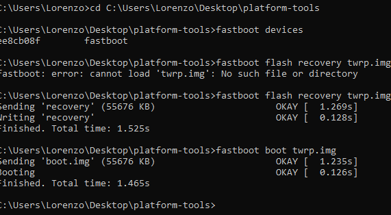

Drivers seem to be working fine. The cmd command fastboost devices Show me a connected device which is my phone.

I managed to install twrp on the phone. (I hope)
However, now it does not boot into it. When I press the volume up and power button it goes itnto MI-Recovery 3.0. As twrp was never installed…..Help!

Hi Fastboot is diffrent from ADB.
Fastboot commands are working if your device is in Fastboot-Mode and ADB (Android Debug Bridge) is working while your device ist up an running.
if you are in fastboot mode with your device you have to type
# fastboot devices
instead of
# adb devices

Thanks, I figured it out last night ;-). The problem is that as soon as I reboot into fastboot mode, no unit is discovered in Windows. Same on my Mac and other PC as well. ADB = fine, reboot to fastboot = no device at all...

- connect PC and phone with USB cable
- put phone in fastboot (reboot phone and then holding "Volume -" and "Power on" buttons simultaneously)
- you should see a bunny picture and an info "fastboot" on the phone
-> on some devices you will see only orange info "FASTBOOT" and no bunny
- type in "cmd window": "fastboot devices" and hit RETURN
- check if you see a number (sometimes with characters)
-> then all is fine
- if you dont see a number:
change USB port / change USB cable / use USB 2.0 / use an USB Hub / check driver installation
driver and so on…
