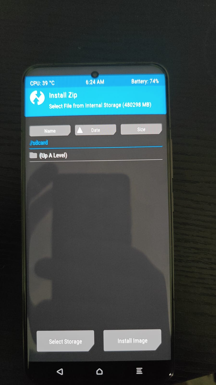

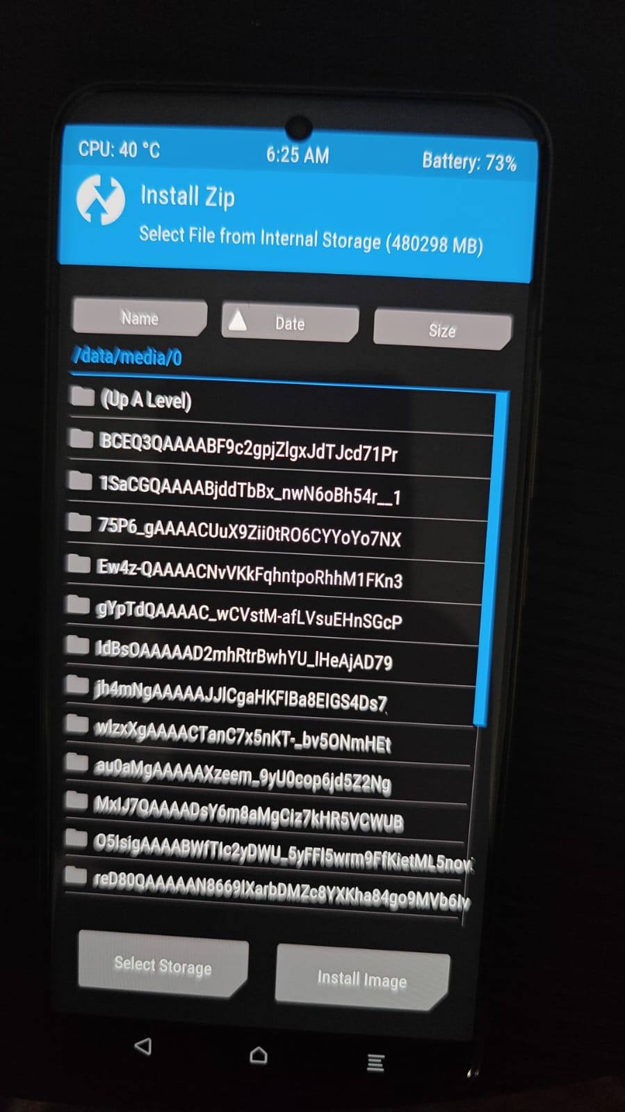

I downloader the ZIP (from here) and then in TWRP it doesnt show me the ZIP data
What is the problem, please help me..

As far as I know, TWRP can't decrypt the partition on X14 for now, so you would need to use USB OTG or fastboot.
Thanks for your answer. so you mean that i should Update latest OS version via USB ? Is that without TWRP?
You can use external memory devices with TWRP, or you can use fastboot.
Maybe you need to fully read the first post of the ROM thread.
Thanks for yout answer. I have to find a video wich shows me how to do this variation of installing without TWRP.
Sry for my low knowledge, i am very new here and its my first Xiaomi.
I feel your pain. I recently bought a 14 Pro myself and was wondering why I couldn’t find the zip file after launching TWRP. As JiaiJ mentioned, TWRP can’t decrypt the latest mobile generation for now, that is the reason why you can not find the zip file.
I never had a Xiaomi before, never flashed a ROM in my life, so looking into tutorial videos confused me even more. Took some time to figure it out, but the fastboot method did work out for me at the end. Once you installed the ADB tools and potentially the USB driver in case missing on your PC, getting the ROM on to your device is pretty straight forward.

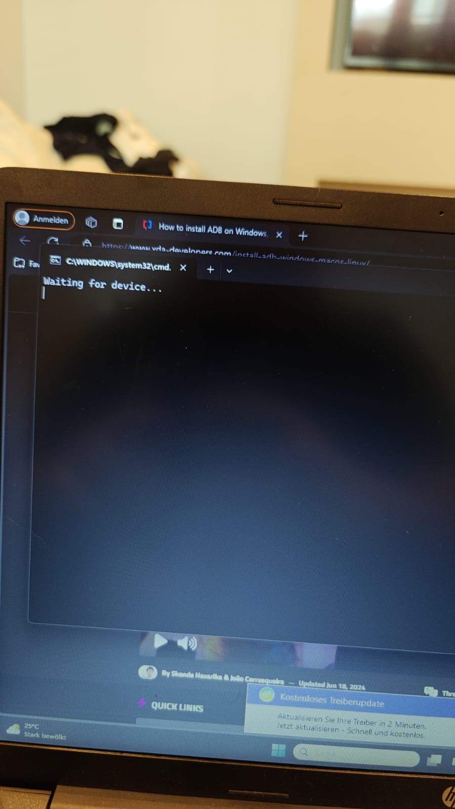

i did everything...now it just stands "waiting for device"
i did everything..fastboot etc..
what now just wait? how long?

you pc might not recognise your mobile via USB. After you plugged in your mobile, open the "device manager" and check under "Portable Devices". If you PC recognises your mobile, you should see it as "Xiaomi 14 Pro Ti". I cant remember exactly what it says if not, i think the label says then "unknown" (Sorry i use normally MACs) Right click and update the driver with the local copy you downloaded from here https://provider.xiaomi.eu/tools/driver.zip

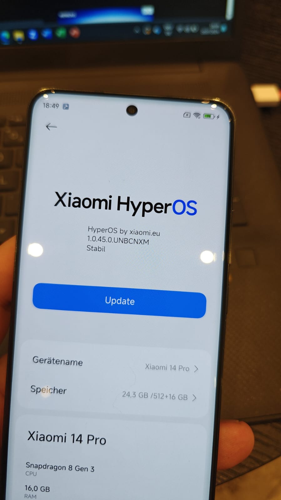

Man it works
Thanks to everybodyyyyy
