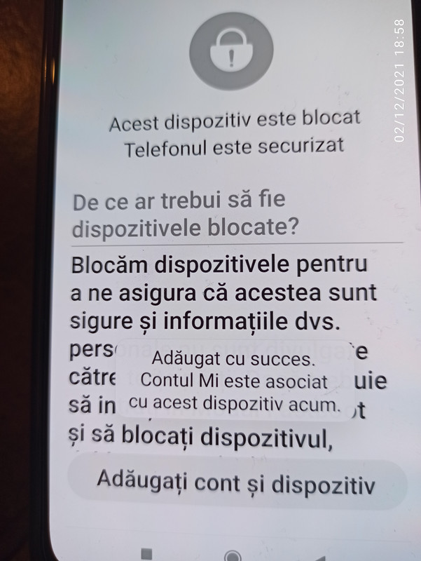

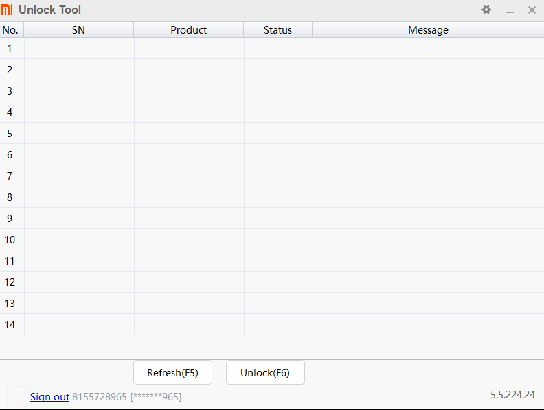

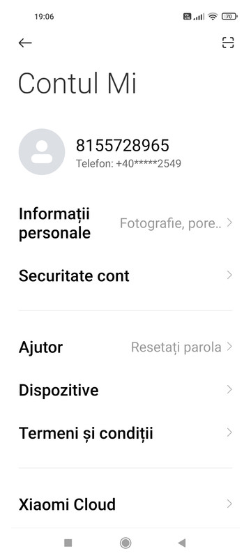

Am instalat și activat „miflash_unlock-en-5.5.224.24”. Activez Fastboot și conectez telefonul XIAOMI Mi 11 Lite G5 la computer.
Deschid „batch_unlock”, văd că contul meu este activat. Nu are niciun efect asupra Deblocării.
Computerul nu poate vedea telefonul. Ce altceva trebuie să fac? Mulțumesc.

You are doing everything wrong.
Follow the video I gave you.
1. Mi unlock:
- run Mi unlock
- log in to Mi account
2. Phone:
- Log out My account from the phone
- turn off Wifi
- restart the phone
- turn on Data in the phone (do not use wi-fi)
- Now, Go to Settings options of the phone and then go to Additional Settings> Developer Options.
- Click on add Mi account with the device.
- Log in to Mi account
- run fastboot mode
- connect the phone to a PC via USB
3. Mi unlock:
- click on unlock
