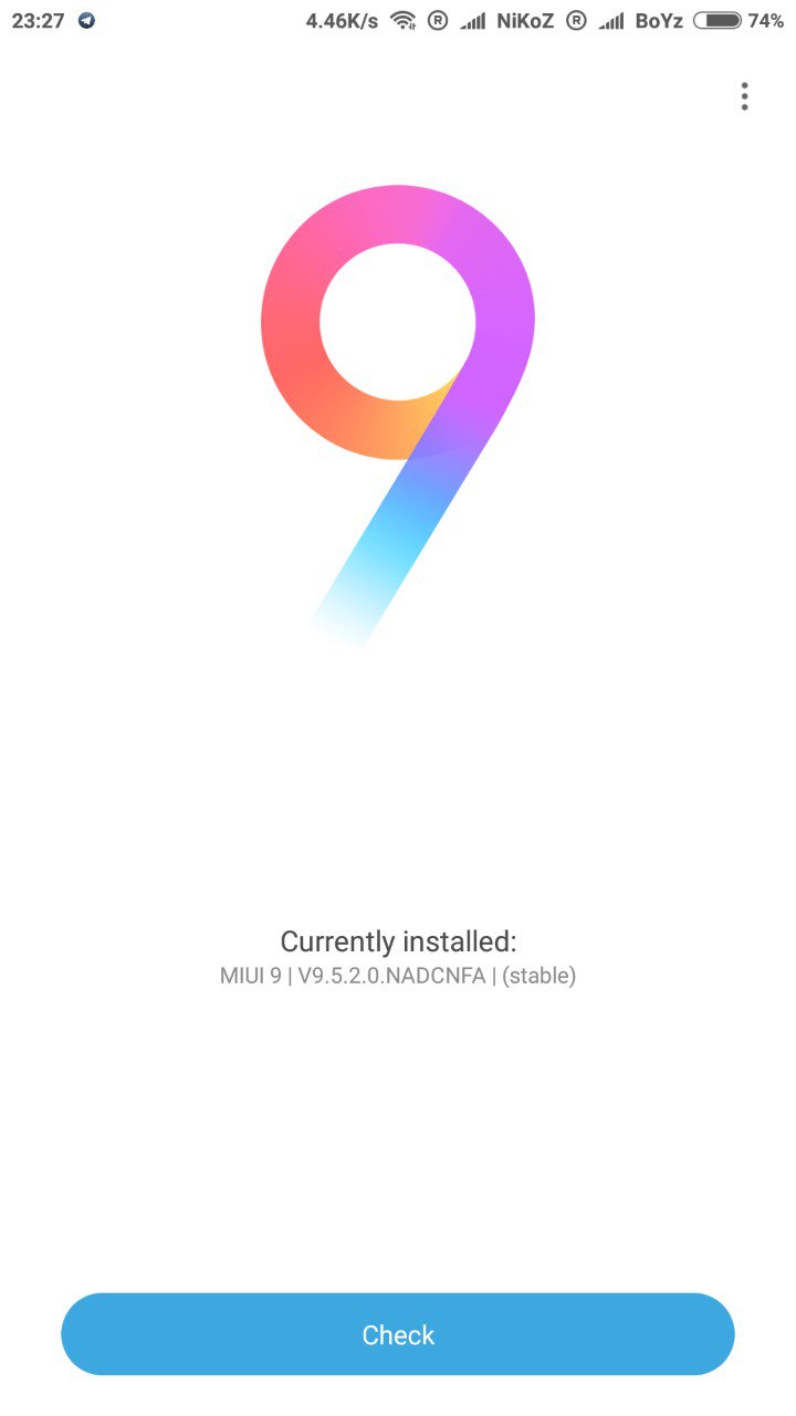

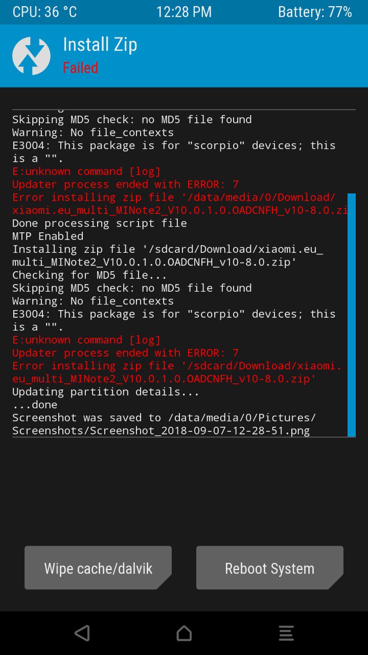

Since I've this Note 2 i've been using xiaomi.eu doing update, without any problems, now, don't work error on model name, I'm currently running on Miui 9.5.2.0 working really good, but i can't update to 10 ;( Anyone can help ? Please check the screenshoot

You can backup with TWRP, it works excellent. BTW your problem can be related with TWRP, update it if possible.

Yes you where right, I've update my TWRP and I succeed to update to miui 10 ! Tanx bro
