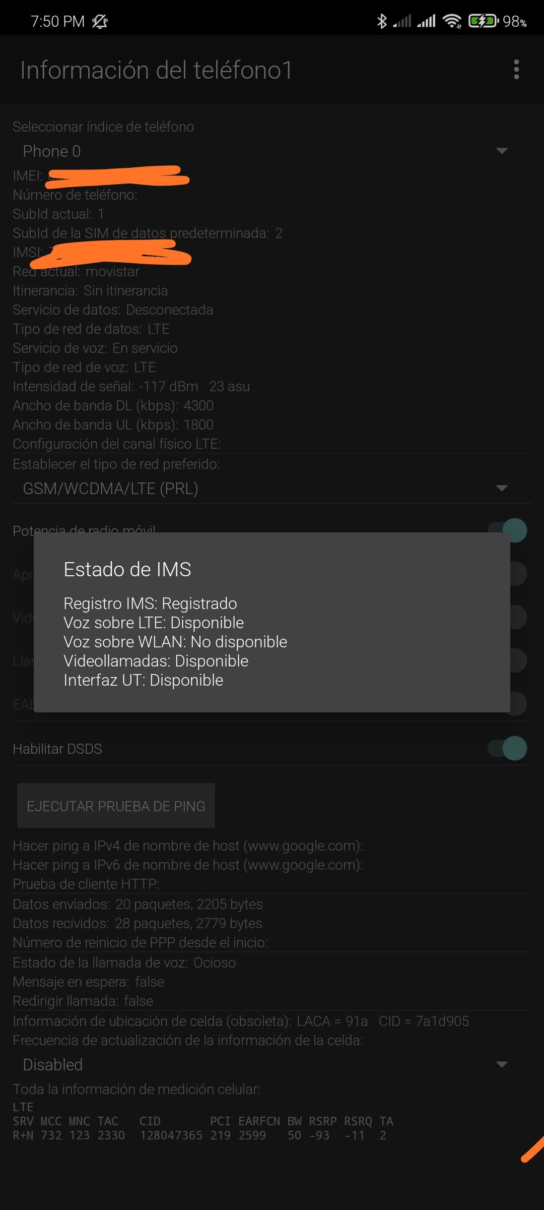

Settings - my phone - all - storage (click 3 or 4) - phone info 1
Tapatalkkal küldve az én M2002J9G eszközömről
Thanks, those are my screenshots, pretty much like yours.
I don't understand why other people has VoWifi

My service provider do support VoWifi, actually if I swap SIM card with other cell phone, it works. I asked my provider if any cell phone could be banned and answered me not, all are fine along are able to work with VoWifi

Also on my MI 10 Lite 5G in phone information both the VOLTE and WiFi calling provisioned switches show as off, But both are enabled in the SIM settings and work.
