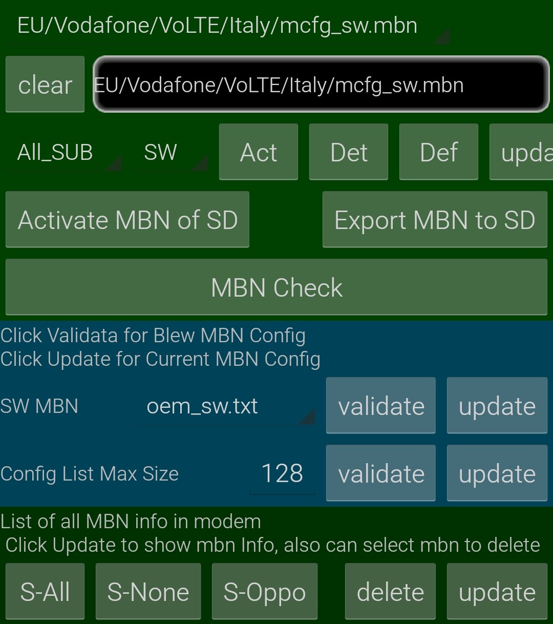

Hello guys, hello @giodeluigi . I'm trying to follow your steps, but actually the attached image is what I see on my k30 5g A12 weekly.
In the listed SW MBM I only find: default, oem_sw.txt, oem_sw_j9.txt.
Do I have to search for "vodafone/VoLTE/Italy", (even if my operator is another one?) and then press "act"? And what then?
Thank you
Thank you
Hi!
You'd better search your operator one.
