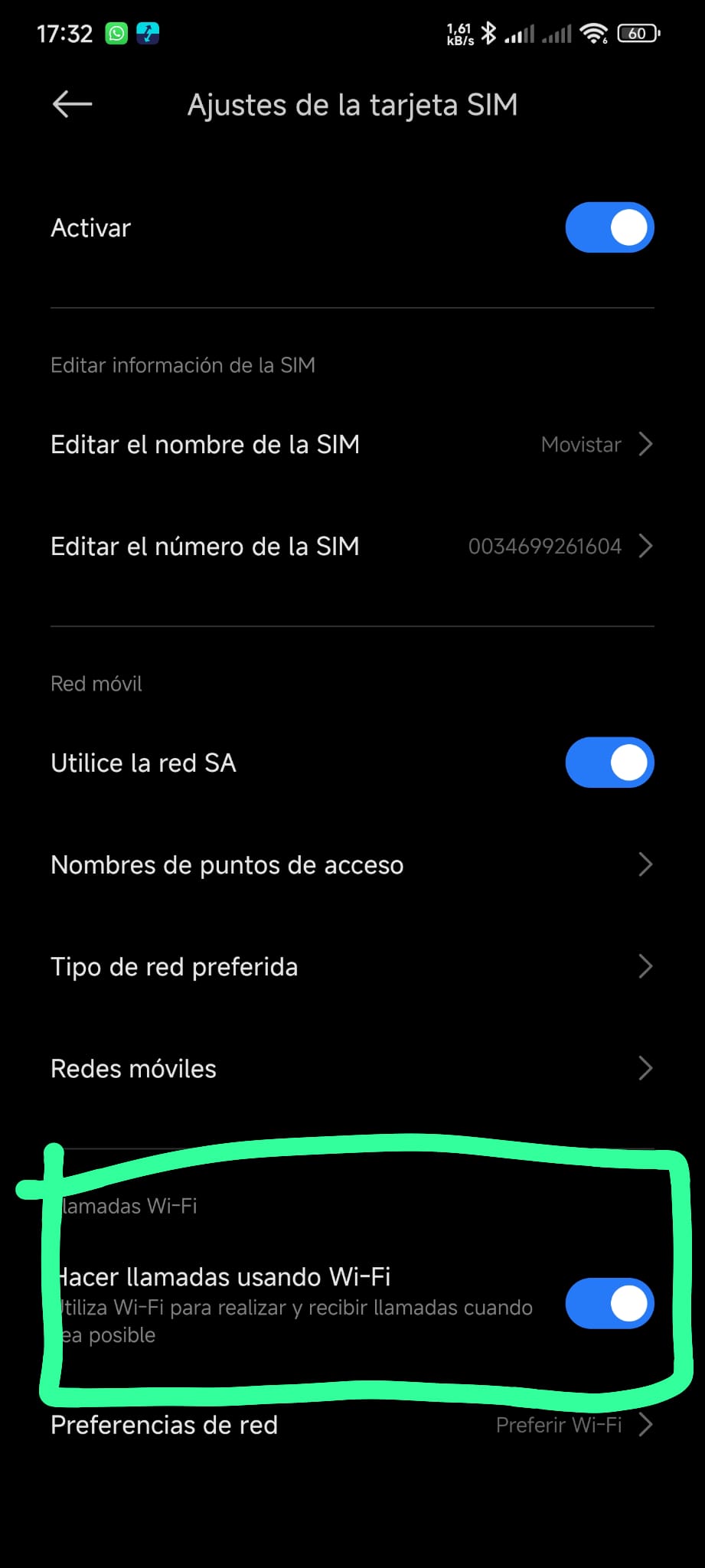

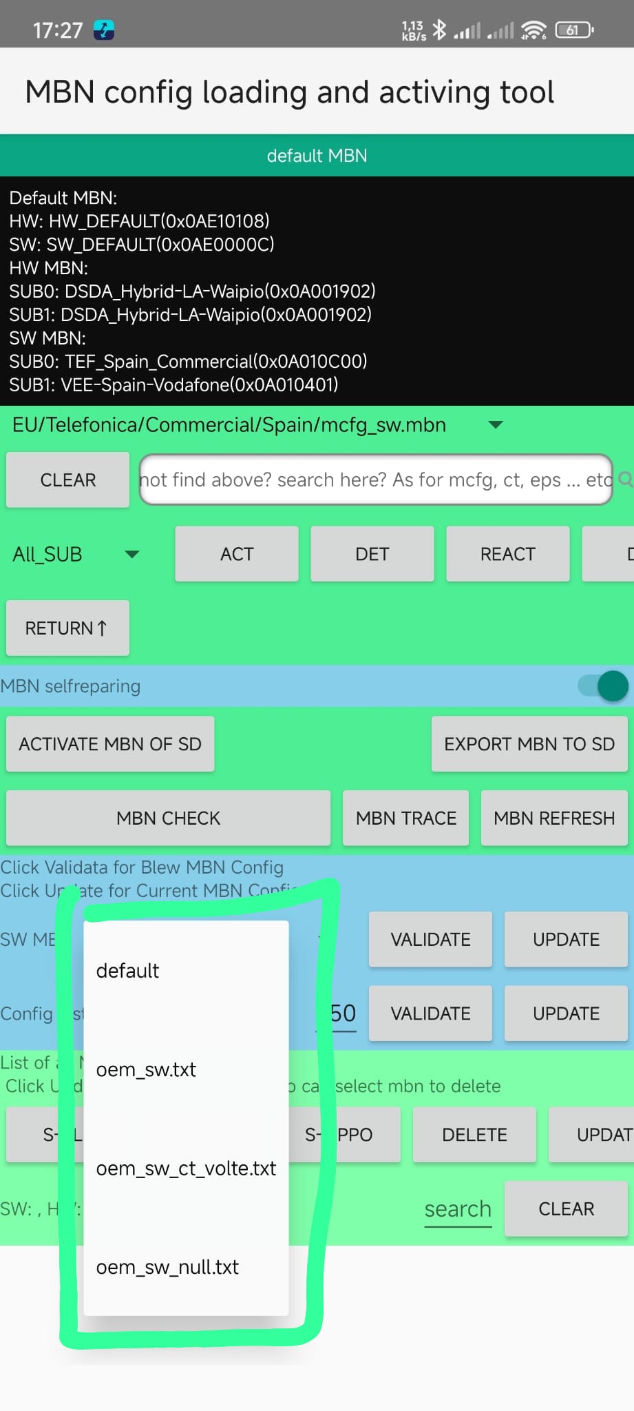

Hello, everyone on my X12PRO since I went from GLOBAL ROM to ROM Xiaomi.eu I do not work VOWIFI calls.
I have activated VOWIFI on my sim 1 (MOVISTAR) and entering MBN CONFIG * # * # # # 663368378 # # * # # * I do not appear in SW MBN "mbn_eea.txt" and I can not activate it.
I've been trying for months with different versions of rom MIUI and HYPEROS and does not work.
Does anyone else it happens, do you have the solution partners?
Hola, a todos en mi X12PRO desde que pase de ROM GLOBAL a ROM Xiaomi.eu no me funcionan las llamadas VOWIFI.
Tengo activado VOWIFI en mi sim 1 (MOVISTAR) y entrando en MBN CONFIG * # * # 663368378 # * # * no me aparece en SW MBN "mbn_eea.txt" y no puedo activarlo.
Llevo meses probando con diferentes versiones de rom MIUI y HYPEROS y no funciona.
A alguien mas le pasa?, teneis la solucion compañeros?

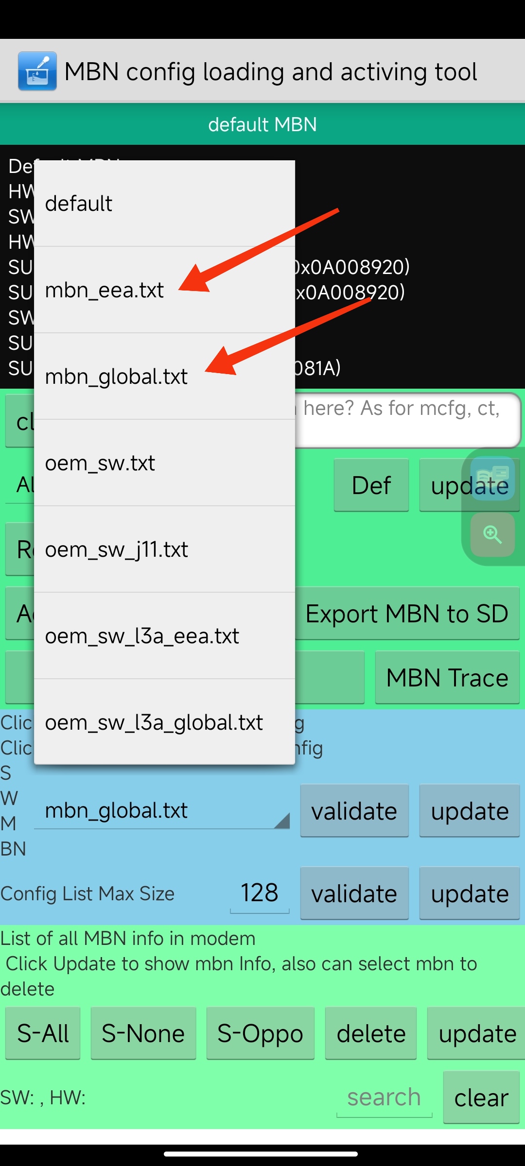

You must select mbn_eea.txt or mbn_global.txt files otherwise VoLTE/VoWiFi won't works.
It seems that global and eea mbn files are missing from some releases, because it is missing from Xiaomi 13 (fuxi) and Xiaomi 12 (cupid) too, there seems to be available only oem.
I'm using Xiaomi.eu custom ROM on both phones (xiaomi.eu_FUXI_OS2.0.100.0.VMCCNXM_15 and xiaomi.eu_CUPID_OS1.0.12.0.ULCCNXM_14)
Temporary: What I noticed is, if I manually search from my mobile operator (DigiMobil from Romania) and if I set "default" as config, my phone is connecting to my mobile operator using Wifi, but if I'm restarting the phone the phone is no more able to enable VoWiFi connection.
