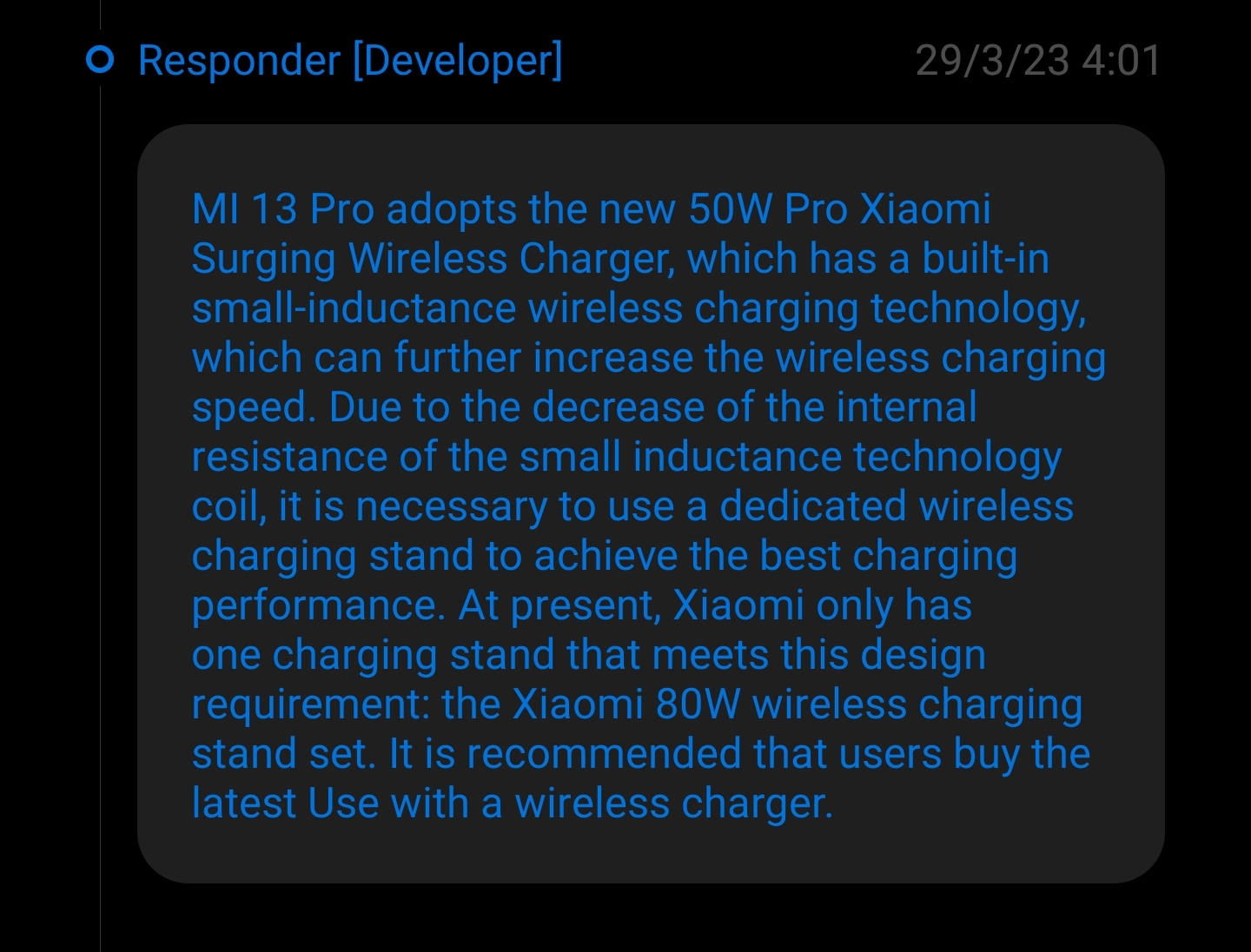

Xiaomi dev say this:

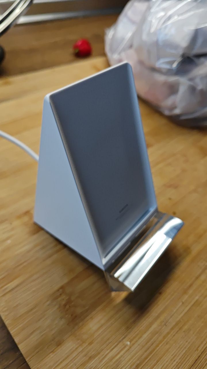

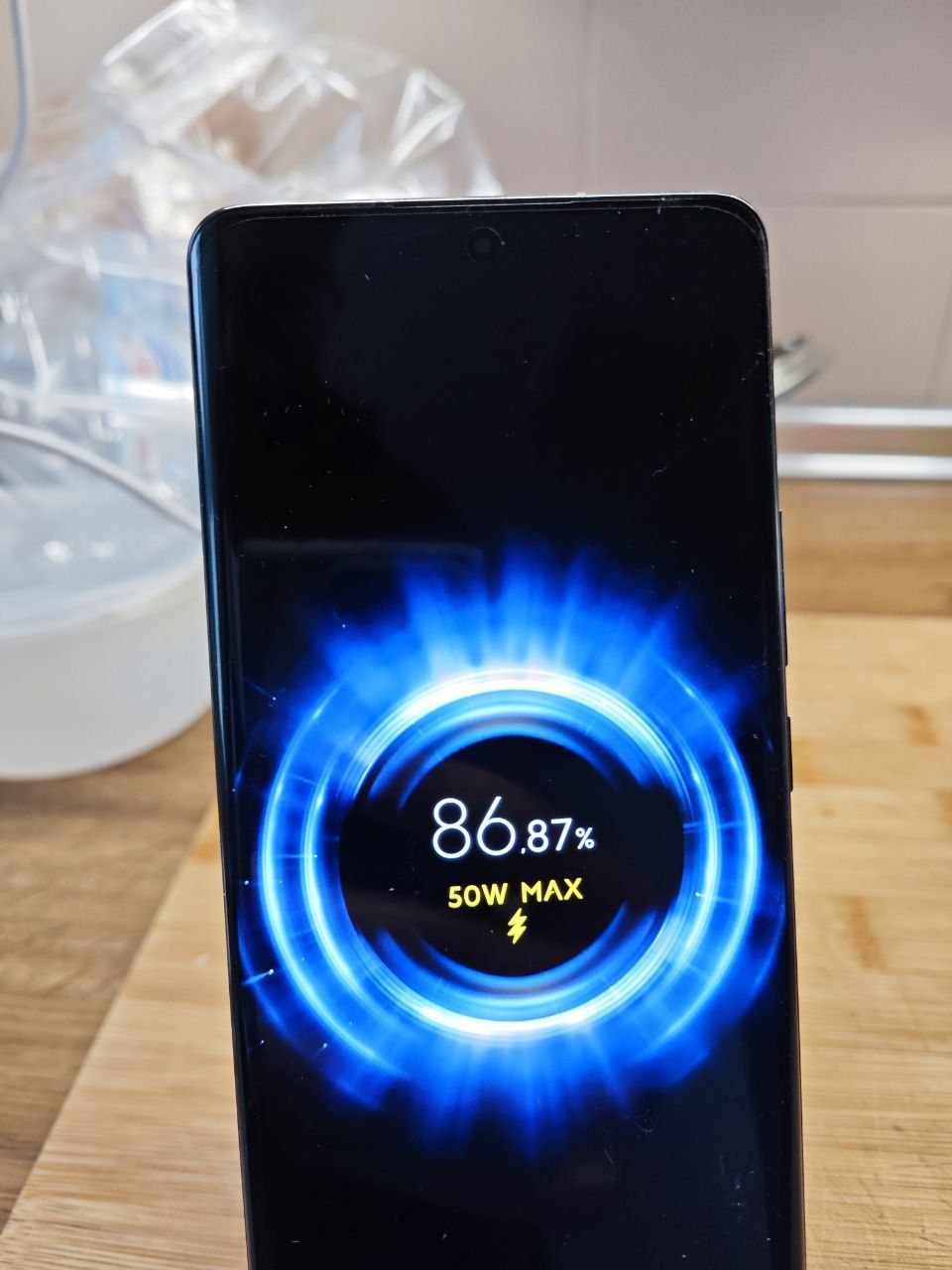

[SOLVED] We have to buy the new wireless charger
Xiaomi 13 Ultra here. Maxes out at 30w using the 120w charger with the 55w Wirless charger (Gold/Black), works fine at 50w with the new 100w wireless charger, its the upgraded 80w wireless charger shown above (White).
Now works with the new wireless charger (13 Pro)

Hello everyone. My phone is Xiaomi 13 Global version (codename is fuxi). I'm using xiaomi.eu stable rom.
A few month ago I've investigated this issue. So pls find below my findings:
1. Original wireless chargers 50w and 55w - both in black color. And for both the model is "MDY-12-EN". They are absolutely the same, the difference only as follow:
50W model (MDY-12-EN) - set of wireless charger + wired charger 67W + cable 6A
55W model (MDY-12-EN) - only wireless charger
2. The model "MDY-12-EN" will charge Xiaomi 13 by full 50W power
3. Regarding Xiaomi 13 Pro, the charging by model "MDY-12-EN" will be limited to 30W due to different location of magnetic coil.
4. That's why Xiaomi released in 2023 upgraded 50W version (in white color).
The new 50W model is "MDY-14-EN" especially for Xiaomi 13 Pro to get full 50W power. In addition, new model is more quiet than previous.
5. Soon I will test new 50W model "MDY-14-EN" with my Xiaomi 13 (not pro). I believe also get full 50W power.
6. Original wireless chargers 80W (MDY-13-ED) and 100W (MDY-13-EL) will charge Xiaomi 13/13Pro by full 50W power. The only remarks they are very loud and can be annoying while sleeping and resting.
