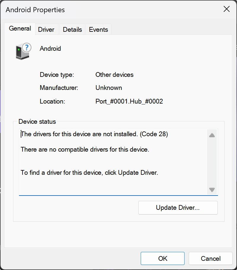

Hi guys,

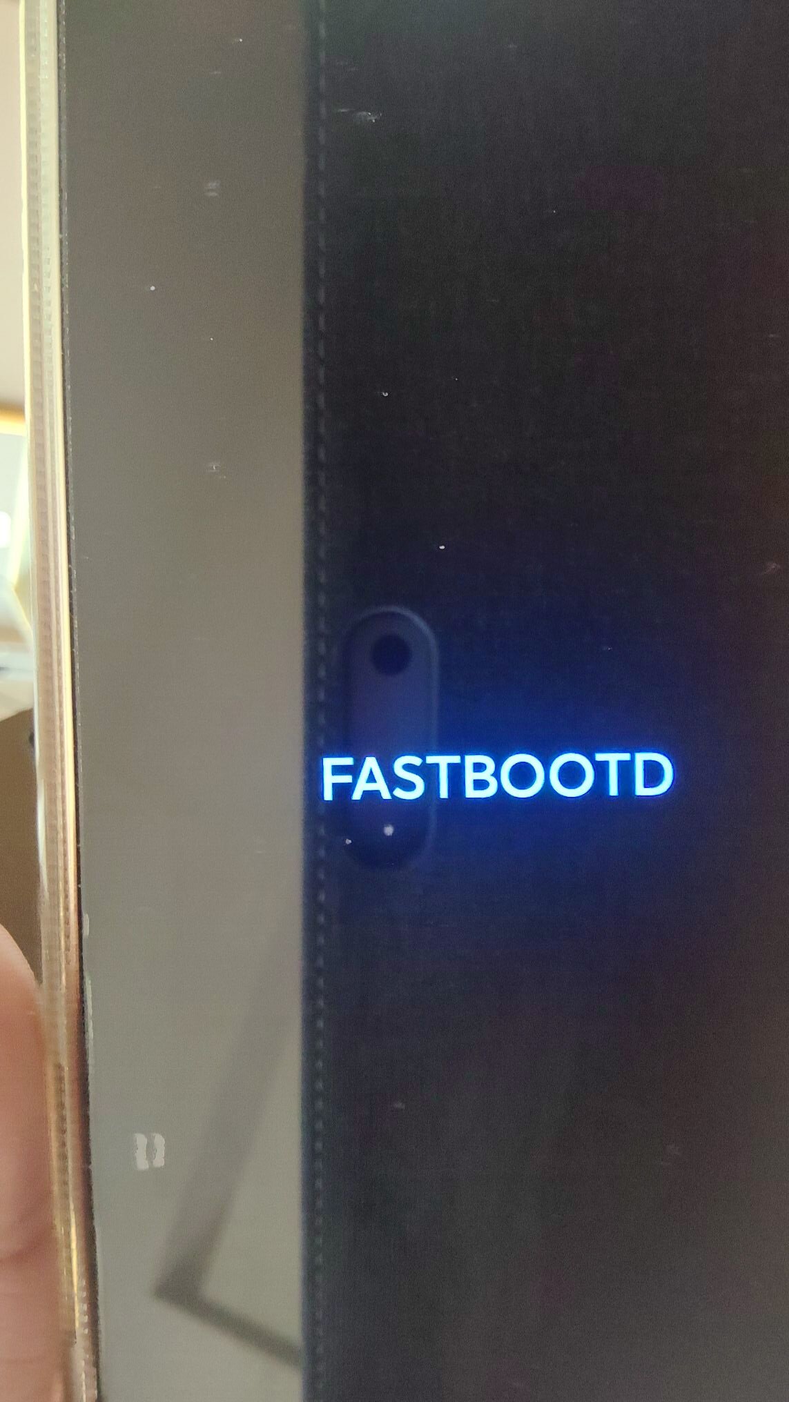

i've recently got my surface pro (11) on snapdragon X plus, ARM cpu, and i wanted to update my phone to the last dev and update to the stable rom.
but i can't detect my phone when its on fastboot. i tried so many driver and solutions...but not working..
do you think its maybe incompatibility with ARM cpu ?
ok i found for information
on android device not recognized
Device Manager> Right Click your ADB or Fastboot device>Update Drivers>Select from list>Universal Serial Bus Devices> Select "WinUSB">Select "ADB Device" and install that.
thanks @whoareyouxda on reddit
