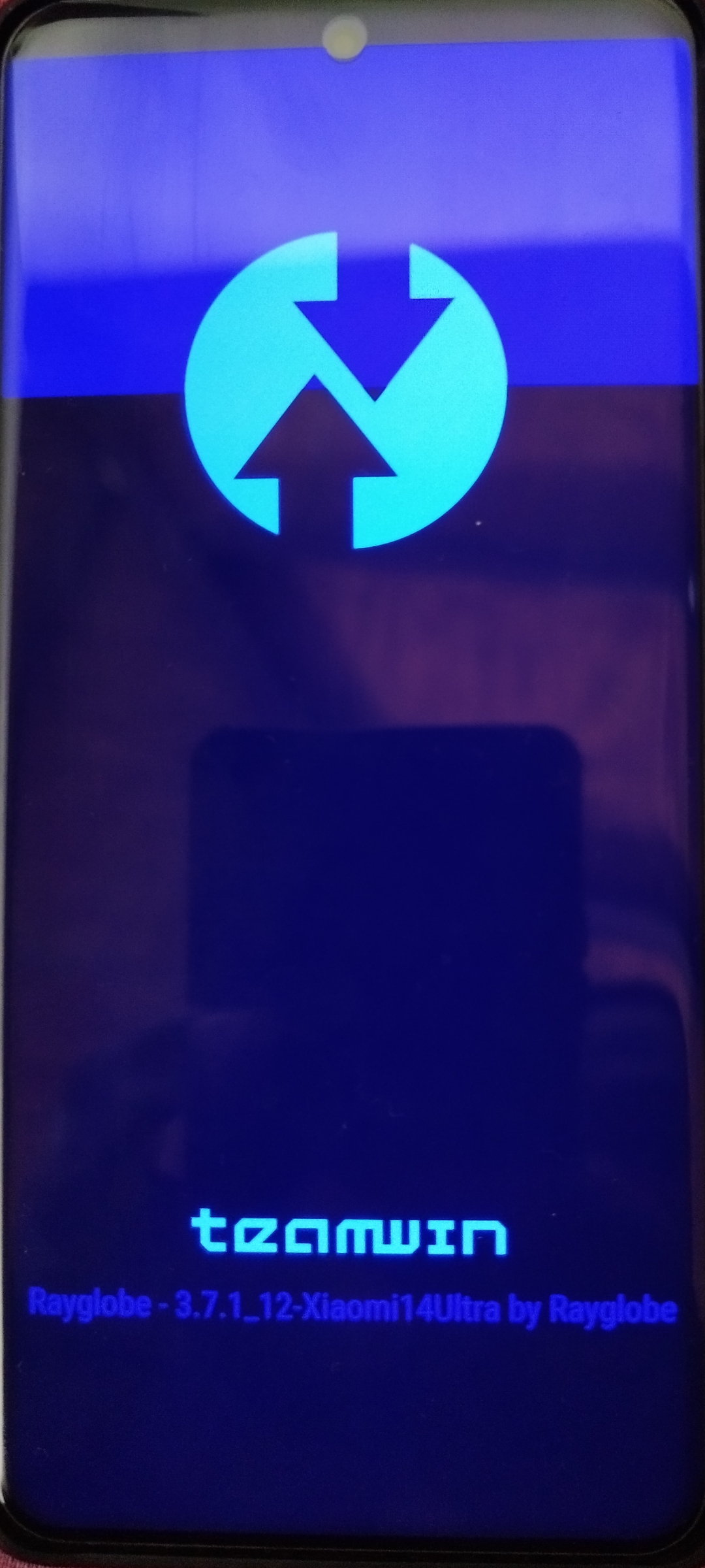

I tried it and I get to the page for the recovery I see the logo and image but nothing else also I get stuck in a bootloop to recovery unless I press keys to get back to fastboot I have the Xiaomi 14 ultra

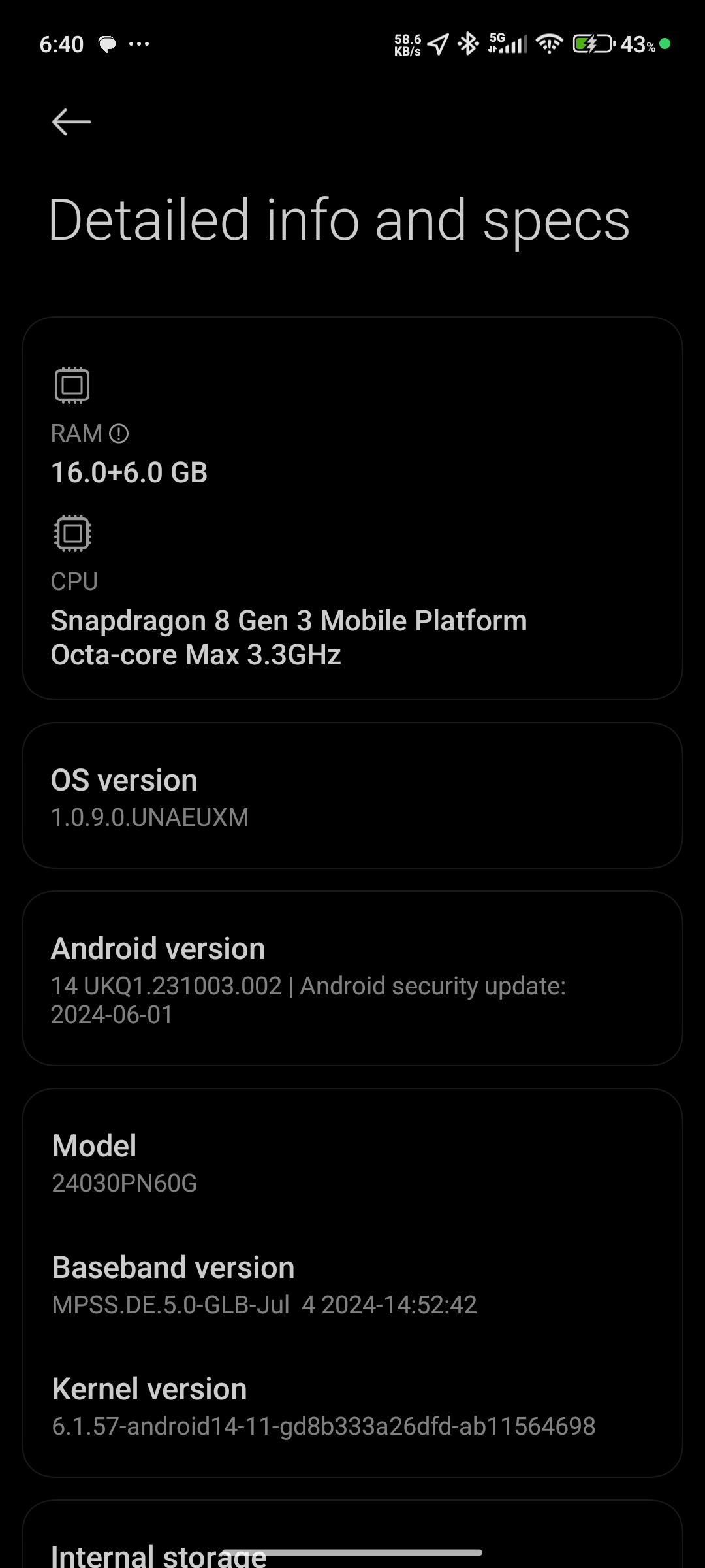

i can reboot no problem after flashing but as soon as i try to reboot to recovery i see the teamwin logo and at the bottom teamwin and recovery project 3.7.1_12-Xiaomi14Ultra by Rayglobe but nothing else and when i try to reboot again i get rebooted to recovery no matter what, also my rom is aurora_eea_global_images_OS1.0.9.0.UNAEUXM wich it came with I bought in in spain. the only way to fix the bootloop is to flash the original recovery and flash original boot.img again.
Also in adb shell i can see those folders wich i didnt see before booting into recovery from my phones root folder : twres, twrp_ramdisk-timestamp
finally before booting to recovery after my first reboot i could not see any of these two sub-directories in root explorer : sdcard/twrp directory and data/revovery directory
