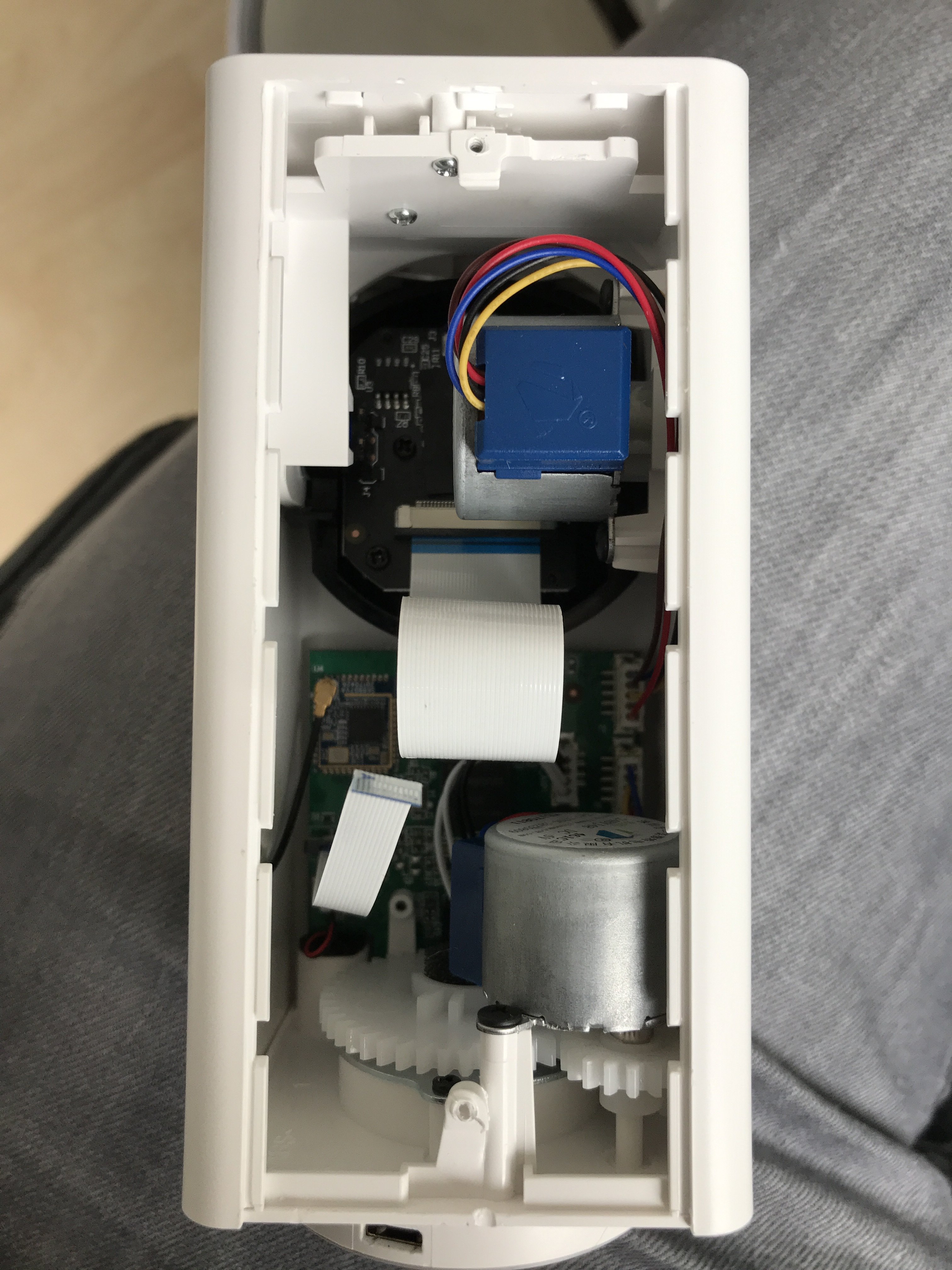

This is what the cam looks like from the inside. Very straight-forward construction, pretty clean too. I like it from an aesthetic point of view :)
I believe these are brushed motors, hence the “noise” they make (I don’t find it bad or bothersome at all).
