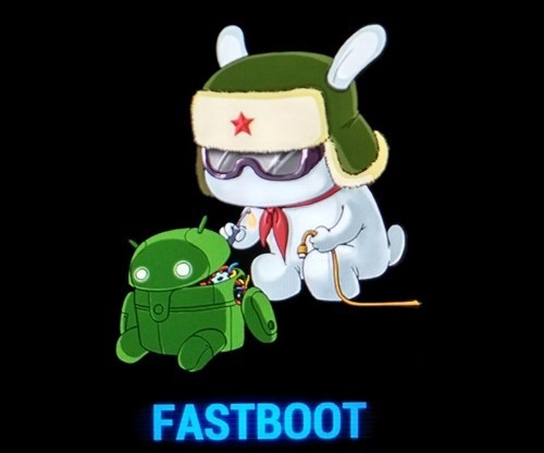

HI Guys
I have a Mi 11 with Chinese rom and wanted to install the Global rom on it.
unfortunately it didn't go through and stuck on Fastboot LOGO
I try to install original chinese rom and it success when I flash with Miflash but after that is same and stuck on Fastboot LOGO
I need your help to fix this problem.

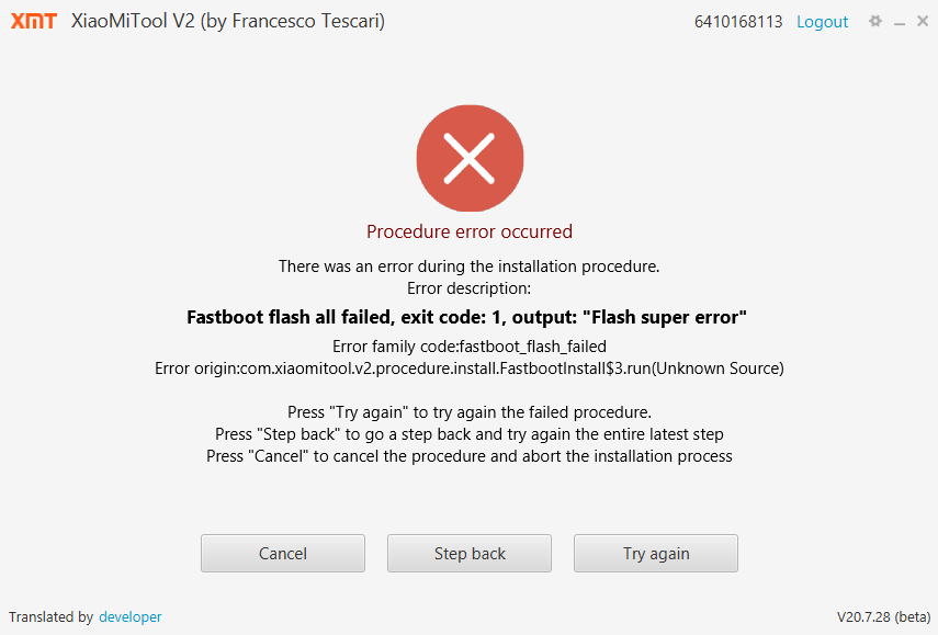

also I tried with XiaoMiToll V2(By Francesco Tescari) and it give me error which I will attach the screenshots here
Please help me to fix this problem .Thanks

The flash did not complete. It has not flashed the super image. This can happen with some versions of tools and fastboot packages. Easy to fix, change the fastboot.exe file from another tool or download. Then flash again using tool or from command prompt.
Could you please explain more? Thanks
In your screenshot it says that it could not flash the super image file. That's why it is not completing and returning to fastboot.
You may have a corrupted image or, and what happened to the 10 ultra first EU fastboot ROM, the version of fastboot.exe was to blame. It flashed everything except the super.img file. A simple change to a different fastboot.exe worked ok. I know it odd but do a search back in Sep on the 10 ultra pages in the forum. Try a fastboot.exe from any different adb package or try the one I used and saved to my mega page below.
I'm not saying it will fix it but it is worth a try.

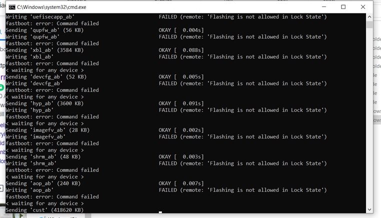

I've got my MI 11 today, it worked only 1h, I've applied OTA update to the latest fw and it went into fastboot. I've tried with vol up down and power, with fastboot reboot nothing, it is stuck in fastboot. Anyone knows is there any solution for this? Bootloader is locked.
How did you get your bootloader unlocked if you've only had it an hour? Is it not new?
If it is unlocked, then flash the most recent fastboot ROM from this forums download page or from here, https://mifirm.net/model/venus.ttt
Sorry, bootloader is locked, wrongly typed. I'm not able to unlock it with Batch unlock tool due to error message "Please add your account in MIUI's Settings > Developer options > Mi unlock status" as I'm not able to reach the settings, the phone is a brick :(
Is there no way of getting to the stock recovery by holding power button until it switches off or reboots, then using pwr on with vol up? I would be surprised if the recovery is goosed. Have you tried one of the stock fastboot ROM from mifirm.net? It is worth a try using a PC and fastboot.
No, there's no way, it automatically goes to fastboot, I'm not able to switch it off. I've tried with latest stock firmware downloaded from MIUI site for global device. For every fastboot command it says that it is not allowed in Lock State: for example "Erase is not allowed in Lock State"
