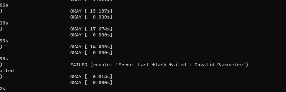

It appears it does not flash well. I briefly have the message : FAILED (remote : 'Error: Last flash failed : Invalid Parameter')
Searching Google to see what is it. I hope it's the reason i'm stuck...

Fastboot can be finicky. If you find nothing try reinstalling drivers and reflashing it until it flashes correctly

How strange it's always finicky at the same moment.
I put all the files on the desktop and reinstalled all the drivers and programs i had.
The flash went well, no error message. But the loop is still there...
I'll see with another version later

After you try the another version and it still doesn't work try flashing stock ROM (without locking the bootloader) and then xiaomi.eu
Reactions: serpico_as
Got out with the VEUXGV13090SKCMIXM
