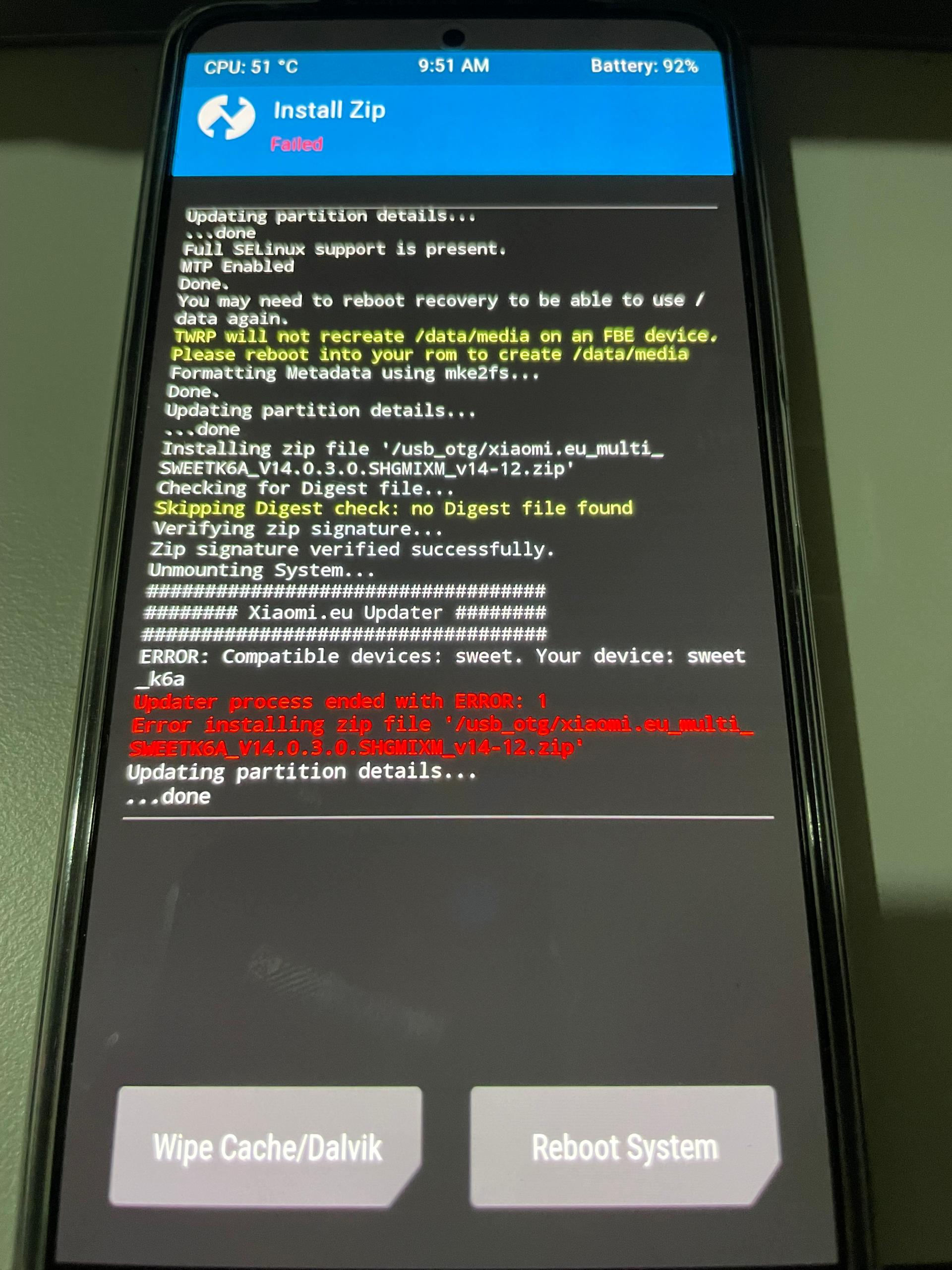

I can't install the rom.
I using Xiaomi Redmi Note 12 4G and I download the right rom.
TWRP also right.
All source file that I download is from this website.
Can someone help me, I cant flash any rom right now.

You need to edit the script in the zip file to include sweet_k6a instead of sweet.
Then it will work for u.
After u edit the script, make sure to update the zip file with updated script.
And then copy new zip to phone and flash.
All this, is assuming u have actually downloaded the correct ROM.
If not, the above will brick your phone...

Thank you for solutionI will try later...
I want to let you know that its work if I install using fastboot method"

Another option would be to delete the line that checks the phone model...
But again, if the rom doesn't fit, you will be bricked

Fastboot uses a different way of installing, makes sense.
When u use TWRP, it uses an installation script.
But if u installed with fastboot, then u're good

Looks like that TWRP's developer thought that an actual ro.product.device value of "sweet_k4a" exists, which is a mistake.
You can solve it like mentioned above, or report to the TWRP's developer to fix his code, or use another TWRP.

Okay but I cant find other TWRP for this device...
How can I change ro.product.device value ?

Hello again, Where can I find the script...
I already extact the zip file but I cant find script file'

Inside the folders, I can't remember by heart but it is under Android, maybe under meta, look inside the folders and u will find the script, there are 2 files, one is a binary one (do not change it) and the other is the script.

Inside the ROM's ZIP: META-INF/com/google/android/updater-script
On first line, change:
Code:
getprop("ro.product.device") == "sweet"
To:
Code:
getprop("ro.product.device") == "sweet_k6a"
