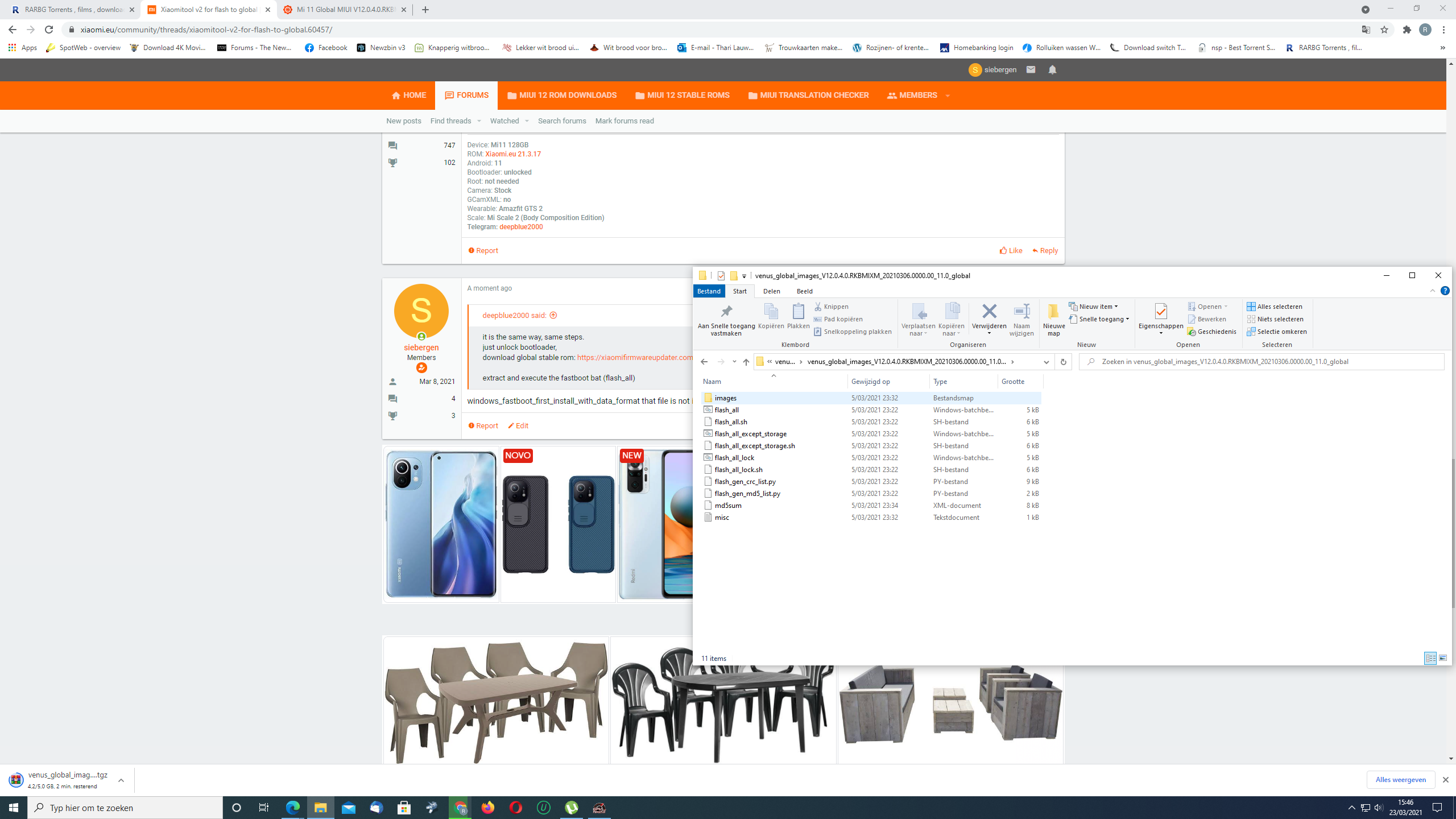

windows_fastboot_first_install_with_data_format that file is not in global how i fix this
look picture only that files are in global
what did I wrote ?
"execute the fastboot bat (flash_all)"
so you have to use flash_all.bat

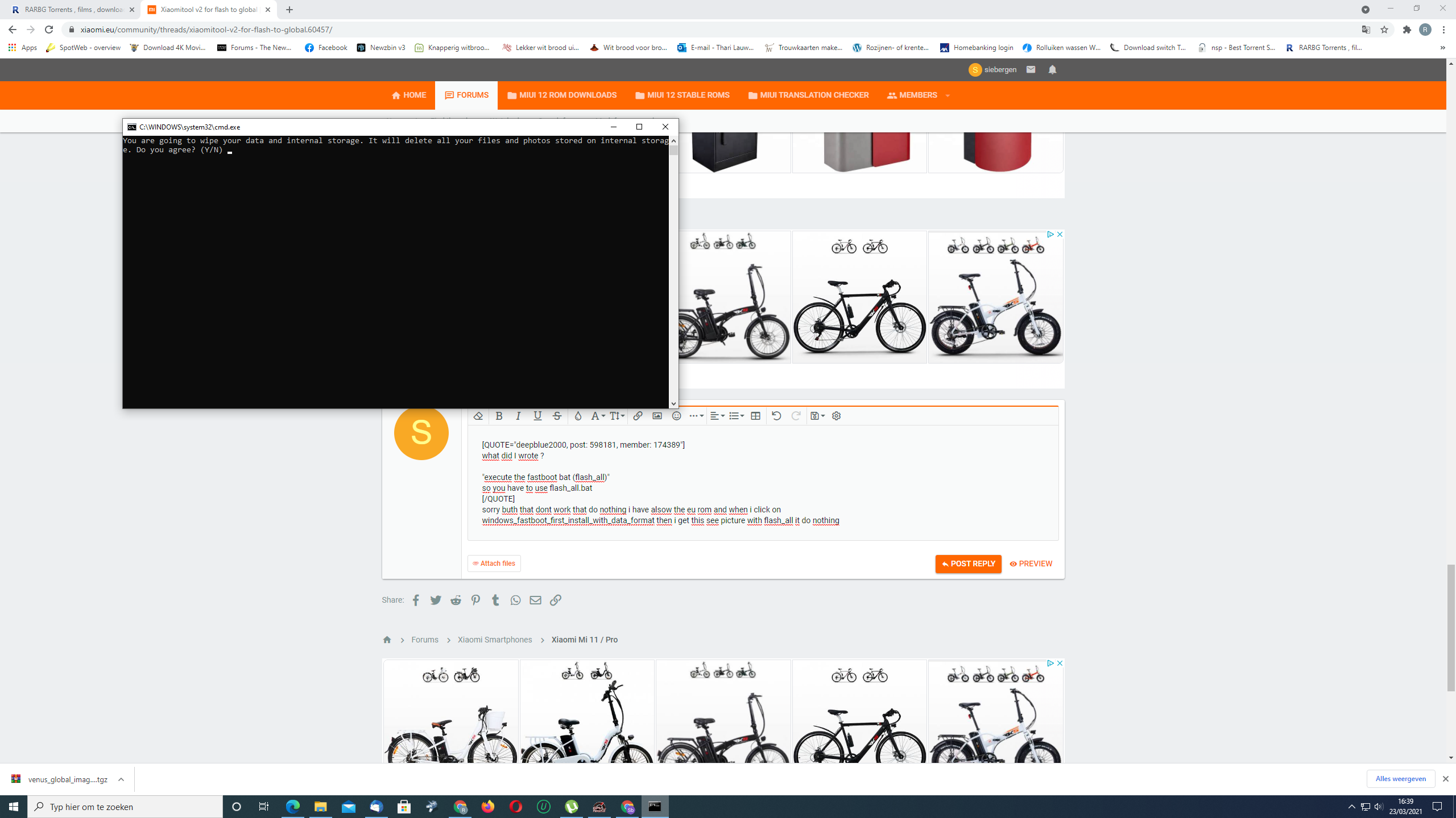

sorry buth that dont work that do nothing i have alsow the eu rom and when i click on
windows_fastboot_first_install_with_data_format then i get this see picture with flash_all it do nothing
