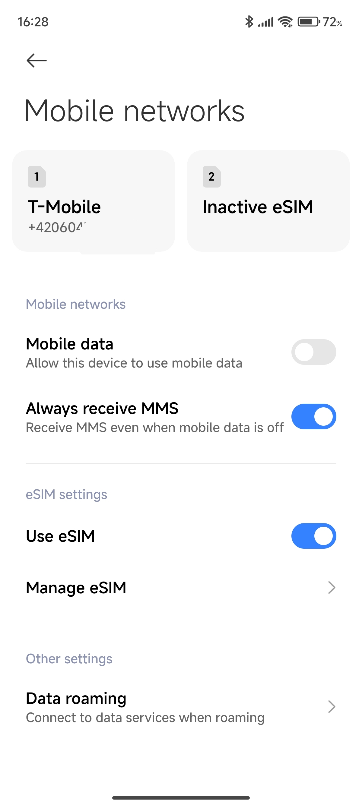

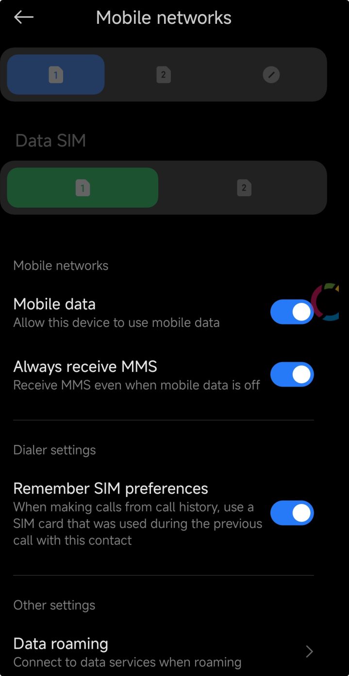

Hi all , esim menu is not here
ROM version: OS1.0.24.3.11.DEV
Model: Xiaomi 14 Codename: houji
i bought in india, but its a global version
i have tried to update my modem.img and modemfirmware.img with the global version AND also the indian version
but still no esim menu...
any idea what i can do?
ps : before flashing this rom, Esim was available 100% sure.

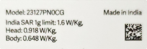

How do you know that you have the global version if you bought it in India?
Enter this command with ADB and reply with the result:
Code:
adb shell getprop ro.boot.hwc
Reactions: Kwanice
Code:
thanks for help
this model, i read that the G at the end should be for Global.
And the result of this adb command is IN for india ;)
If you have two active SIMs, you cannot use an eSIM at the same time.
Try using only one SIM in slot 1 >> reboot the device. If eSIM doesn't show >> try clean install ROM >> install global modem >> no root.
i never seen that esim should be used with only one sim card in the slot...they always said with one active sim, and my second simcard was not active.
but i tried with one sim card only, restart and it didnt work.
i need my root to backup my app, and if i can find a solution without clean install..i would prefer ;)
