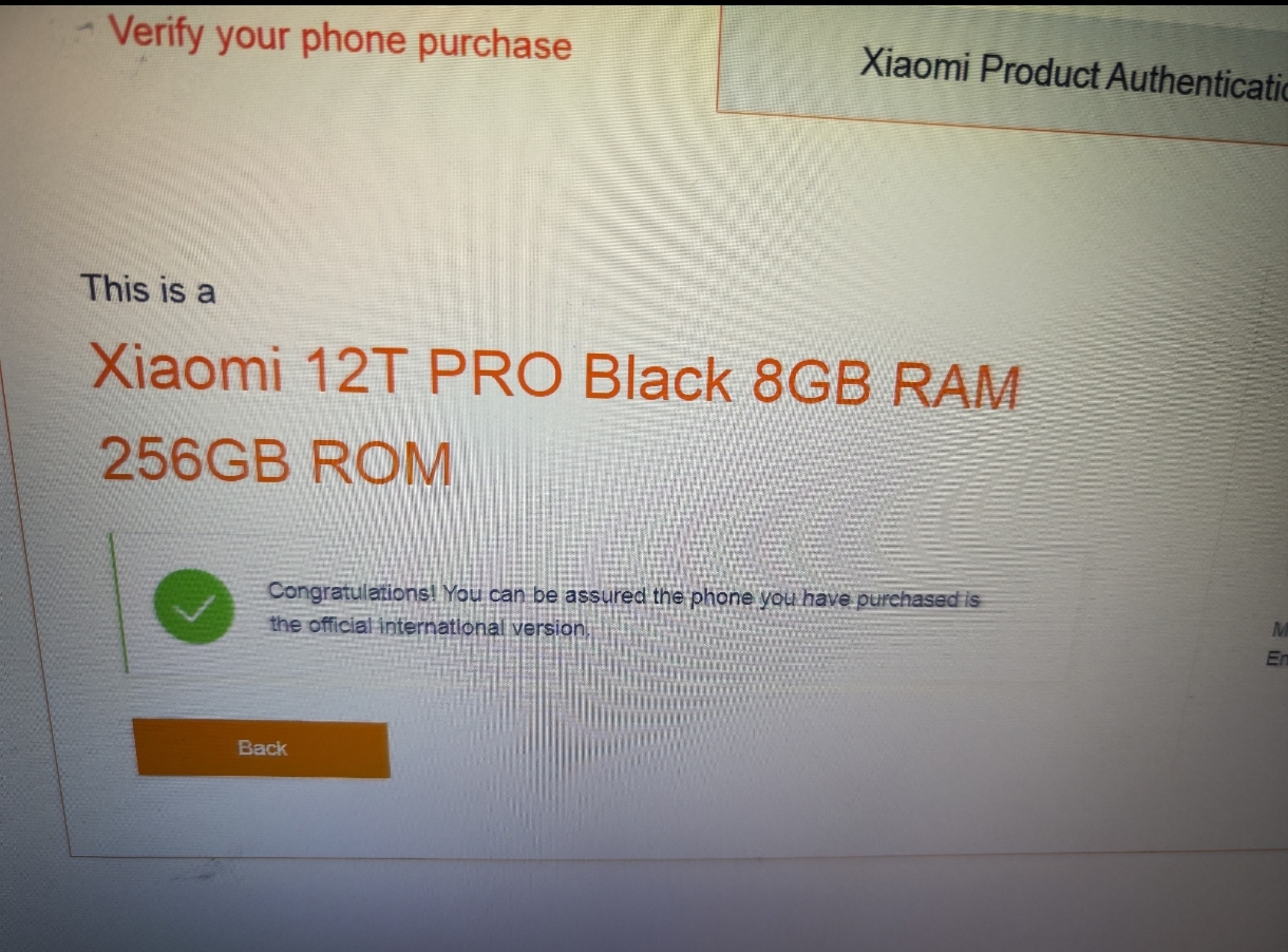

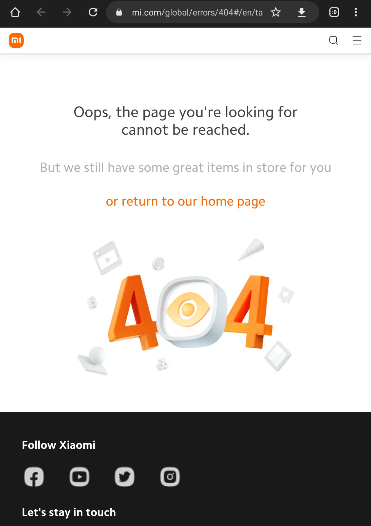

I get this 404 error on site you posted. Does it work for you?
It's probably global ROM since phone is from Germany.

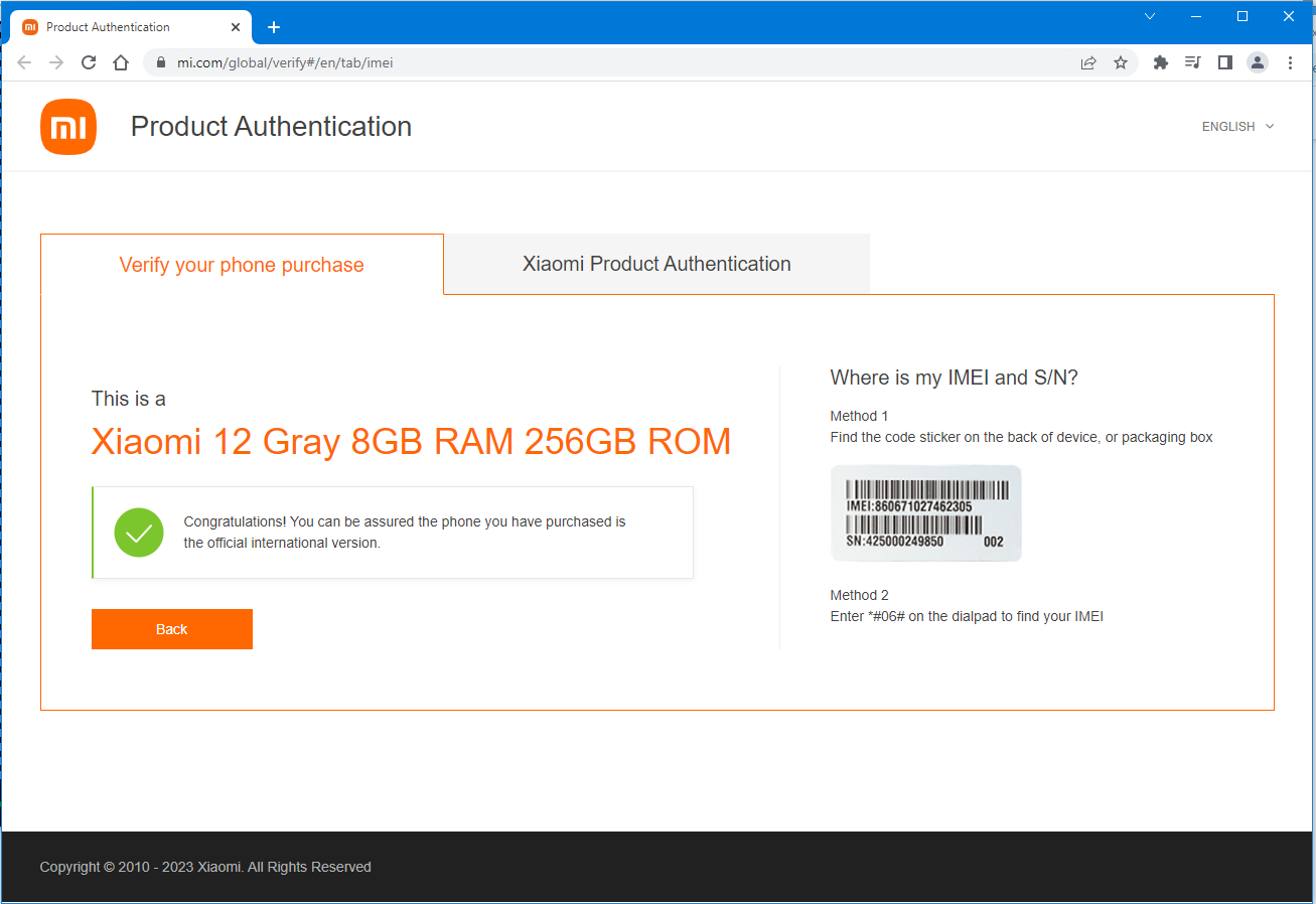

Yep, the address is correct, but you have to open it on a PC.
If you want to open the page on a browser from your mobile, try bellow steps:
1. copy the link in clipboard
2. open an incognito browser session
3. check the "Desktop site" (depending by your browser)
4. paste into browser address copied link from point 1
I get this. Can i relock bootloader with EEA Rom?

This means that:
- You can only lock a Chinese device with a Chinese ROM.
- You can lock Global devices with any Global ROM (EEA, RU, TW, TU, etc.).
EEA ROM is also Global (intended for EU) and you can lock the bootloader with it.

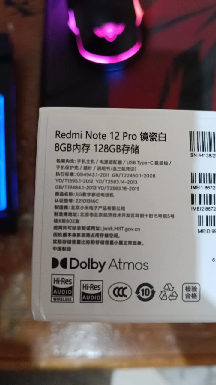

I bought a Mi 11 Ultra & discovered it was a chinese version.
It came with global MIUI & unlocked bootloader.
I was wondering if I can lock the bootloader like the pictures I posted (chinese device - global rom - locked bootloader)

Device CN > Global ROM = under no circumstances try to lock the bootloader, the result would be:cihla.png
Install xiaomi.eu ROM if you want to use contactless payments and similar features with multi-language ROM.
Device CN > Global ROM = under no circumstances try to lock the bootloader, the result would be:View attachment 51318
