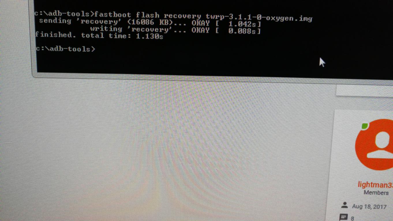

Here is a picture from CMD

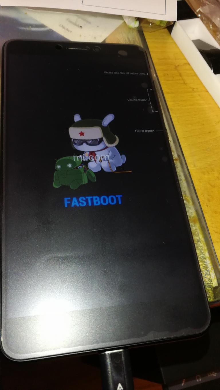

ok, you device is detected but it seems to be in recovery mode and not fastboot mode.
you need to have a screen like this :
fastboot devices
XXXXXX fastboot (XXXX is your phone serial number)
you probably need to change volume key, don't remember which one is needed but adb device command will tell you.
When you phone will be connected and in fastboot mode, you will be able to flash recovery (you can't flash recovery in recovery mode)
good, new step ok.
so now, can you try to flash the file with command below (I assume you've got the file on your windows PC) ?
fastboot flash recovery twrp-3.1.1-0-oxygen.img
post the screenshot please, thanks in advance.

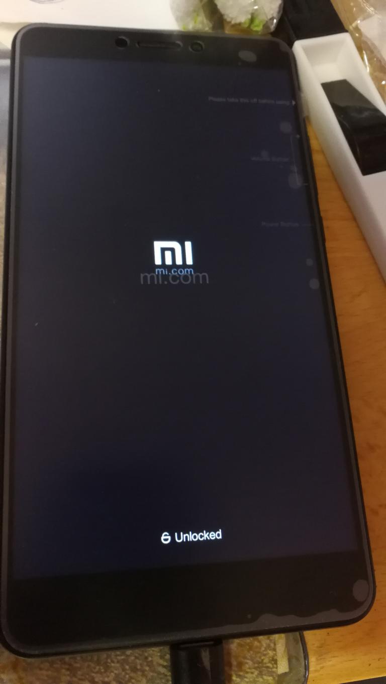

I make same you write.Only show me when it restart black screen with the Logo unlocked
Which ROM did you use, maybe that's the problem? You have to enter TWRP first by selecting key combination and there in the manu select Flash .zip or similar...
