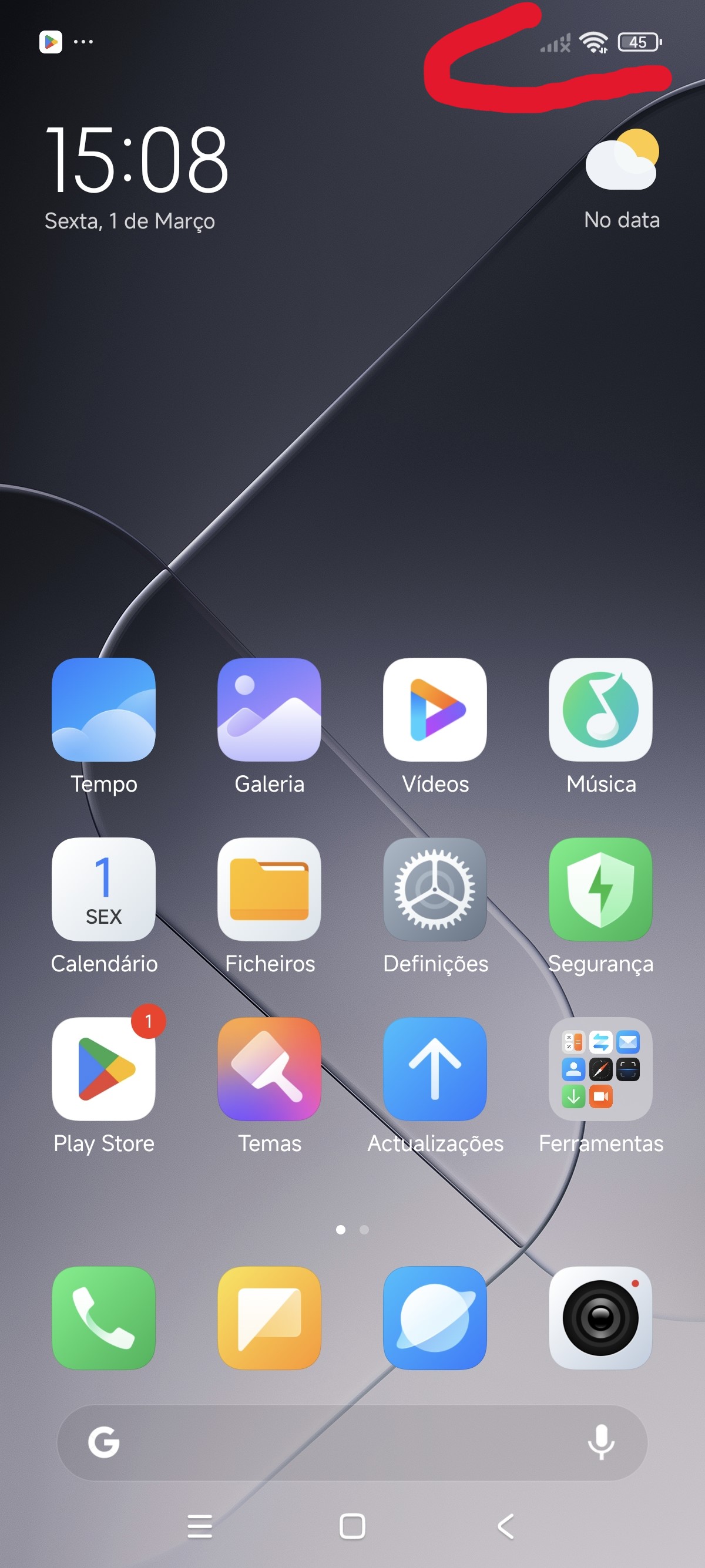

Hi community,
It seems that global units released this week are having problems with SIM card. SIM card on xiaomi.eu ROMs is disable (No service). I’ve flash into the original ROM and have no problems. I Can assume that is something related with weekly or stable ROMs here (Both tested, and problem persists). I also tried to flash modem.img from EEA ROM with no success. Anyone sharing the same problem?
Would appreciate some help.

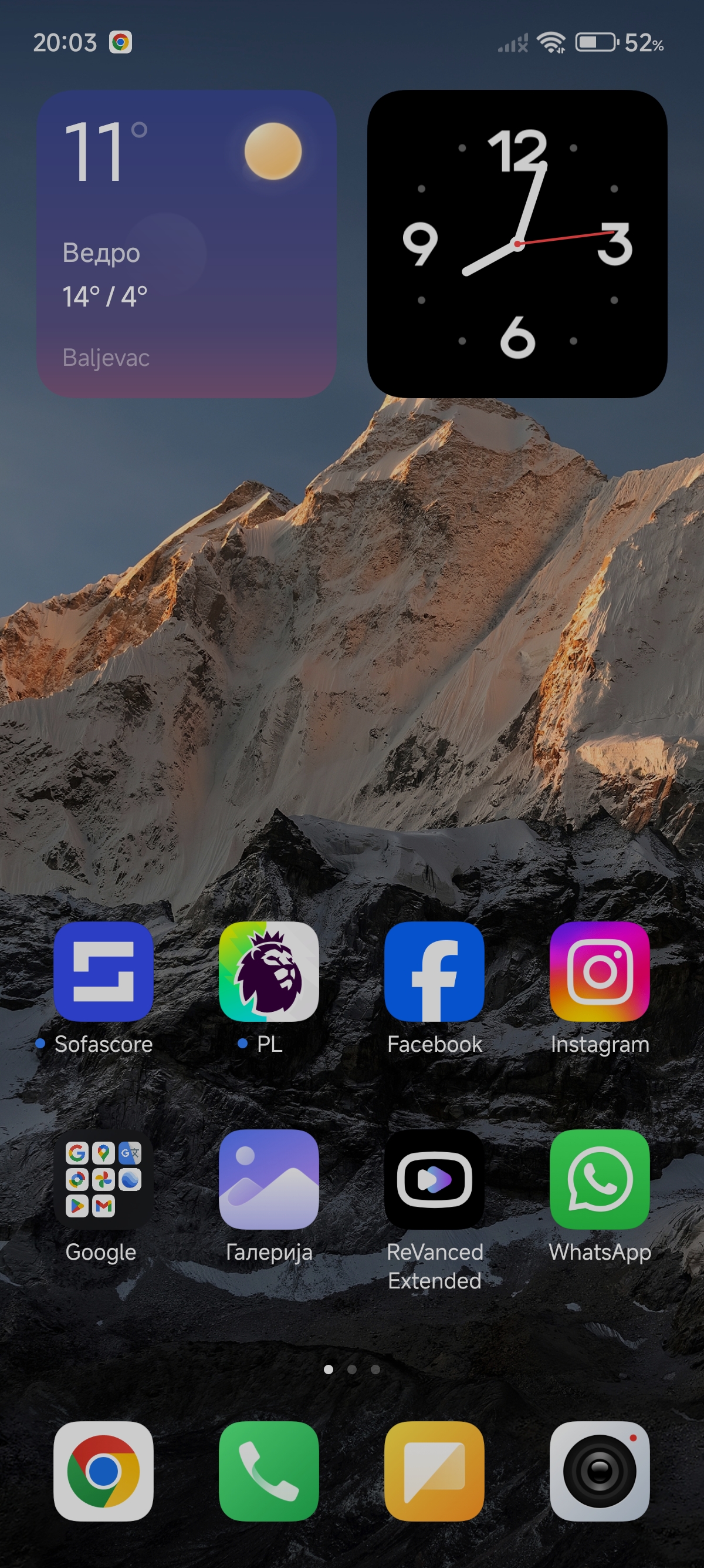

I also install Xiaomi 14 eu rom named houji, same problem. Can you tell me how to fix thia with your method, Sry for bad English.
