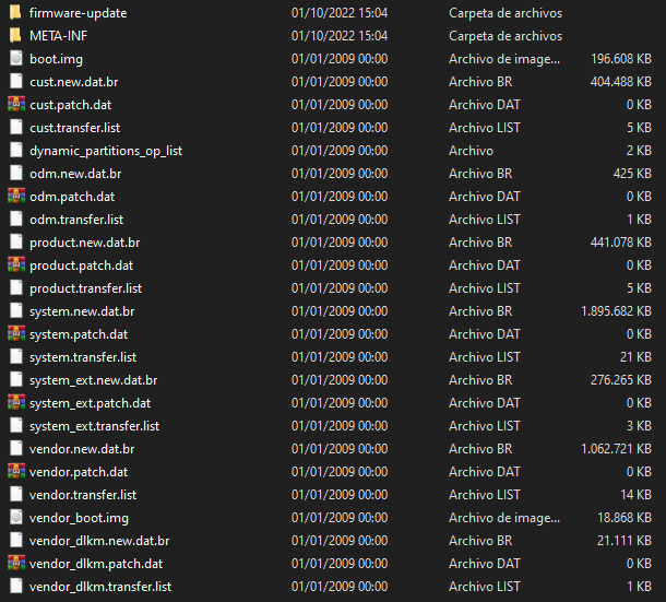

Hello, I have a Xiaomi 12 and in the phone settings it tells me that I must update it. So when I download the update from the computer and unzip the file, the .bat files do not appear anywhere, instead, everything appears completely different. I attach a screenshot of the unzipped folder to see if you can help me, thanks.
