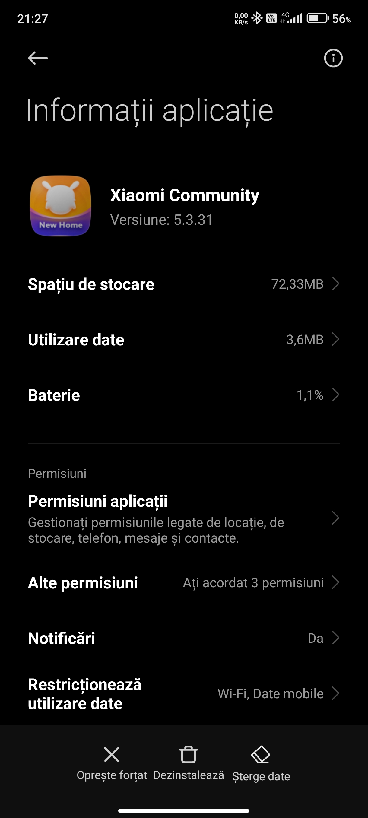

First, if you haven't installed it, install the xiaomi community application, version 3.5.31. I am attaching picture no. 1.

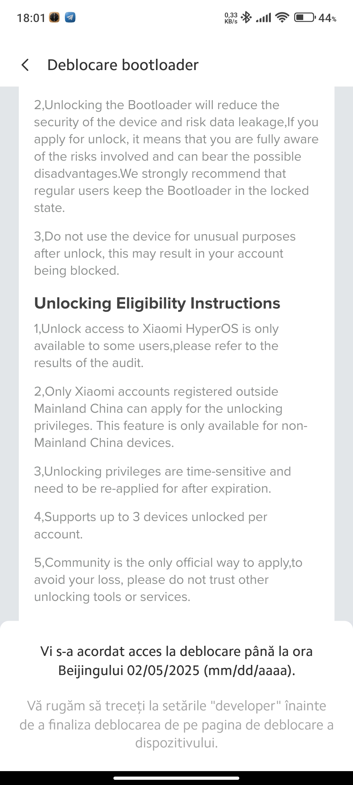

From the application, press the button to unlock the bootloader. Attached is photo 2.

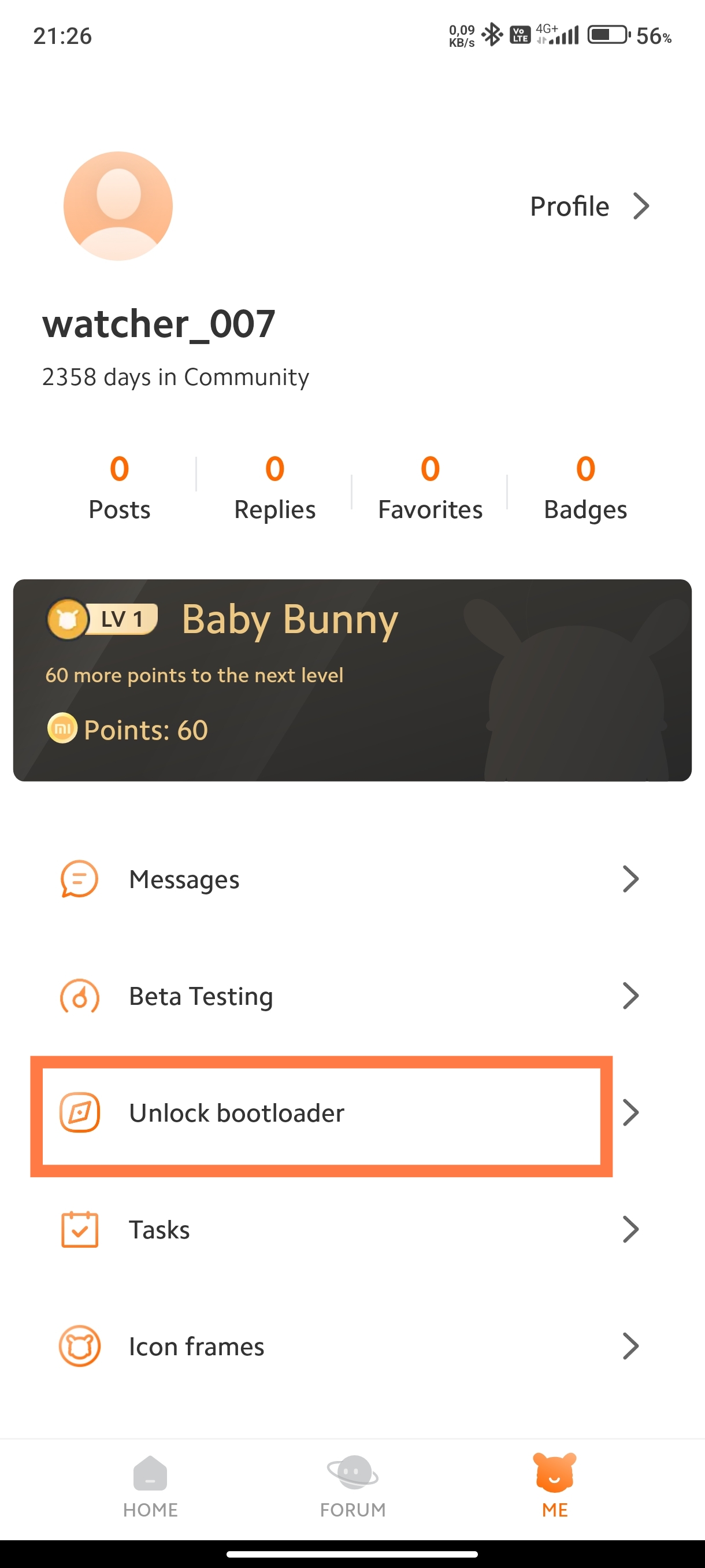

Several days in a row I tried to unlock it at different times of the day without success. Searching the internet, I found someone else's idea to try at 00.00 Beijing time.
I looked to see when it is 00:00 in Beijing compared to my local time and when I got 00:00 from Beijing it was 18:00, I pressed the unlock bootloader button and I was successful. I am attaching photo 3. Then go to the developer menu and link your xiaomi account on the phone.

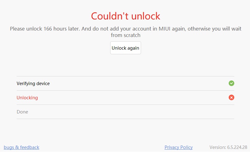

After the unlocking request was accepted, I tried unlocking the bootloader but I got the error that I have to wait 166 hours. I am attaching picture 4.

Все правильно. 1 В сообществе сяоми разрешение дали, но привязать учетку в телефоне никак не выходит. И отвязывал уже, и менял язык, и перезагружал. Пишет ошибку как на картинке.
in your picture it says to turn off wifi and turn on mobile data, then you can try to link xiaomi account
