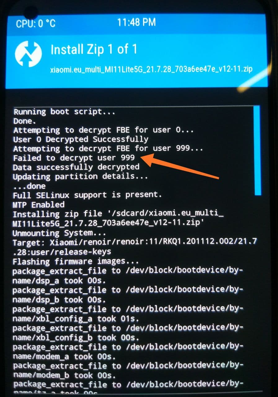

Only noticed a error in TWRP - Failed to decrypt user 999
Any ideas what this is?
Well known (discussed in other threads - like older weekly release threads), not only for your device/TWRP
If not using Second space or dual apps, don't worry
If using AND if you want to access that dual data from TWRP, you will need to search about or somebody else would repeat you the whole story
