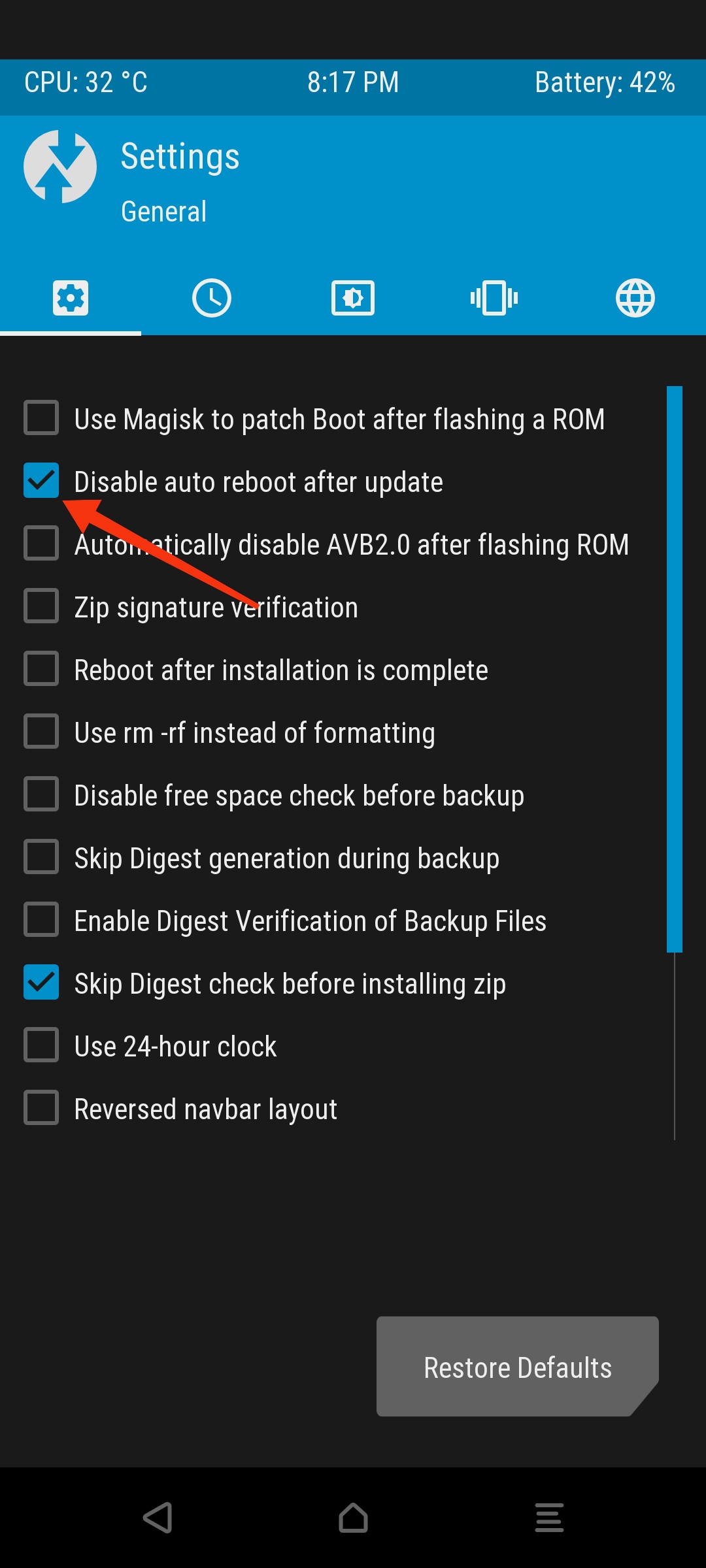

After each update in the TWRP step the automatic installation does not restart when finished. - Report
I'm running the TWRP SKKK from MIUI.eu's script and I noticed now that the option "disable auto reboot after updated" is selected by default. (annex)
What is the correct configuration to restart at the end? I would like to test it in the next update.
Regards,
