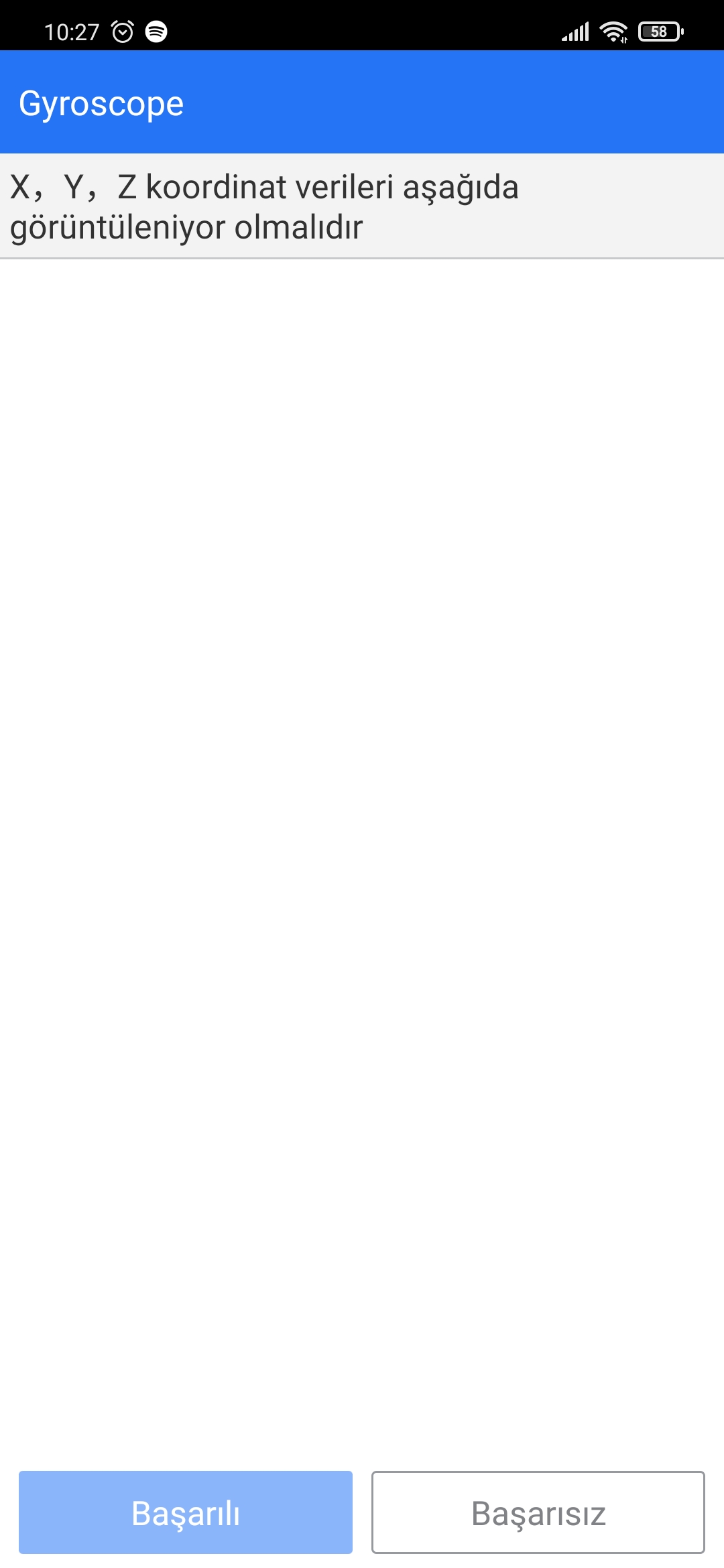

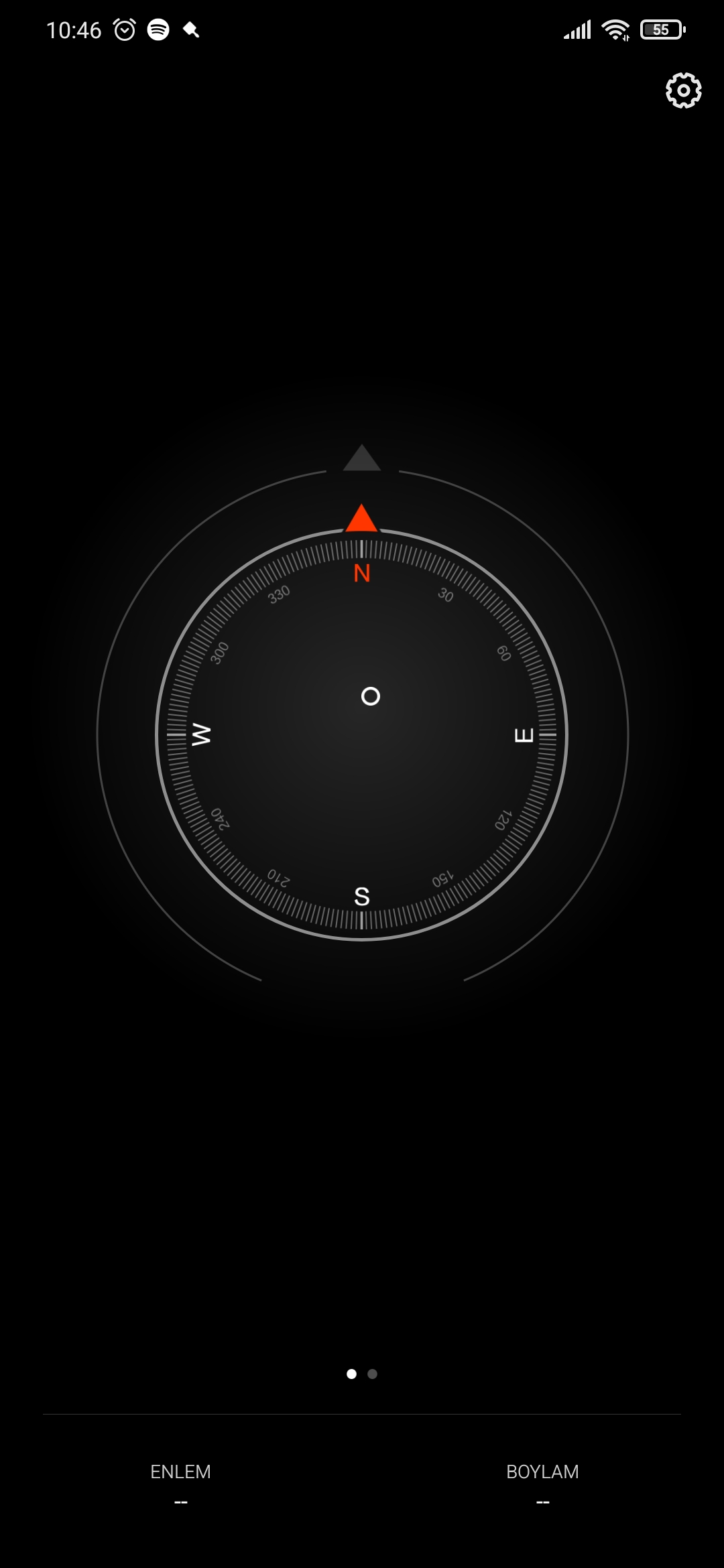

Screen rotate, Compass, Maps not working because has a sensor problem. My sensor is ok i m sure no problem in older version i check it. Problem version based 11.0.3.0QFAMIXM and 9.12.26/27 ROM my device is MI 9
View attachment 27845View attachment 27846
I lost sensors twice by flashing various non MIUI roms. I had to reflash persist.img to fix it.
You'll find it in raphael_eea_global_images_V11.0.3.0.QFKEUXM_20191029.0000.00_10.0_eea_80e1c5de81.tar

Thank you yes my device cepheus. I download rom and find my persist.img but i cant flash. Do you know any solution.
My bootloader unlocked. TWRP installed.
fastboot flash persist persist.img
Sending 'persist' (65536 KB) OKAY [ 1.405s]
Writing 'persist' FAILED (remote: 'Partition is write protected')
You could try in TWRP : Install, Install image then select your persist.img.
Twrp> advanced> file manager find persist.img but Twrp >install menu does not show persist.img. I can't understood but i find another solution yeah its work. You are write persist fix my problem.
Thank for helping. I so glad. Happy new year.
adb shell "dd if=/sdcard/persist.img of=/dev/block/bootdevice/by-name/persist"

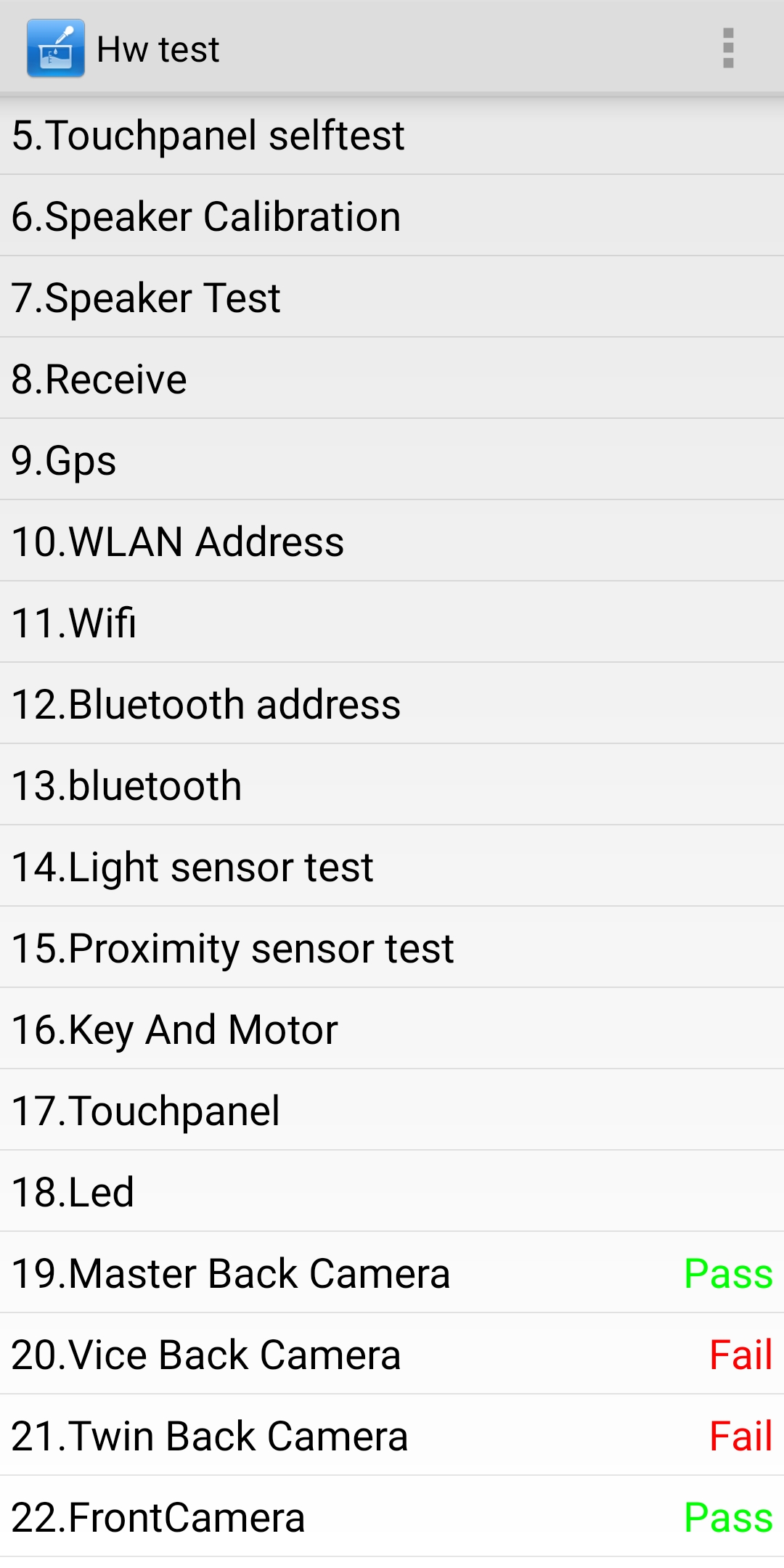

after this update some google cam apps stop working (works good before) and find i can't pass all the hw camera test (redmi note 5)
maybe it is someone to test....thanks
