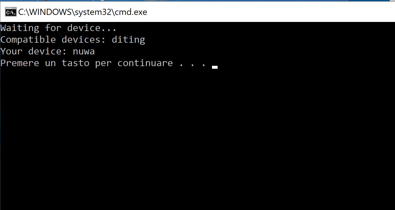

Just try to installa EU stable on my Xiaomi 13 Pro and get this message when running .bat file
Can someone help me?
Thank you

Are you installing a ROM designed for your device model?
diting = Xiaomi 12T Pro / Redmi K50 Ultra
nuwa = Xiaomi 13 Pro

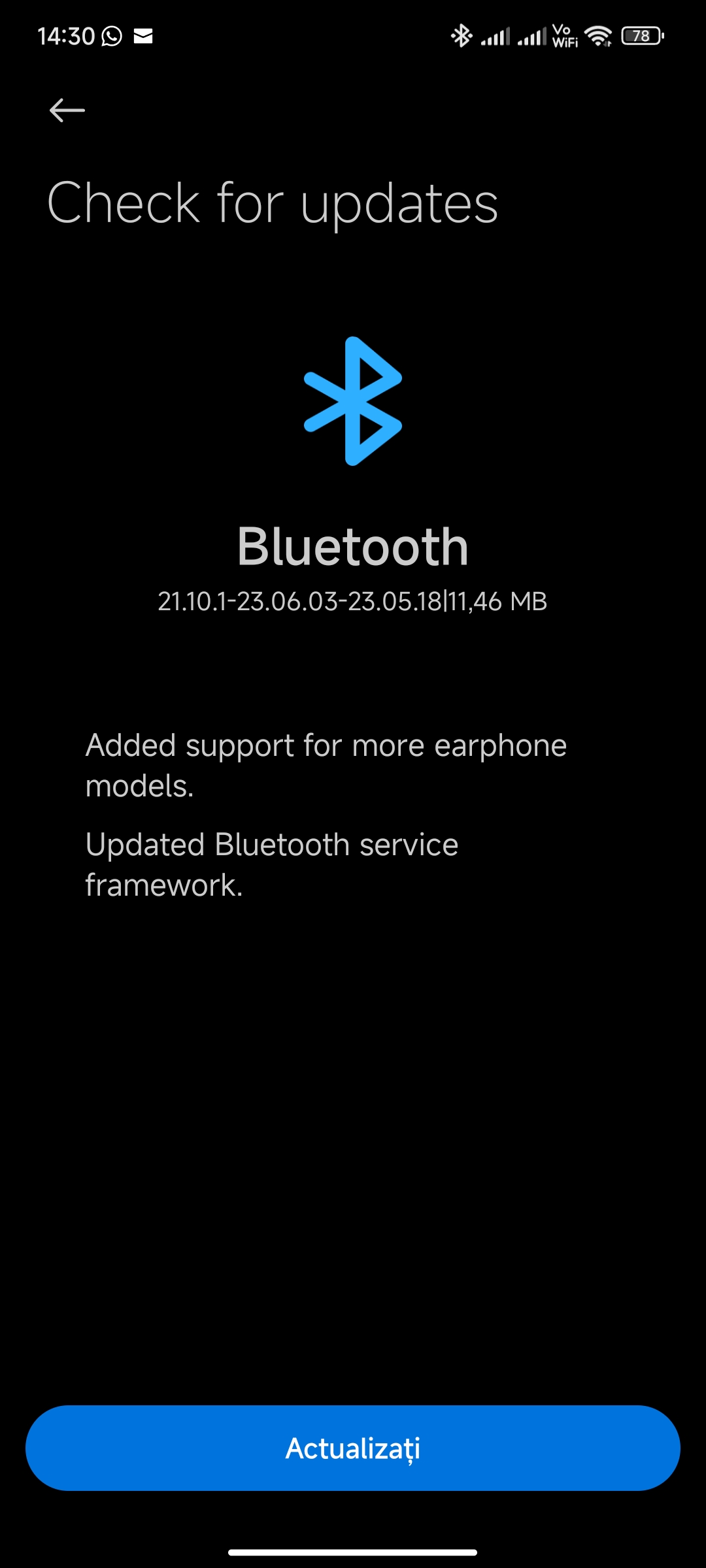

Thanks for replay. Another question, I received an update for bluetooth, how could I do it, it says that it is not connected to the server.
