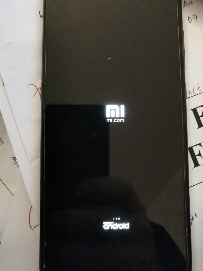

Hi there
i post it in a new topic...
the Mi 9 of my friend is blocked in starting mode...i mean black screen with a Mi logo + powerer by android and 3 points like loading but nothing happens.
She didn't add an mi account i supposed, no debbuging usb mode activated, or developper mode...nothing at all...
i supposed the crashed happen during a firmware update maybe and low battery turned it off...
i installed miassistant but it doesn't see the phone connected ...("no devices connected even")
i realized that when i turn the phone in "miassistant mode" the phone seems to be seen as "sideload" on adb... is it usefull?
i don't want to swao data cause it will delete some phone records that are very important for her...(with voice of her mother passed away).
is there any way to install new firmware without deleting data or to extract datas from the phone?
PLEASE HELP :'(

search in telegram for EDL / Unbrick / Authorized MI Account guys ...
Or try it by your own...
Keyword: PATCHED FIREHOSE FILE
Reactions: Romuald
If it can help here is what i have when i used the miflash program
AGMService.exe AGSService.exe Adobe CEF Helper.exe Adobe Desktop Service.exe AdobeIPCBroker.exe AdobeUpdateService.exe ApplicationFrameHost.exe AudialsNotifier.exe BdVpnService.exe CCXProcess.exe CCleaner64.exe CCleanerBrowserCrashHandler.exe CCleanerBrowserCrashHandler64.exe Calculator.exe CefSharp.BrowserSubprocess.exe Creative Cloud.exe Dashboard.Service.exe Dashboard.exe DiscoverySrv.exe EpicGamesLauncher.exe EpicWebHelper.exe HPPrintScanDoctorService.exe LockApp.exe Memory Compression MiPhoneHelper.exe MoUsoCoreWorker.exe Music.UI.exe NVDisplay.Container.exe OfficeClickToRun.exe OneDrive.exe ProductAgentService.exe Registry RtkNGUI64.exe RuntimeBroker.exe ScanToPCActivationApp.exe Scheduler.exe ScpService.exe ScpTrayApp.exe SearchApp.exe SearchFilterHost.exe SearchIndexer.exe SearchProtocolHost.exe SecurityHealthService.exe SecurityHealthSystray.exe SettingSyncHost.exe SgrmBroker.exe ShellExperienceHost.exe StartMenuExperienceHost.exe SwUSB.exe System SystemSettings.exe TextInputHost.exe UserOOBEBroker.exe Video.UI.exe WUDFHost.exe WmiPrvSE.exe YourPhone.exe [System Process] adb.exe armsvc.exe audiodg.exe bdagent.exe bdntwrk.exe bdredline.exe bdservicehost.exe bdvpnapp.exe conhost.exe csrss.exe ctfmon.exe dasHost.exe dllhost.exe dwm.exe ensserver.exe explorer.exe fontdrvhost.exe lsass.exe lync.exe miflash_unlock.exe node.exe runSW.exe services.exe sihost.exe smartscreen.exe smss.exe spoolsv.exe svchost.exe taskhostw.exe unsecapp.exe updatesrv.exe wininit.exe winlogon.exe
DEBUG <10:37:18.136,T:16292> : miflash_unlock start
DEBUG <10:37:18.684,T:13176> : auto refresh device list
DEBUG <10:37:18.699,T:13176> : use bus desp:MI 9 instead of Android ADB Interface
DEBUG <10:37:18.715,T:13176> : new usb\vid_18d1&pid_4e11\d9995836
INFO <10:37:18.715,T:13176> : fastboot devices
WARNING<10:37:24.212,T:16292> : account loading error:-21
DEBUG <10:37:24.946,T:16292> : [0]End: data:text/html,chromewebdata
DEBUG <10:37:25.261,T:13176> : auto refresh device list
DEBUG <10:37:25.268,T:13176> : use bus desp:MI 9 instead of Android ADB Interface
INFO <10:37:25.272,T:13176> : fastboot devices
ERROR <10:37:31.387,T:13168> : http get error code[curl]:6
INFO <10:37:48.319,T:1116> : new app version:6.5.406.31 url:http://miuirom.xiaomi.com/rom/u1106245679/6.5.406.31/miflash_unlock-en-6.5.406.31.zip
DEBUG <10:37:50.540,T:13176> : auto refresh device list
DEBUG <10:37:50.556,T:13176> : use desp:Android Bootloader Interface instead of Android
DEBUG <10:37:50.571,T:13176> : remove usb\vid_18d1&pid_4e11\d9995836
DEBUG <10:37:50.571,T:13176> : new usb\vid_18d1&pid_d00d\d9995836
INFO <10:37:50.571,T:13176> : fastboot devices
DEBUG <10:37:50.656,T:15372> : -s d9995836 oem device-info
DEBUG <10:37:50.756,T:15372> : ...
(bootloader) Verity mode: true
(bootloader) Device unlocked: false
(bootloader) Device critical unlocked: false
(bootloader) Charger screen enabled: false
OKAY [ 0.016s]
finished. total time: 0.016s
DEBUG <10:37:50.756,T:15372> : getvar product -s d9995836
DEBUG <10:37:50.841,T:15372> : product: cepheus
finished. total time: 0.000s
i tried to download files from devices but not sure of the path where the voice records are saved :
adb pull [-l] /internal share storage/MIUI/sound_recorder/call_rec/
adb pull [-l] /MIUI/sound_recorder/call_rec/
is the path correct?
