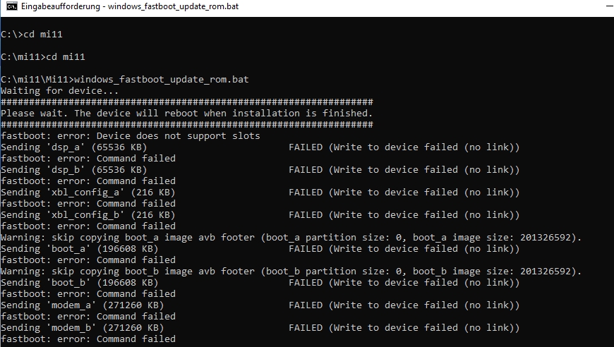

in the fastboot rom is a version of fastboot that dont recognize your device… if it is the correct rom version :)
check your device codename
# fastboot getvar product
But it doesnt matter. You have two options:
1.) copy the fastboot files from "c:\adb" to "c:\test\bin\windows"
2.) delete these lines in the fastboot*.bat file and save it
-> delete: for /f "tokens=2" %%D in ('%fastboot% %* getvar product 2^>^&1 ^| findstr /l /b /c:"product:"') do set device=%%D
-> delete: if "%device%" neq "venus" echo This package is for "venus" devices; this is a "%device%". & exit /B 1
Thanks for the advice, unfortunately it doesn't work.
I chose option 2., so I set a "rem" in front of those two lines.
Now it says the errors shown in the attached screenshot.
The errors continue, each time it says FAILED...
What can I do?
Overall I am quite disappointed, I did everything in the way it ist decribed. Is it possible, that I have to update former versions before?
To be sure: Did you mean I have to do BOTH options or are they truely optional, as I used only option 2?
In addition: What does the message mean "Device does not support slots" ? It seems that this is the problem.
