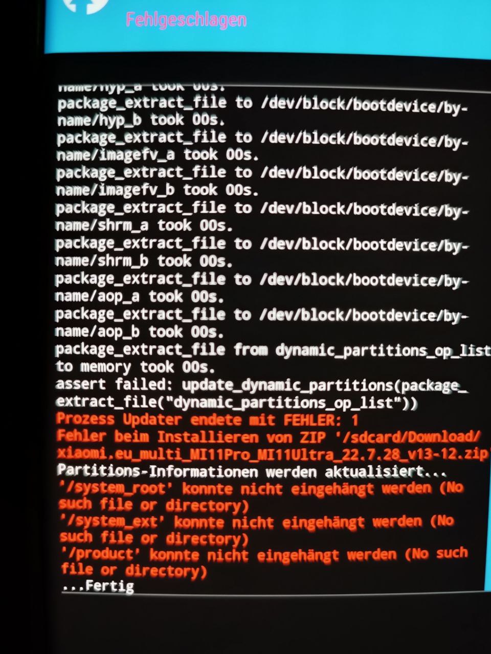

for my Mi 11 Pro can't install latest Rom zip.
It said:
Process Updater ended with ERROR: 1
Impossible to mount '/system_root', '/system_ext' and '/product'
Tried from Fastboot like "A partition" device guide said

did you start twrp from updater or reboot power on and volume + ?
I have the same issue. I try to start the TWRP from Updater, from the power off menu and with Power on and volume +. The result is the same. The last weeks no problems.
