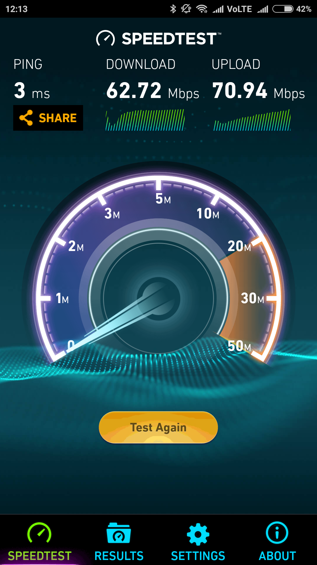

2.4 GHz Wifi - BT On - D: 63 U: 71 Mbps

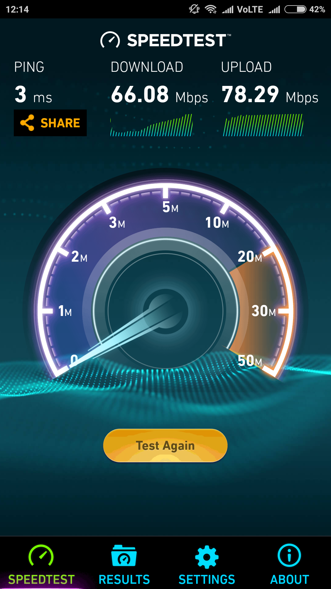

2.4 GHz Wifi - BT Off - D: 66 U: 78 Mbps

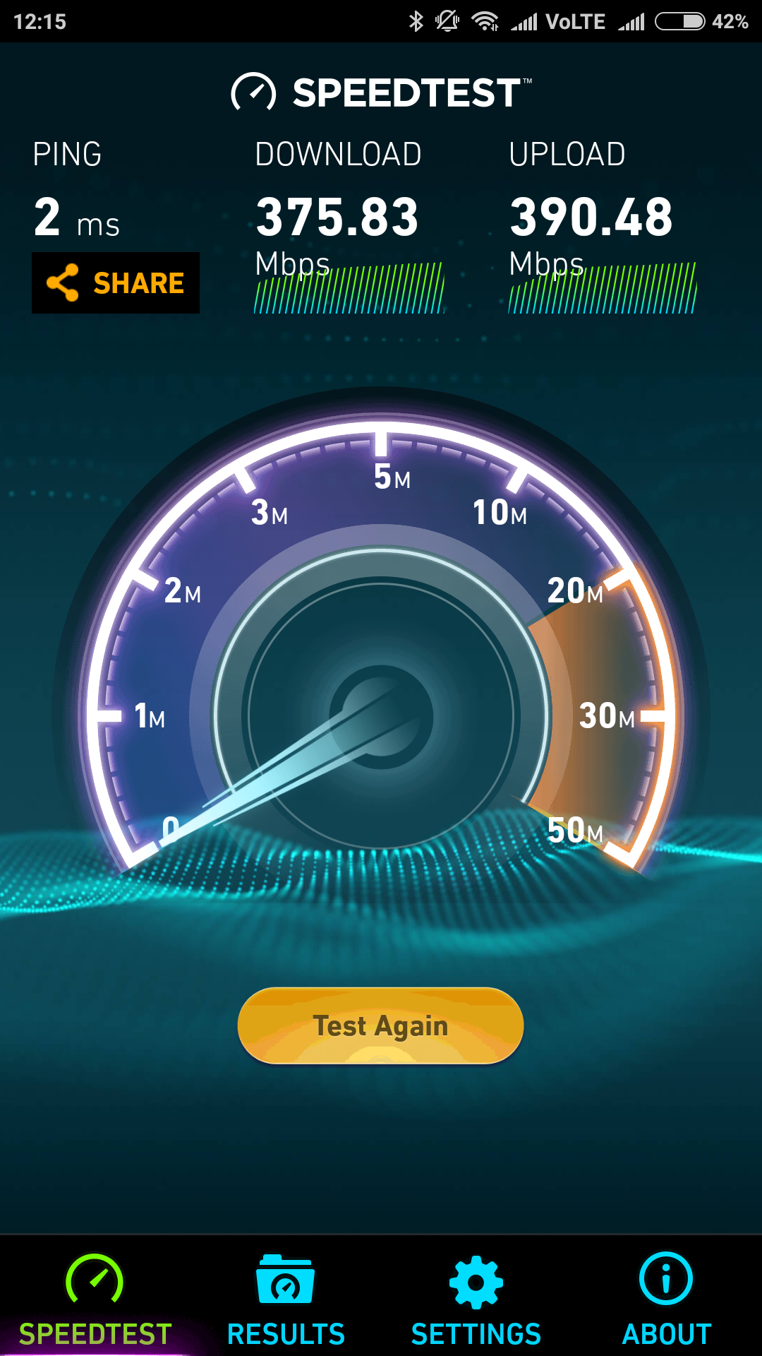

5.0 GHz Wifi - BT On - D: 376 U: 390 Mbps

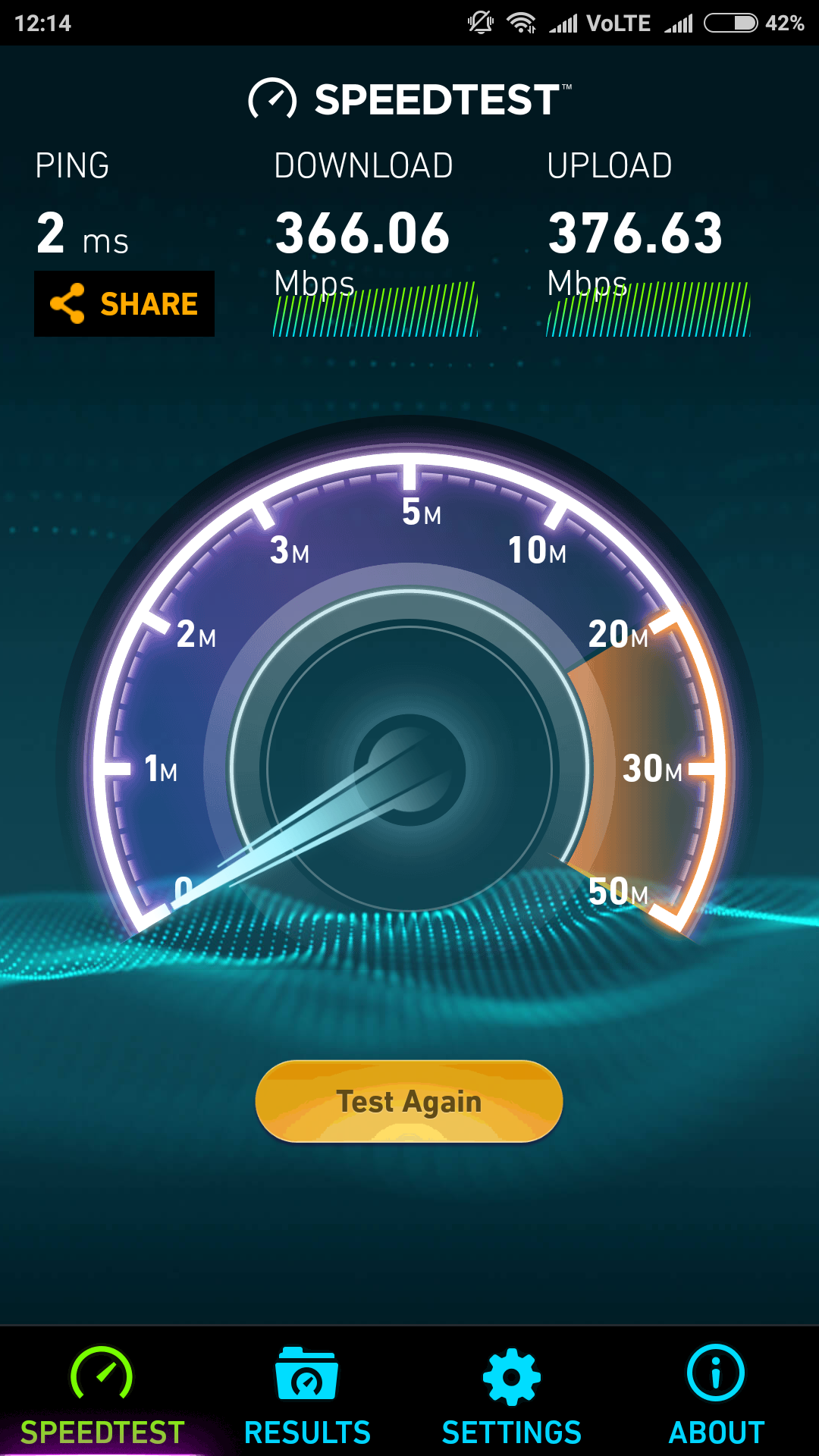

5.0 GHz Wifi - BT Off - D: 366 U: 376 Mbps
So, values are almost the same with BT ON or OFF (at least, on my Mi 6 and Huawei W1 watch )

It is interesting to note that the 5GHz WiFi throughput has increased when BT is on, not sure why that has occurred.
The 2.4GHz result is in line with expectations (assuming you had only a connection established, not with streaming, etc), it is dependent on the data volume being transferred - if you have a streaming HD video on BT, the WiFi drop would be much bigger.

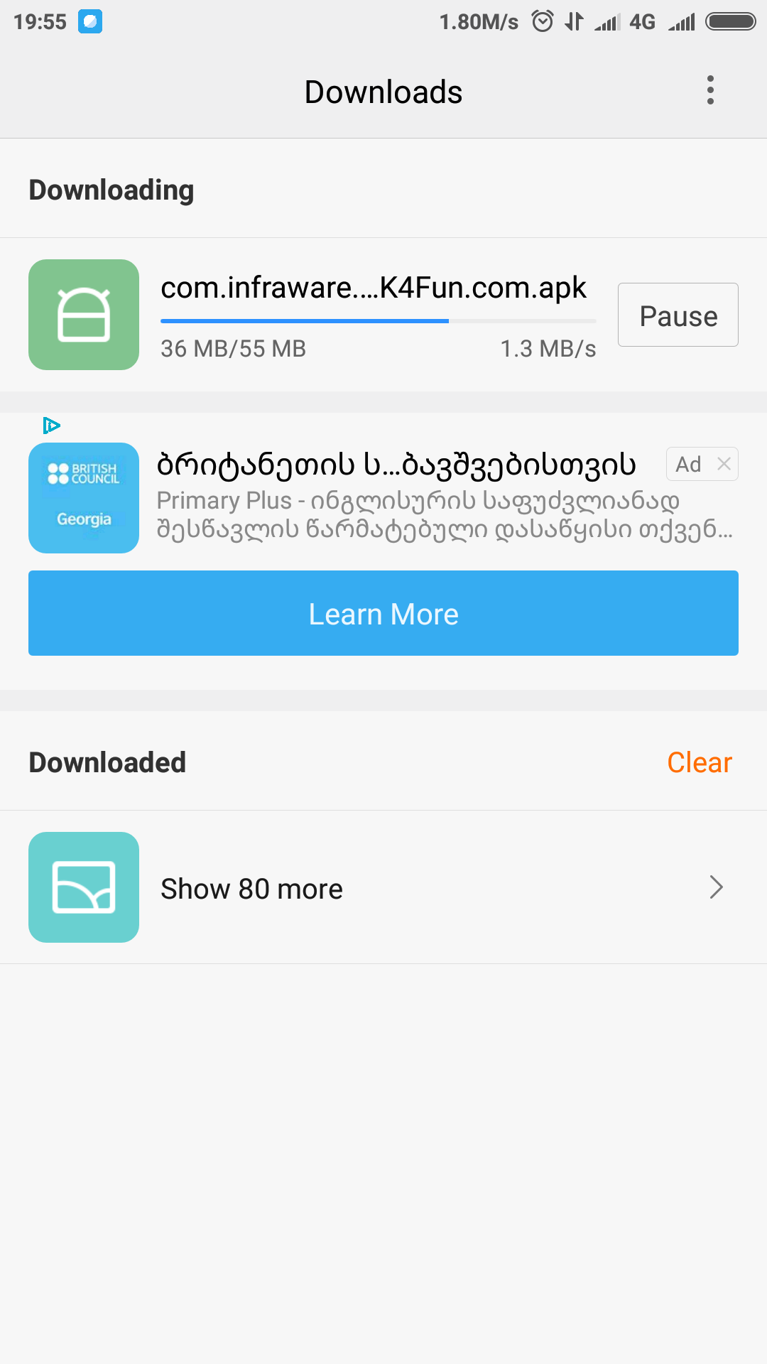

What this in the downloads?
