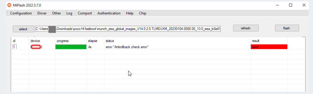

When using MiFlash 2022.5.7.0 I get 'error:"antirollback check error"'

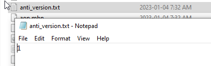

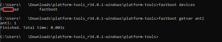

When I check the antirollback status of the ROM, it shows antiversion = 1. Checking this against my fastboot variable it matches my phone - anti:1

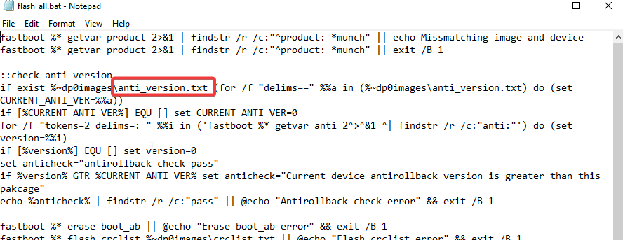

Does this mean I can safely remove the antiversion checking from the flash_all.bat file and flash without bricking my device?
Should I try an older version of MIflash before doing this?
