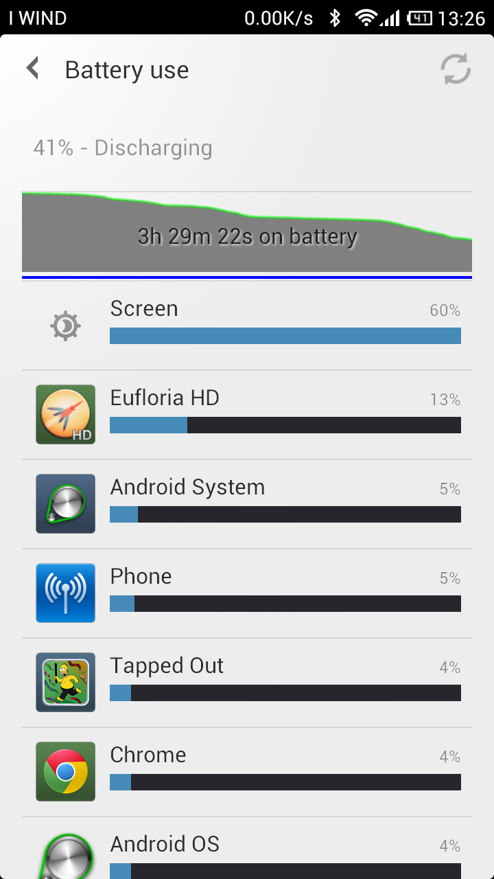

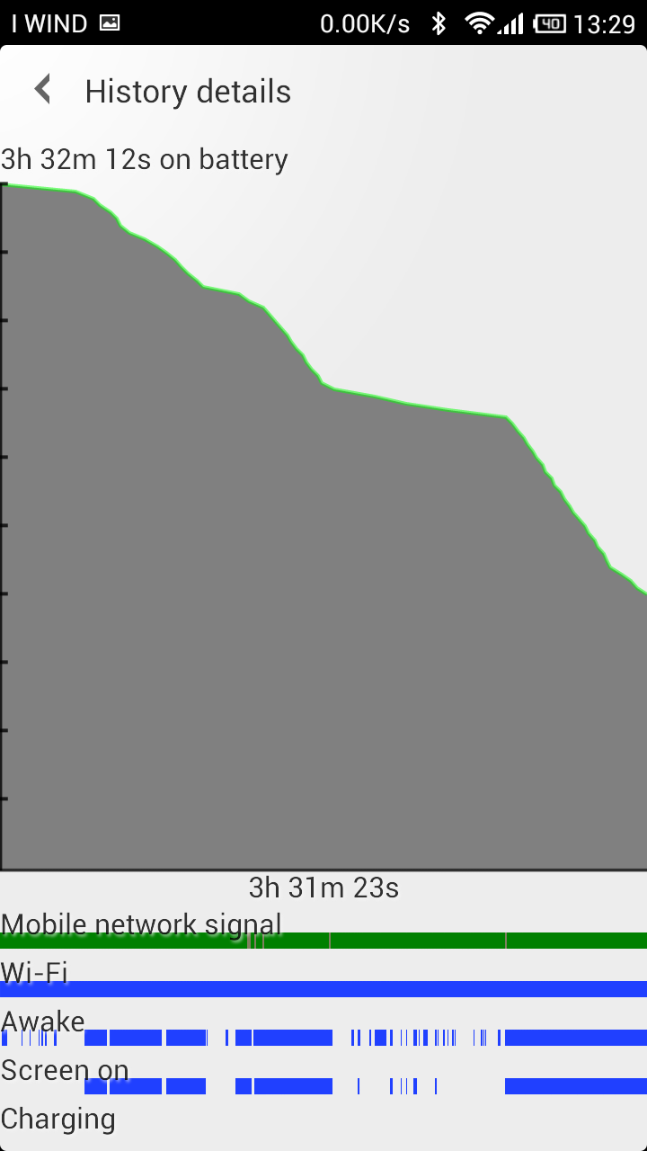

Just my two cents. That's performance mode, most of the time on wifi and brightness at low auto (didn't use it much in direct sunlight tho).

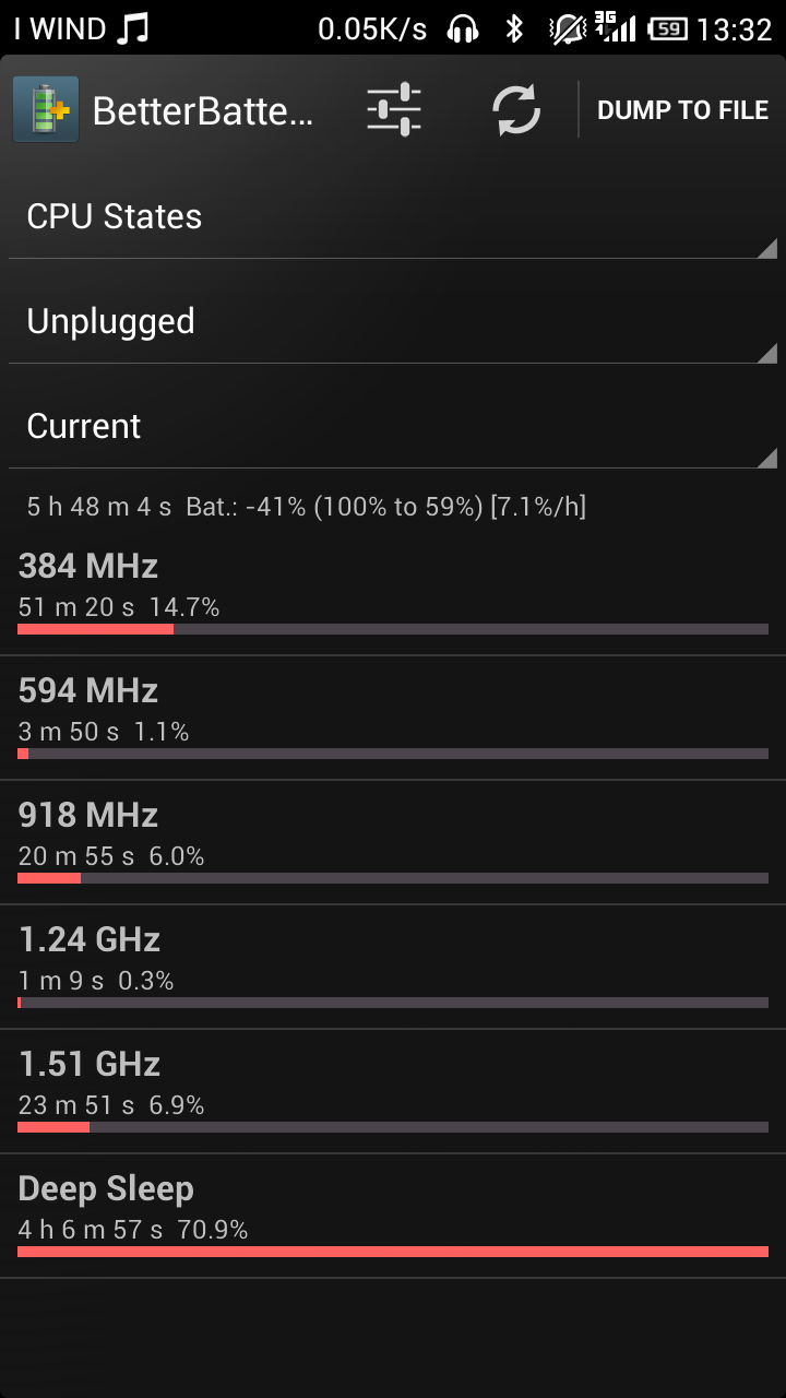

Sure, just take a look at the screenshot from betterbatterystats... Just for your knowledge ;)
I am on performance mode by the way.

Nearly half of your battery gone in just over 5 hours, with a little under 2 hours screen time.
It's only fact that performance mode drains your battery faster than any other option. Logic should be able to determine that alone.
But hey, your device, you do whatever you want with it to please your needs. :)

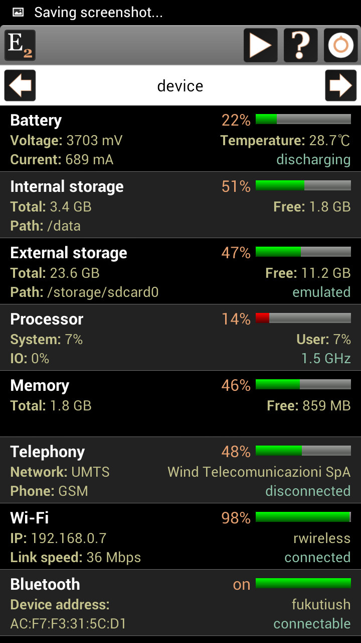

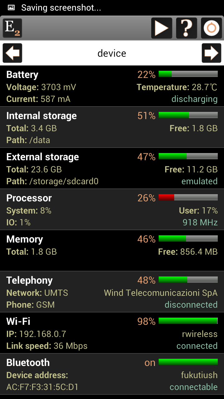

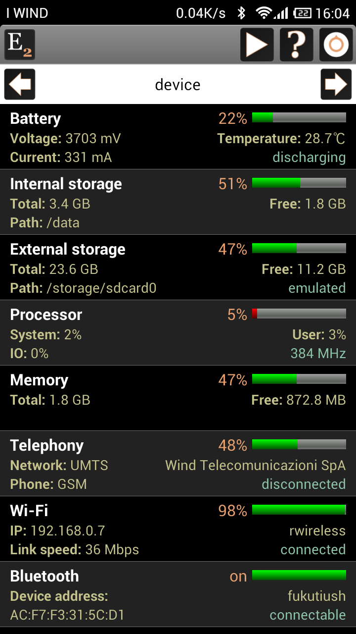

A sequence of 3 screenshots in a timespan of 5-6 seconds. I used elixir. I tried it myself. Now I'm wondering if you did the same...
edit: reuploaded the second screenshot.

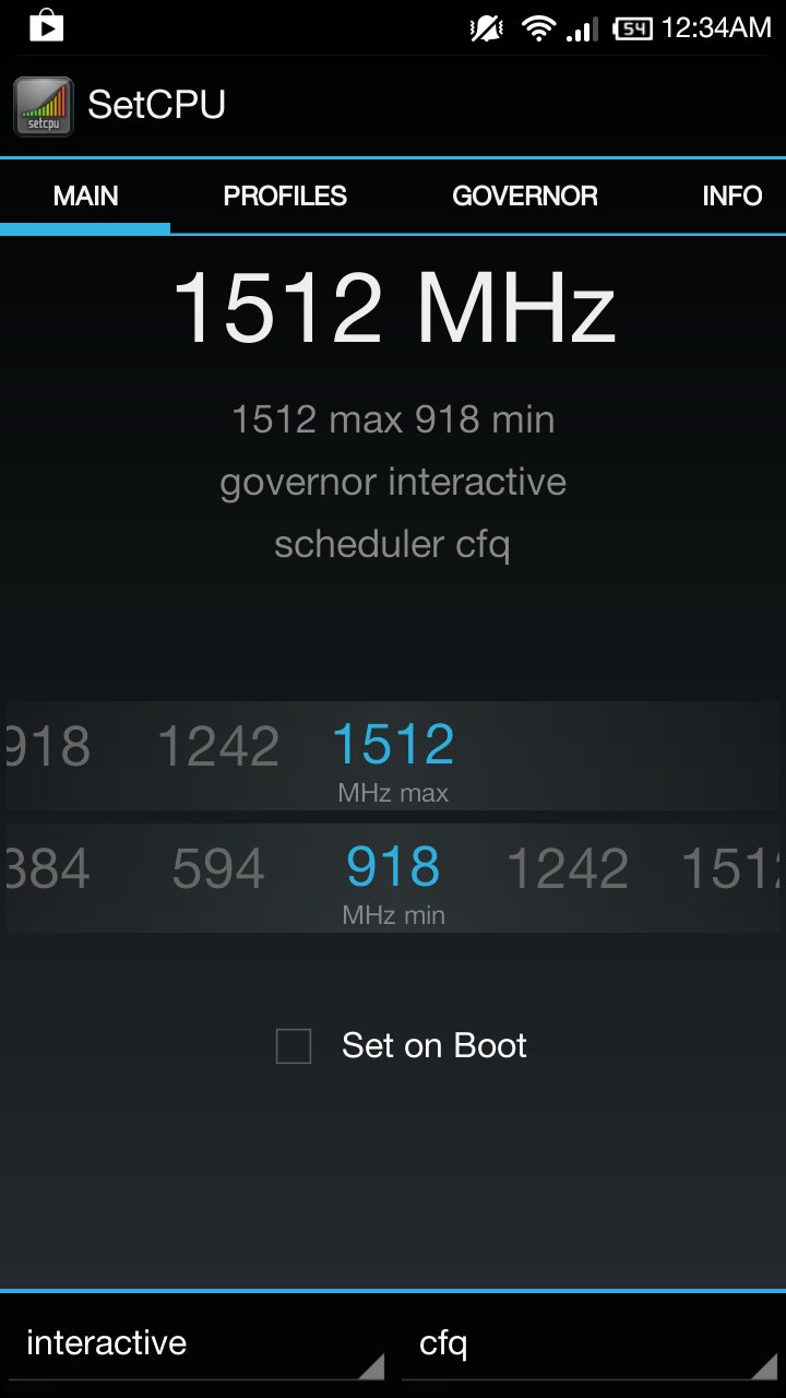

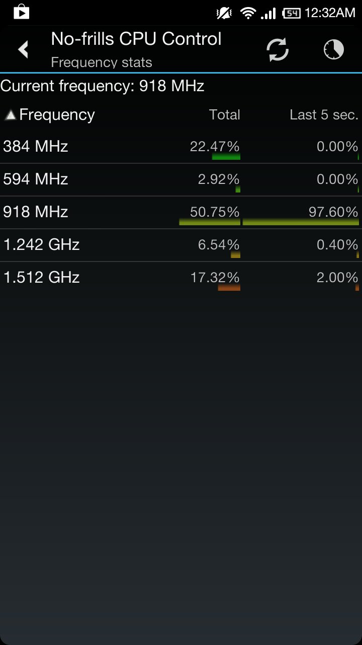

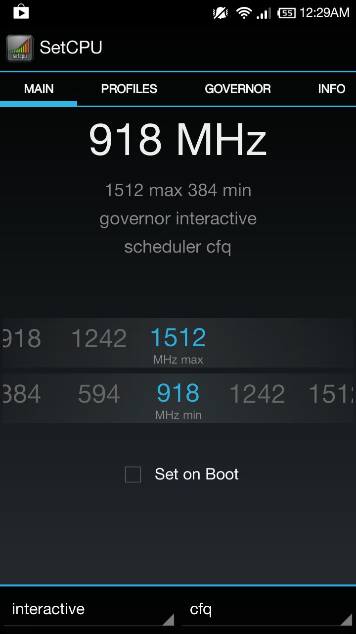

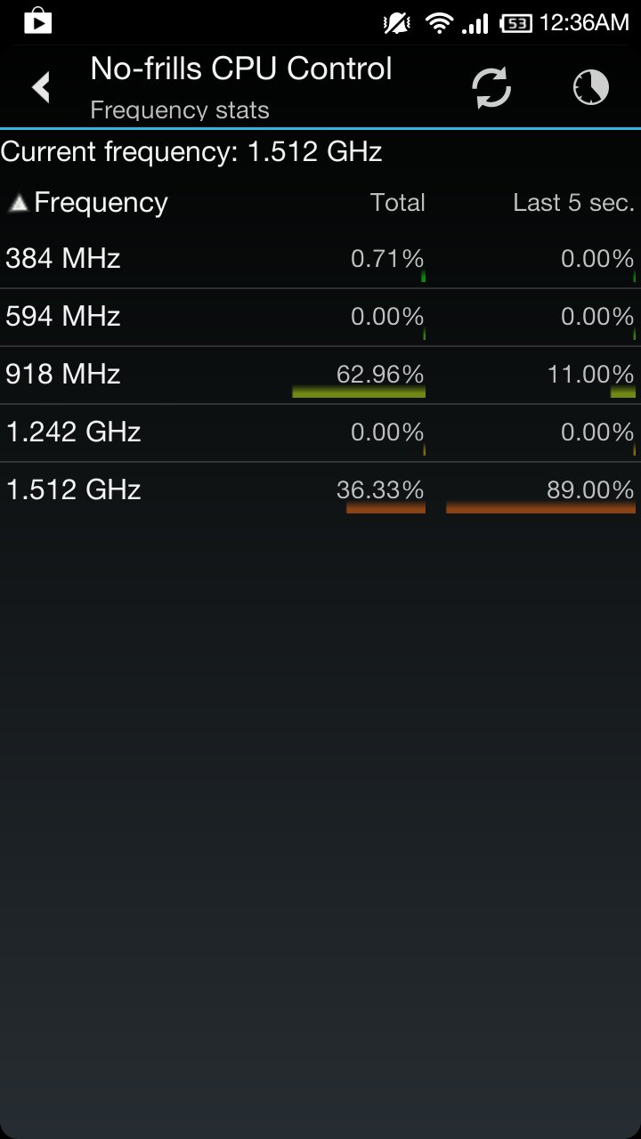

That is on performance, yes?
Here's a two pics on normal mode -
SetCPU: (states max and min clock right there, by default.)
No-Frills CPU Control:
And on performance mode - one on each.
Question: what ROM are you using?
