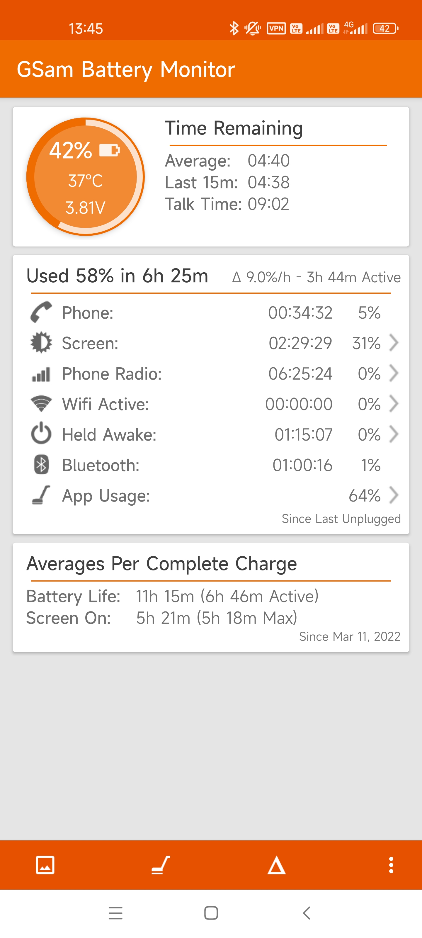

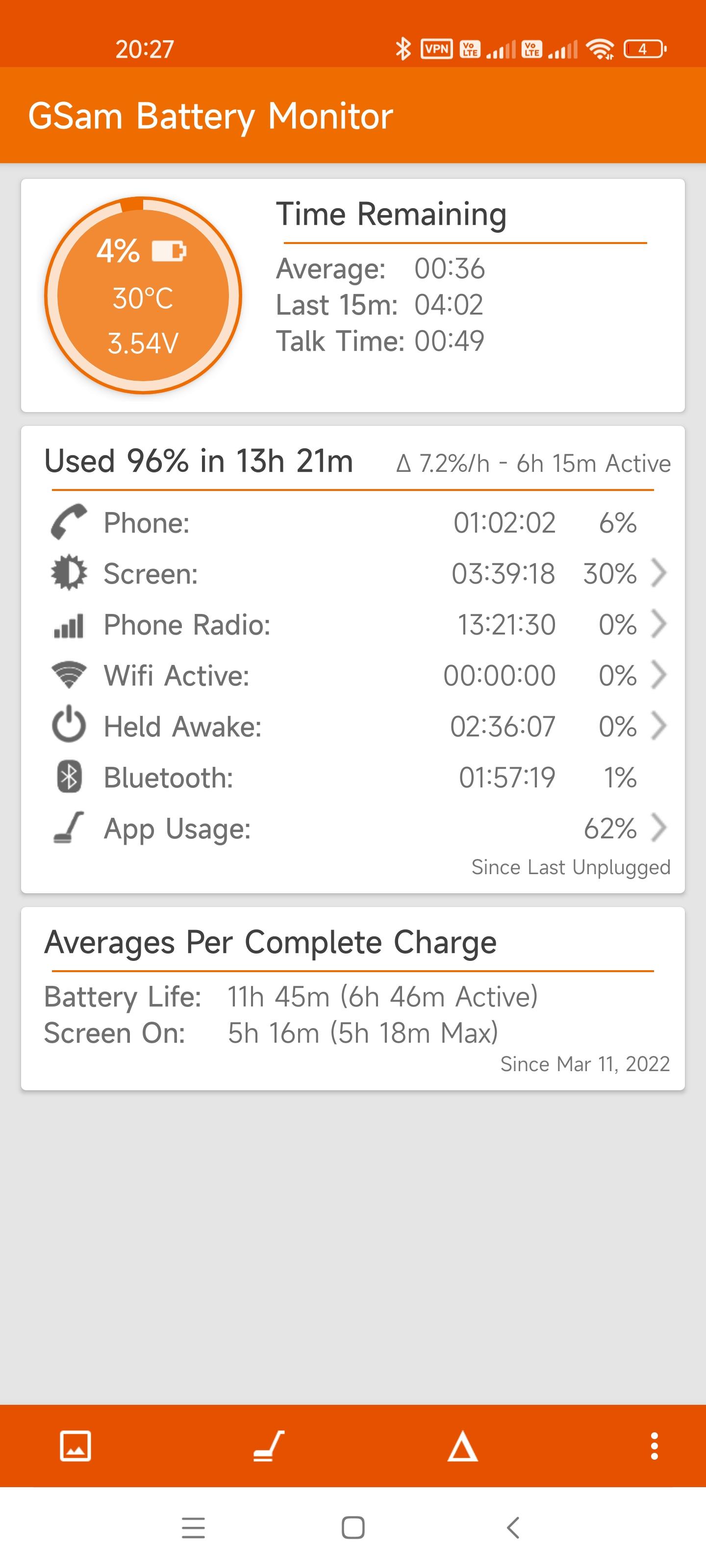

My battery drains very quickly and I do not thinks this is normal. I normally get 3.5 hours of SOT for 16 hours between charges and to me it seems kinda low. I don't know what to try anymore, I have a clean install of Miui13.
Please advise. Thank you!
Seems very high,
my Mi11 pro is still on stock ROM 12.5.20 and I'm measuring about 1%/h with screen off (AoD enabled) and about 10-12%/h with screen on
I would check carefully all running apps, some must be using a lot of power
