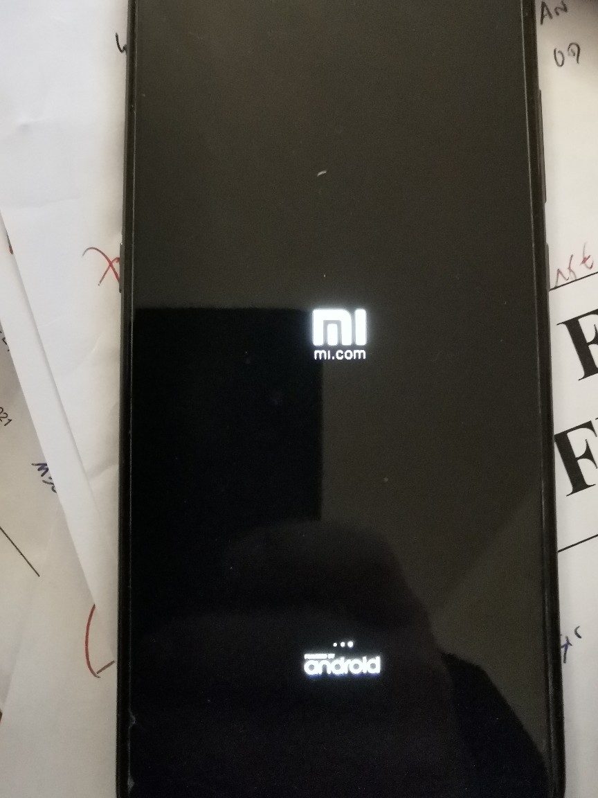

Hi there a friend of mine has her Mi9 stuck in boot loop... She see the Android icon loading with three points but nothing happen then... It is has it's stuck... For now she doesn't want to delete personal data she want to save a phone recording she had with her mum ((passed away)... It's seems I can start fastboot mode on her phone but I didn't try adb mode on pc... Do you think she can access to the phone and transfert data personal. Via adb and fastboot? Or maybe install recent update firmware and not loose her data? Please help

at point 2 : the logo Mi and the powered by android (with 3 points like downloading) are still visible...

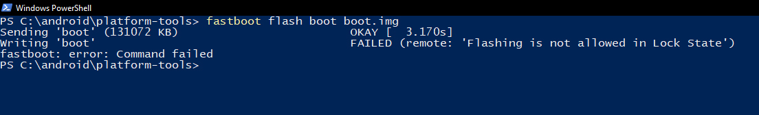

i just tried fastboot flash boot boot.img
failed writing
sending was ok but not writing ...see on the photo

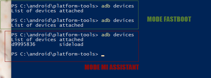

as i said if i start on miassistant mode the phone seems to be seen on adb when i type adb device
if it is in fastboot mode adb don't see it
Your Bootloader is not unlocked - so you cant flash the boot.img
Do you have installed the Xiaomi.eu rom from this site (CustomRom) or do you have the original Rom on your device ?
If you dont have installed the CustomRom and the Bootloader is locked we cant help
Then search in Telefgram for EDL / Unbrick / MIUI Authorized Acoount guys
PS:
ADB is ADB and Fastboot is Fastboot - you cant mix it
ADB -> adb.exe devices
Fastboot -> fastboot.exe devices
