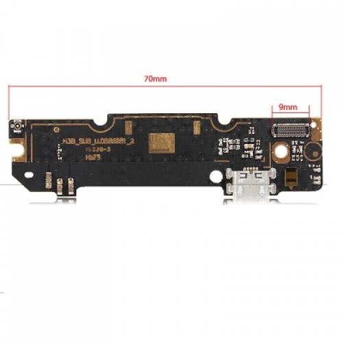

hi,Someone knows where I can buy a new usb dock for the rdn3 prime edition special on aliexpress I do not find the right model that is the "H3b_UB
LLDB867A3-1 I6378-6 HMFS " and as I have the charge at 1% is there a way to charge the battery without going through the usb
Thank you for all useful information.

There are two versions, 30pin and 24pin.
Thanks for your help, but this is not for the RN3P International Edition. :(
If we look at the picture posted by the OP, the board we need has 4 pins on the left side, while the Kenzo version - the one we can see in the link you posted - has only 3 pins.
@joaofrs , se conseguir encontrar a peça em qualquer lugar, me avise pois estou extremamente interessado. Gosto muito do celular e queria vê-lo funcionando novamente.
joaofrs, it is not the same of our smartphone. Compare the left side pins: ours have 4 and the one in that link has only 3. Compare the first picture posted by the OP and the picture showed in the link and you will notice the difference. :(

Thank you kuan. It works for me with the zener diode of the USB card removed.
The 2 zeners have code letters on it: "BD" = 6.2V, "BE" = 6.8V, "BF" = 7.5V.
(If someone wants and has the ability to replace them with new ones)
Removing both diodes not working. Phone still not charging. Redmi Note 3 Special edition. Any suggestions?
